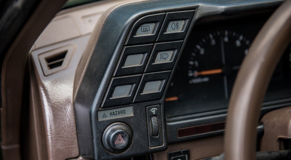

Just a picture I found on the Interwebs, These ones? I have the defroster there but nothing else. I'll see what I have left on my other dash and try and think of something. I figured it would be nice to have the extras for something in the future while still keeping the factory look.

Looks like this one had headlight washers! Was that ever offered in the US? Any guesses on what the button to the right of the defrost does?
Definitely factory fog lights.
don't think so.
dealer added foglights had the switch on the left of the dash on the bottom (next to where the choke lever would be) factory added foglights had it on the top next to the defroster switch,
so in other words, it's impossible to have every hole filled in and actually be properly functional, the factory thought about dealer added items and factory added items, 2 possible places for them on your dash just incase.
