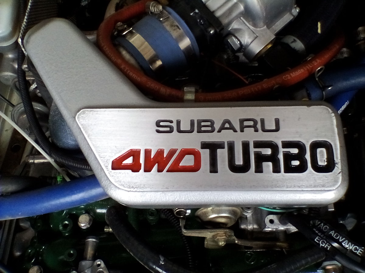

Pics speak words better, so here is my finished product done in Dulux MetalShield Hammered finish 300 gram spray tin - colour is Silver and looks so close to bare alloy until look closer.
Red is Humbrol model enamel gloss #220
Black is a left over gloss enamel by Solver made on 18SEP 1991
I think I most always prefer a satin / brushed finish to polished for these things so flat sanded with 600 then 400 wet and dry paper - only in dry form

Bloody schmick looking job on that alloy elbow Jono!!
Looks like it just came off the showroom floor!

This elbow provides zero charge cooling and due to being constructed of aluminum and where it sits on the engine, there is a very good chance that this may keep the intake charge warmer post-turbo than if it had been made of rubber or plastic.
Point taken Carfreak. I just figured it is getting hot with use so the heat is coming from somewhere. Given its rubber insulation at both ends it likely gets the heat from the inside therefore maybe some initial cooling but nothing after a certain point. No drop in boost pressure from one end to the other either.

Mine has 4wd in black...the red 4wd is sharp!
