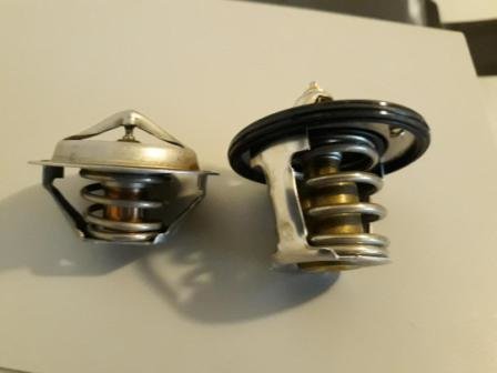

update -
thermostat. Changed it out to a factory spec unit (aka dealer) and problems went away. Amazing the difference in size from factory to "replacement" you get from a parts store. I'd be ashamed to call that a replacement part.
thanks for coming back and updating!
Glad it was an easy fix for you.
Dealer stat is on the right. OTC "replacement" is on the left
