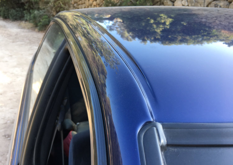

Our Legacy is sleek, is smooth, has great paint, but no way to fit a roof rack unless its the rapidly-disappearing type that hooks over the window rain gutter strip, probably fouling the frameless glass as you open and close doors.
I hanker for rails, like our old Forester has, and then I can pick and choose from a wealth of roof bars.
Has anyone done a retro fit of some rails? I am happy to cut down some cheap rails from the scrapyard, but I need a good permanent fit and not buckle/ruin my pristine 22 year old roof. Leaking is not an option...
I realise I must drill to install. So perfect.....

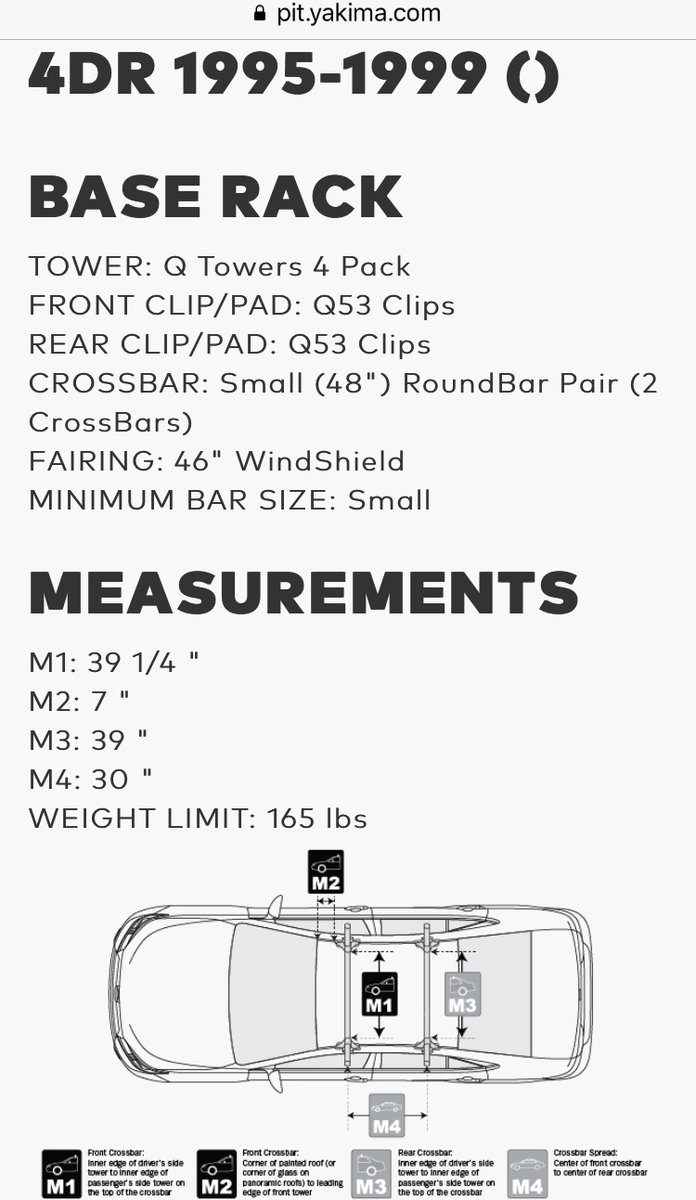

Just found this on their website. Very helpful, even if some of it is discontinued.
At least I know what I would need if I went this route:
Unfortunately all the Yakima gear (2nd hand at least) comes from the USA, so it would cost more than double with postage and import duty.
Back to the drawing board....
