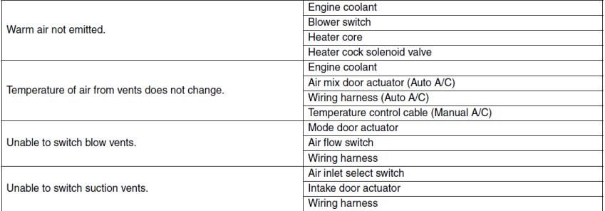

December 31, 20205 yr Probably best to be familiar with the diagnostic mode of the Auto A/C, so some tests can be run when it's acting up.
