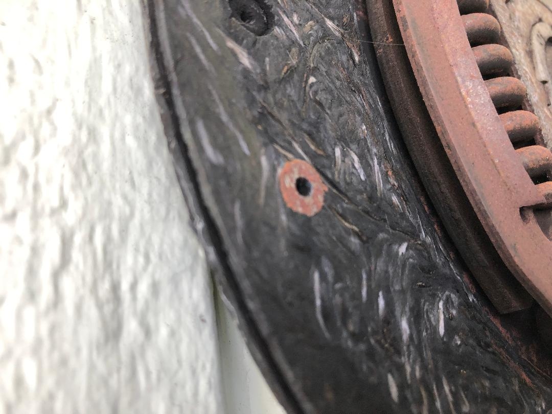

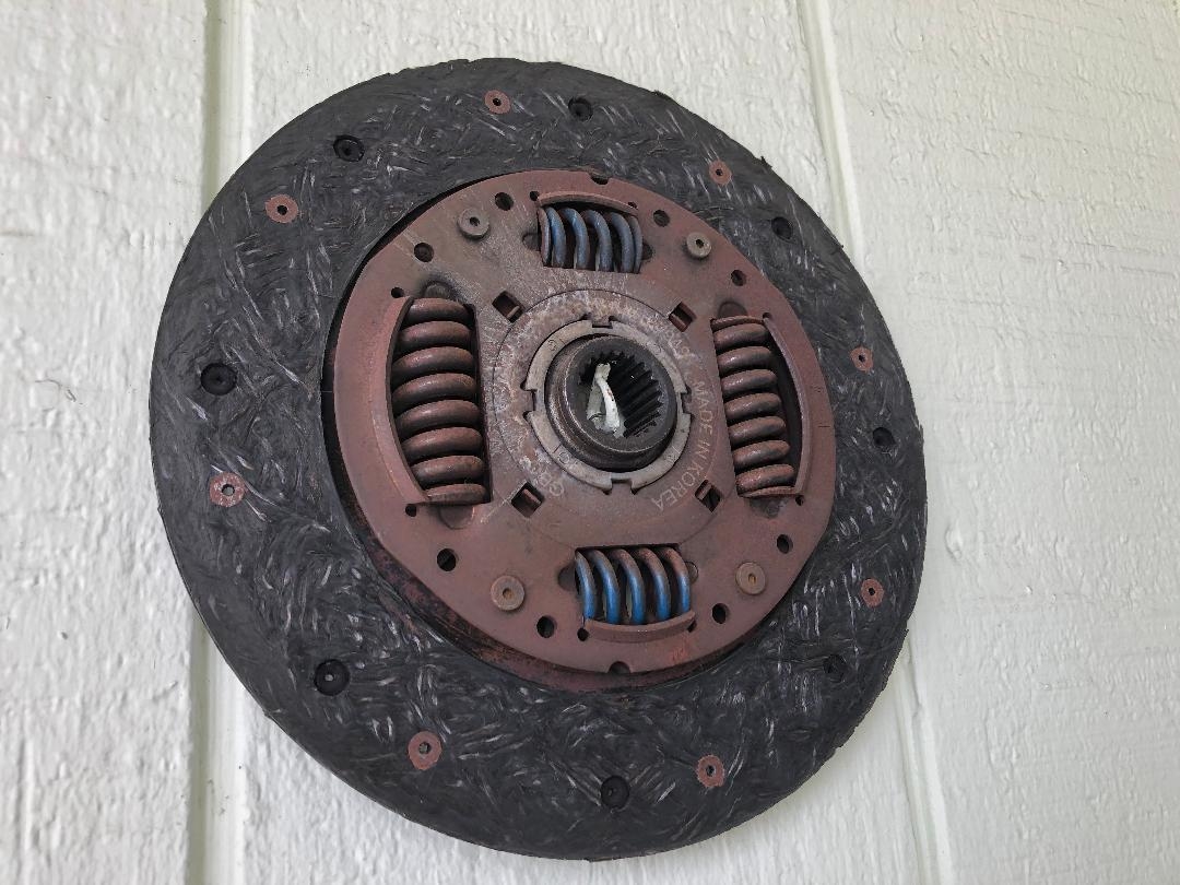

In December 2019 I replaced my 2000 Legacy wagon's clutch with the M-PACT 15004 clutch kit from RockAuto.  The old one was slipping hard and had worn the disc down to the metal rivets.  On the new clutch, I believe I recently detected a tiny amount of slippage during hard acceleration in 1st or second gear, and suspect I'll need to replace the friction disc again later this year, which means I'll have gotten about 2 years out of it.
It's not surprising, and I don't necessarily blame the quality of the part other than having basic performance.  My Legacy carries a heavy load of tools and parts at all times, roughly 400-500 lbs
.  This has led to me burning the disc at least a dozen times since replacing it, usually when reversing uphill after parallel parking on crowded streets.  The Legacy just can't take it when carrying a heavy load.  I've since learned to be wary of neighborhoods built on steep hills.  I never park my Legacy anywhere that would force me to reverse up anything more than a very mild incline so I don't burn the clutch.  I also have a somewhat aggressive driving style in urban city streets, and sometimes need to rely on hard acceleration to get me past obstacles in dynamic traffic situations.
I need a recommendation for a strong replacement clutch disc that will put up with the heavy load I regularly carry and hard acceleration in lower gears. I don't suspect that I need to replace any of the other parts since they were replaced in the past 2 years, just the disc, although I'm intrigued by some of the clutch kits which include a replacement flywheel.
The standard M-PACT friction disc would probably be fine for a person who drives normally in car that isn't loaded down, but I'd rather avoid replacing my clutch disc every 2 years.  I'd like one that could last me a good 5 years if possible.
The current OEM dealership part is Subaru part # 30100AA851, going for $180 dollars.  Based on what I saw in the forum search for clutch info, I'm guessing this one is produced for Subaru by Exedy, It appears identical to the Exedy FD501D Stage 1 organic clutch disc, currently out of stock at RockAuto but on Amazon for $135.
Another option is the EXEDY FJD016CB Stage 2 cerametallic clutch disc,  ranging from about $350 online.  Steep but I'd pay it if it performed like a $350 clutch disc.
On Amazon I see six-puck racing clutches by ClutchXperts advertised as Stage 4 and Stage 5 clutch discs made of copper-ceramic Miba.  They are only $55 and $62 respectively, which makes them very attractive, but I don't see a single review for any of them.
Anyone have an opinion on these options?  Any better options I missed?  I might just preemptively throw a new clutch disc in next month if the promise of improved performance is tempting enough.  The pics are of the old clutch, which I mounted to the wall outside after replacing it last.
