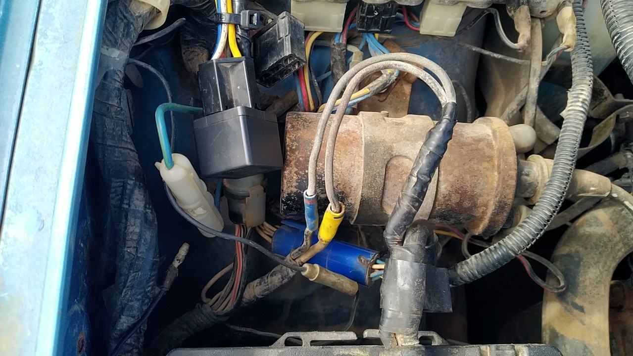

July 25, 20214 yr Hey guys and gals, Im a new time member with a new-to-me 1981 DL 1800 Station Wagon 4WD. And I am having issues getting my wipers, radio, A/C, and radiator fans to work. A previous owner Jerry rigged a wire to bypass the temp sensor on the radiator and also Jerry rigged a relay where the three Fused wires go. My question is: does anyone have pictures of a stock fused wire area in the engine bay? I looked on the digital service manual that was provided on this forum...but a ton of electrical pages are missing/corrupt. I just need a reference to what is stock and possibly fix these issues. Also, I have a fuse that keeps blowing....from the wires (blue and blue/red?) they look like the A/C fuse. Any help would be super appreciated! I will attach pictures later when I get better lighting.
July 25, 20214 yr Photos of what you have going on with the wiring would be very helpful. Don't have any photos on-hand of my own to show at the moment... Do you have a Haynes Manual? Would recommend volume 681 for 1980-1988 Subaru 1600 & 1800

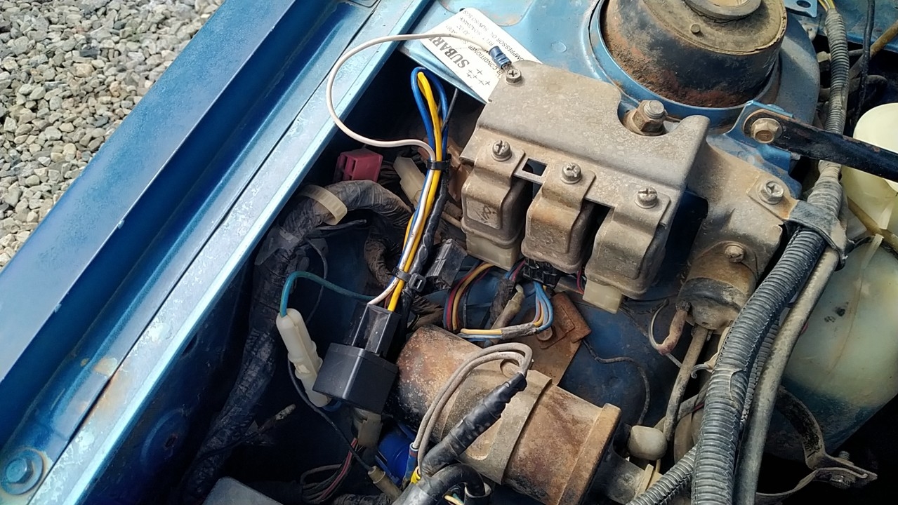

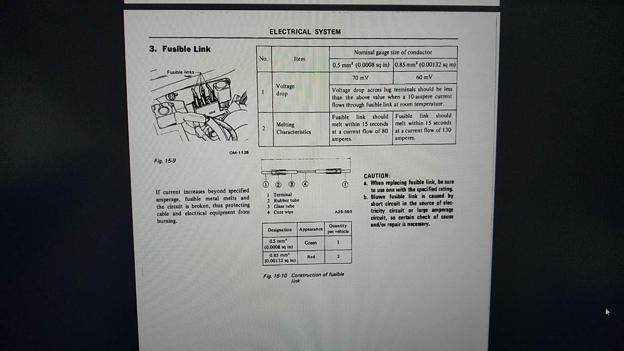

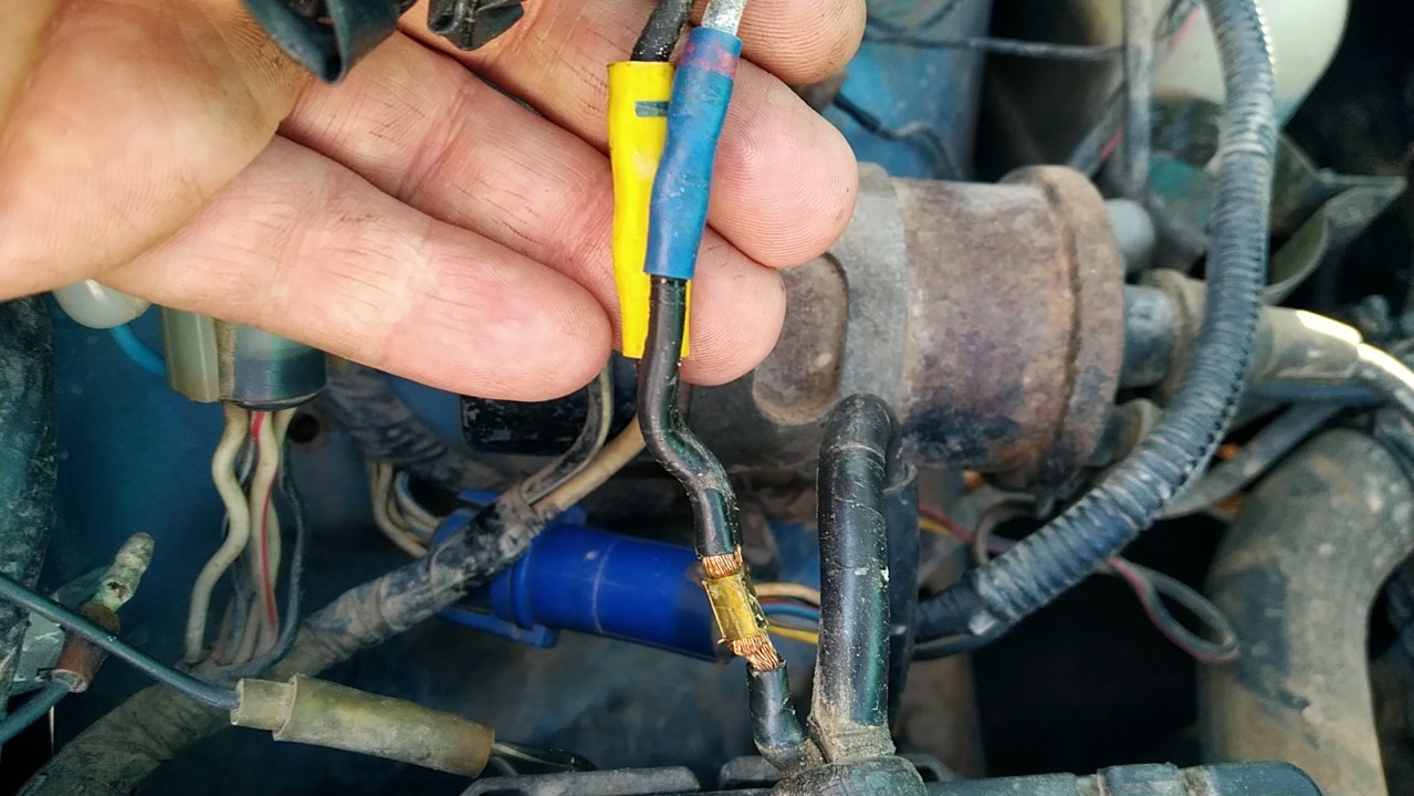

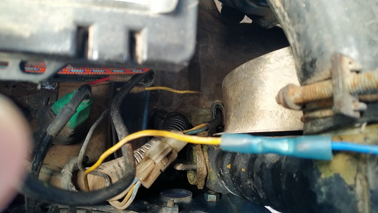

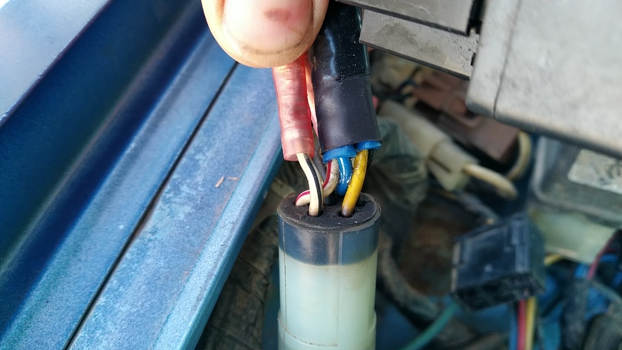

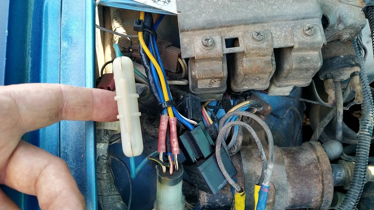

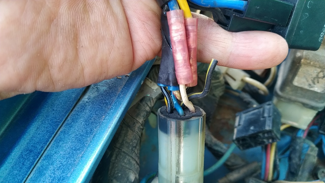

July 26, 20214 yr Author The first image is the bypass for the temp sensor on the radiator. The wires go all the way to the dash and terminate at a toggle switch. The other pictures are of the wiring job someone did, I have no idea where these wires went originally. And the screen shot is of the fusible wires....I don't have that whole assembly and I'm missing a third wire( which I believe is fuse holder next to the relay on the third picture) Edited July 26, 20214 yr by OldieSubie photos
July 27, 20214 yr The first pic: yellow wire connects to the thermo switch down lower, also with a yellow wire by the looks of things. The battery pics seem to be a dangerous non-fused bypass of the fusible links for the main power. Those two wires (both grey from battery with blue and yellow connectors to the factory wiring) should go to a brown box with two or three fusible links (two for the EA81 DL wagon and brumby/brat from memory). These are designed to burn out before something causes an electrical fire in the wiring loom. Worth replacing back to factory or adapting newer style fuses of the correct rating instead. Those issues seem quite minor once you have your head around them and how you’ll go about fixing them. The thermo fan trigger switch should kick in once the engine temp shows a little over half on the gauge. The toggle switch will just go to earth. You could keep both systems in place so you have an override if you feel the need when sitting in traffic Cheers Bennie
July 27, 20214 yr Author Hey el_freddo, Thanks for the reply! Do you have a picture of what the factory setup should be? I'm half tempted to redo the whole positive power cable up the fusible wires. I'll have to take off the electrical tape and see if there was a third wire there before. Also, the diagram in the service manual doesn't show the white/gray 7-pin connector...only the blue 7-pin connector is present. Is it because the service manual is for an 83? None of the fans go on even if I have the fan switch grounded. I suspect the fuse holder with the blue wires is causing everything to not work, which makes me believe that it was a fusible wire at one point( when I stuck a 20amp fuse in, the AC blower fan turned on until the fuse blew).
July 27, 20214 yr The blue/grey plug, are you talking about the circular plug for the engine wiring loom? That looks intact and fine to me. That black relay taped to the circular plug is not factory. You’ll have to trace those wires to find out where they go. It could be a relay for the fan(s) or it could be for some driving lights. As for the fusible link box, I can’t find an image with it in there and definitely can’t find one of the wiring setup in it either. This is the best I can come up with to show the brown box for the fusible links: You can see it tucked in behind the battery and hemmed in from the side with the coil. There will be quite a lot of wire tracing (label everything if it helps you) in your future at this point in time. Cheers Bennie

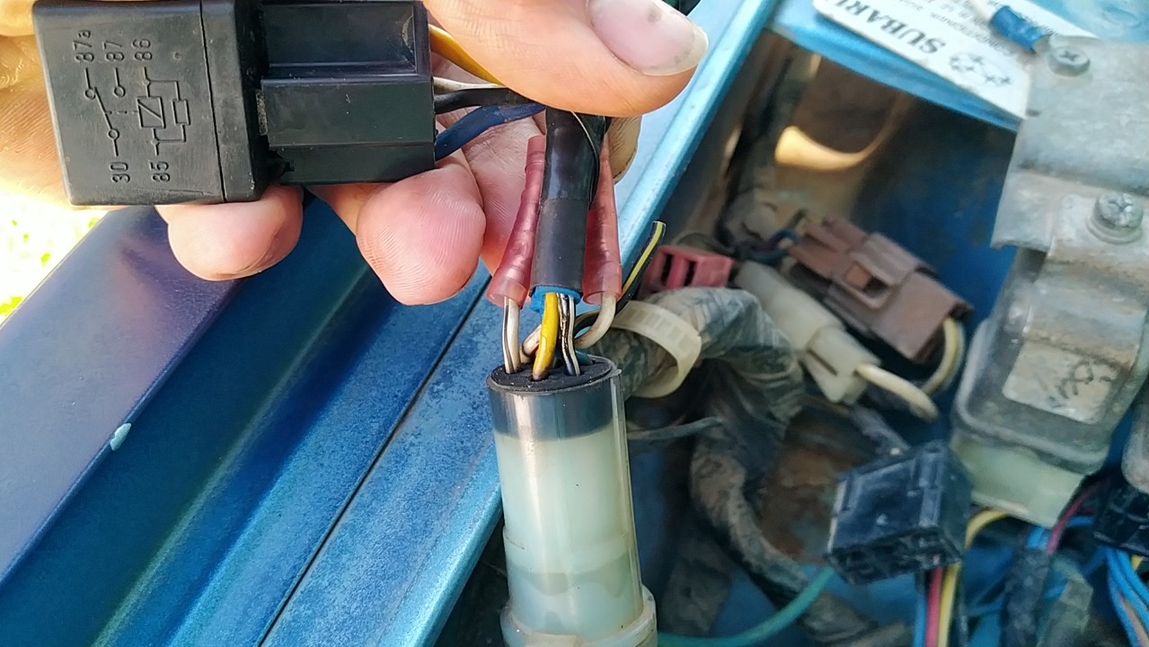

July 27, 20214 yr Author The blue 7 pin connector is good. The gray 7 pin connector that the new relay is attached to, had all of its wires cut and four of them are crimped together and feed into one wire leading to the relay. One wire (black/yellow) isn't attached to anything. I'll get a closer picture of it. I know the fuel pump works off it because if I wiggle the wires, the pump will lose power. I just don't see anywhere that these wires would've terminated. And thank you for showing me the picture!

July 28, 20214 yr You need to try and meet up with someone who has a Subi of the same era without the butchered wiring to cross reference. That tube fuse holder with the blue wire is a factory unit. Bugger it, I just ducked outside and grabbed these pics from my Brumby: Looking at your pics, it seems that someone has added that second circular plug. As per my pics mine is one side white and the other side blue - I had an inkling this was the case but didn’t want to give you a bum steer. I also wonder what those plugs further up the line are for - the pink one caught my attention as I don’t have any of them there, just neatly wrapped wiring. It’s either a LHD vs RHD difference OR someone may have attempted to splice two loom sections into one for some unknown reason. You might have to pull all the wires from that relay, record their colours and what they do - that will require some investigative work - but it would give us the best way to work out how everything is laid out in a factory wired vehicle by comparing what I and others have with their EA81’s. That’ll give you something to work on for now though! Cheers Bennie
