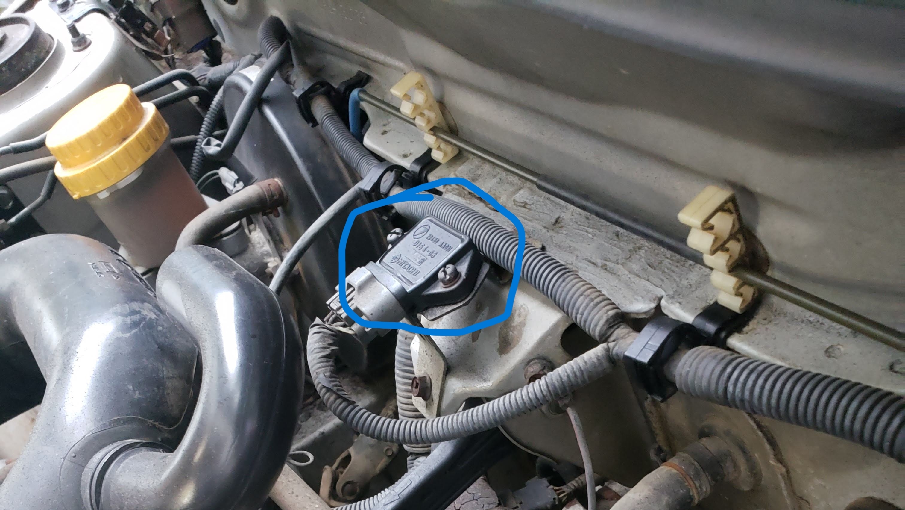

Btcox Posted May 12, 2022 Share Posted May 12, 2022 I have a 1995 Subaru Impreza HX Edition S (I'm aware that isn't a valid US model) visually similar to a sport wagon. This is a JDM Subaru so parts have not been easy to find for it due to me not knowing what US model it is considered. It is a right-hand drive vehicle, EJ18. The problem I'm running into is that when outside temp is hot/warm the car begins to bog or hesitate when accelerating. Never had this issue in the winter or fall. The warmer it got outside the worse the problem was. Idles fine and drives great in the morning when it's cooler but right at noon when the sun is blazing is when it starts acting up. This is my wife's vehicle, she is a postal driver so it's being driven for many hours each day. It seems that attempting to go uphill is when it acts up the worst once it's hot. I'm unsure what I need to do to fix this problem. Any help would be greatly appreciated. Here is the list of parts I've already replaced: New Oil Pan Gasket New Rear Main Seal New Oil Separator Plate and Seal New Radiator New Coolant Temp Sensor New Coolant Gauge Sensor New Spark Plugs New Ignition Coil Wires New Ignition Coil New Fuel Pump New Fuel Filter and Sock New Air Filter New Harmonic Balancer New Serpentine Belts New o2 Sensor and Bung New Alternator Added 2 transmission Coolers Quote Link to comment Share on other sites More sharing options...

heartless Posted May 13, 2022 Share Posted May 13, 2022 ok, 95 is still probably the single wire connectors under the dash... OBDII was not mandated until 96 here in the states.. not sure about elsewhere.. altho, my 95 Legacy had OBDII... so yeah.. kind of a weird year for that. anyway, under the dash there should be two sets of test connectors, one set of green and a set of black.. both single wire - if they have never been used, they may still be taped up in the main harness bundle.. they should NOT be connected for normal operation. you will need to do a bit of research cause I forget which set does what at this point (been a long time since i played with these) Quote Link to comment Share on other sites More sharing options...

Btcox Posted May 14, 2022 Author Share Posted May 14, 2022 On 5/13/2022 at 5:28 AM, heartless said: you will need to do a bit of research cause I forget which set does what at this point (been a long time since i played with these) After research, Black to black plug pulls stored engine codes. I connected these and received a code 24 Reset ECU and waiting to see if the code comes back 22 hours ago, 1 Lucky Texan said: yep, you might get a blink-code. check trublecodes.net - perhaps JDM uses the same definitions for the codes? According to that website, code 24 is "Air control valve or circuit; Idle speed control solenoid valve" Is this referring to the MAF sensor or the IAC solenoid valve, or both? 1 Quote Link to comment Share on other sites More sharing options...

el_freddo Posted June 7, 2022 Share Posted June 7, 2022 (edited) Don’t replace your injectors. Your issue is either a dying fuel pump or the ignition module on the firewall is getting too hot. More likely your fuel pump is dying, although when mine died under high temp conditions (<30km/h driving in sand during the warmer months, fine at cruise and around town), the engine would stall out and be a PITA to restart immediately - at which point it would stall out again shortly after. The other thing you could check is power at the main relays. Hook up a multi metre to watch when the issue shows up. If the voltage is jumping with the engine revs there’s an issue with the relays. Same for the ecu power. The reason why I’m suggesting the power issue is because of the way the rev counter jolts you and down - as if power is suddenly cut then reinstated in a repetitive cycle. I’m guessing this issue just keeps going on and on? At what point does the car “snap out” of this behaviour? Cheers Bennie Edit: as for parts, the engine and gearbox are phase 1 gear. Basically the same as the EJ22 legacy. The engine sensors etc are interchangeable. Someone will correct me on the specifics of what’s different but essentially they’re all the same. You might be able to find a FSM from Japan or Australia as we got the impreza from the first model in 1993 or 1994 (I’m not sure which year the impreza started). Edited June 7, 2022 by el_freddo Quote Link to comment Share on other sites More sharing options...
Btcox Posted June 7, 2022 Author Share Posted June 7, 2022 14 hours ago, el_freddo said: Don’t replace your injectors. Your issue is either a dying fuel pump or the ignition module on the firewall is getting too hot. More likely your fuel pump is dying, although when mine died under high temp conditions (<30km/h driving in sand during the warmer months, fine at cruise and around town), the engine would stall out and be a PITA to restart immediately - at which point it would stall out again shortly after. The other thing you could check is power at the main relays. Hook up a multi metre to watch when the issue shows up. If the voltage is jumping with the engine revs there’s an issue with the relays. Same for the ecu power. The reason why I’m suggesting the power issue is because of the way the rev counter jolts you and down - as if power is suddenly cut then reinstated in a repetitive cycle. I’m guessing this issue just keeps going on and on? At what point does the car “snap out” of this behaviour? Cheers Bennie Edit: as for parts, the engine and gearbox are phase 1 gear. Basically the same as the EJ22 legacy. The engine sensors etc are interchangeable. Someone will correct me on the specifics of what’s different but essentially they’re all the same. You might be able to find a FSM from Japan or Australia as we got the impreza from the first model in 1993 or 1994 (I’m not sure which year the impreza started). Thanks for the info! After the issue starts it does not stop until the car has cooled down. The typical quick fix is to pull over, turn off engine, and wait for it to cool down, then start up again and drive for a few minutes until it does it again. The problem does not occur at engine operating temp but is weather/heat related somehow, typically when it's over 80 degrees Fahrenheit on a hot sunny day. The hotter outside, the worse it gets, typically under a heavy load (accelerating or going up hill). No check engine light has ever come on. So, the fuel pump has been replaced already but I have not replaced the ignition module. I'm attaching a picture to make sure I'm thinking of the correct part you are talking about Quote Link to comment Share on other sites More sharing options...
azdave Posted June 7, 2022 Share Posted June 7, 2022 Do you have a can of Dust Off? The contents are R152a which is a great refrigerant. If you think it might be the ignition module (which could fail in the heat as you describe) then invert the can and spray several short spurts to cool off the part and then see if you can drive much further before the failure returns. Even cooling it with a handful of ice might prove or disprove this theory. My 87 Mazda B2000 had an ignition module fail in this same manner and an Icee slush drink from the convenience store got me home. Cherry flavor works best. 1 Quote Link to comment Share on other sites More sharing options...
