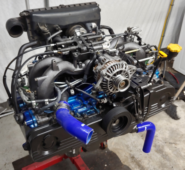

fuelforwar Posted August 8, 2023 Share Posted August 8, 2023 Hey everyone. Been searching without much luck for some info on an 02 sensor problem. As a little back story, I spent a year rebuilding a 2001 impreza wagon L with the ej222. After having it back on the road I was in an accident that totalled the vehicle. A couple years later my neighbor made a deal with me and gave me a 2002 bug eyed impreza that had a blown ej251. I swapped in the ej222 as a complete unit (didn't swap intakes or anything), swapped the computer, and the exhaust. Engine starts right up but I got multiple codes for the 02 sensors. Swapped both of them out but continue to keep getting P1132, P1133, and P1139. I've inspected the wiring and it seems to be fine. With a test light I'm getting power to the plug that feeds the 02 sensors. I noticed the 02 sensors are different between the two vehicles. On my 01 it was a 4 pin, and on the 02 it's a 6 pin, but the 02 sensor only has 5 wires. Do I need to repin the plug or change out the wiring to my sensors? Been struggling to find the right diagrams that matches my wire colors. Any help or input would be greatly appreciated. Thanks Quote Link to comment Share on other sites More sharing options...

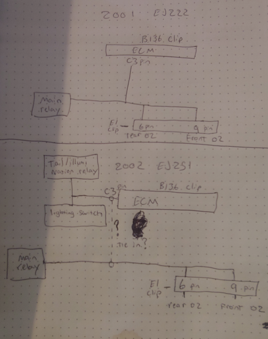

fuelforwar Posted August 24, 2023 Author Share Posted August 24, 2023 So I made a little head way on figuring this out. Tracing all the pins back from the e1 clip to the ecm, there's only one difference between the ej222 and ej251. The #9 pin on the ej22 bridges with the #6 pin, ties into the c3 pin at the ecm, and the whole branch is fed from the main relay. The #9 pin on the ej25 bridges with the #6 pin and is fed directly from the main relay. It doesn't tie in to the c3 pin at all. On the ej25 loom the c3 pin ties into the tail/illumini nation relay and a lighting switch. I'm trying to figure out if I can just tie in a wire between these, or if it would cause a problem with the other system attached. I can't imagine having two positives crossing would be a good idea. Trying to figure out the best way to do this. I drew up a rough sketch to try to illustrate this. If the voltage is the same and consistent it might be fine, but I'm not sure exactly the function of what the c3 pin does/needs. I did pull the sub harness and tested all wires for shorts/breaks. Everything is fine on it. I'm going to test the loom from the e1 plug to the ecm next in case I'm missing anything else. Quote Link to comment Share on other sites More sharing options...
fuelforwar Posted August 24, 2023 Author Share Posted August 24, 2023 The only other thing I can think of would be the ej25 o2 sensors just read different than the ej22 sensors. If that's the case I'll need to hunt down the right o2 subharness and order new sensors. Quote Link to comment Share on other sites More sharing options...
idosubaru Posted August 25, 2023 Share Posted August 25, 2023 Don't know. The O2 isn't used by any other system in those older vehiclse (like the AT, there's no dynamic control, cluster, etc) and the rear O2 isn't used for fuel trims until 2005 so that should be really simple. It just gets scrubbed to see if the CEL needs triggered. so that should be a simple input, no cross wiring necessary. Of course you'd want it properly powered/grounded/relay/fuse protected and powered at the proper time however Subaru does it. But it shouldn't need to be shared with any other wiring. I'd expect the front to be the same in a 2001 as well - it's a fairly simple O2 and ECU so you should be able to just give it power/ground and pin the input signal to whichever ECU pin needs that signal. But I'm just guessing and dislike messing with ECU's/wiring diagrams despite repinning a 2012 Outback connector right now and being a Flight Software Engineer lmao. Keep in mind - just in case the wiring turns out to be more complex then initially assumed - I'd still install an EJ25 ECU and oxygen sensor and avoid the wiring. ECU's are available for $25. Quote Link to comment Share on other sites More sharing options...
