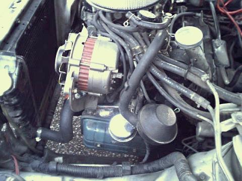

August 30, 200322 yr I basically did this. bought a 4" deep dish chrome cleaner kit. modified the bottom piece by taking the top lip off. Used the 2 5/8 to 2 5/16 spacer. bought a 9" chrome air filter assembly, with the 2 5/8" adapter. Used the bottom part of the 9" chrome cleaner upside down. Put the spacer/adapter under it. Now the problem, the difference between the spacer/adapter and the neck of the carb is 5/16. So, use the adapter and the bottom part of the modified 4" cleaner to hold it in place. So it's all snug. It's an interesting thing, so you really need to see it in person. The valve covers have breathers on them, the air pump to the second cat has an identical breather, and my crankcase breather needs one like it... but I haven't had the money for a $22 cleaner for it. (specially made for the smaller tubing) When the secondary valve opens, you can hear it sucking air. It's sweet. Now the engine breathes alot better. That with the electrical things I've done (coil, wires, cap, rotor) and the performance muffler (see picture) have all helped to put my'88 EA81 N/A carbed engine a little bit faster. With the tires I've put on the car (the cheapest 175/70/R13 tires I could buy) I can chirp the tires in every gear, really peel out in first and a little bit in second if I let off the clutch just right. FWD.
