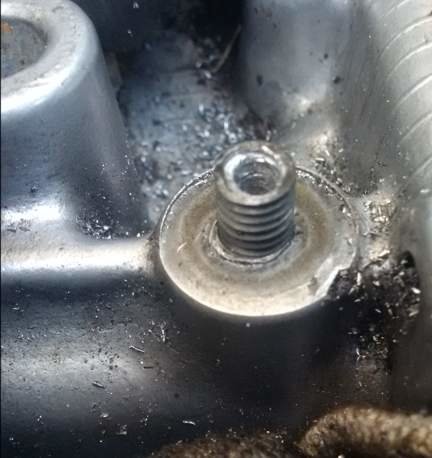

Here was my broken AC mount bolt   https://www.ultimatesubaru.org/forum/topic/168114-ea82-one-broken-off-bolt-in-top-of-head-that-ac-mounts-onto-is-it-important/
1st Liquid wench, then followed suggestion here & got left handed drills, drilled a small hole about 1/2 inch deep - but the next one LH in the $12 set was too big so got a right handed drill 2 sizes larger and cocked drill motor to the right to compensate for previous hole being a little too far to the right - started slow and "all the sudden it looked like bolt HAD GONE IN FURTHER -about 1 turn.. stopped & got a steak knife, stuck it in my now chamfered looking hole, twisted CCW and it backed out!

Great.  Not surprising it was easy, those bolts dont see enough moisture/road chemicals normally to get that rusty or propagate deeply. Nothing like the Intake manifold bolts are capable of on that engine.   The heat from drilling was enough to loosen the minor corrosion.
EZ outs are worthless for DIY auto work.  If a fastener can come out with an EZ out, it will come out with some other less risky and more advantageous method.
EZ outs are excellent tools in highly controlled, precise, and curated machine shop type settings, but they’re trash in a shop that sees real live, on the road, significant corrosion in the middle of a job. EZ outs simply don’t work at all in rust prone areas / you need LH bits and heat.
