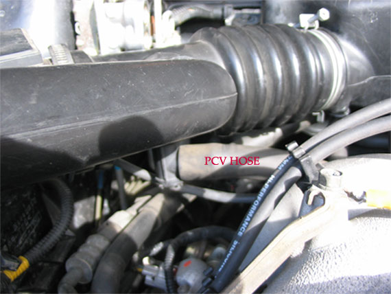

tcspeer Posted August 26, 2006 Share Posted August 26, 2006 Check and make sure the big vacum line that goes to the Idle air control valve is connected. You will find one end under the air filter tube. Hey sorry to bother you again but I was wondering what you meant by this "The CEL should always be on if the car is not running but switch is on. Still wouldn't hurt to check the codes, though." Is there a certain code I should be aware of electrically? Quote Link to comment Share on other sites More sharing options...

tcspeer Posted August 27, 2006 Share Posted August 27, 2006 At the back off the engine near the center at the top their is a black box, it has an accordian looking thing running to the air filter box under this accordian looking thing near the center is a place for a hose about 1/2 or 5/8 to push on to, no clamps on it. From here it runs down toward the center of engine if one end is off, the car will start and then die just like you say yours is doing. At least this is the way my Legacy is set up maybe your car is close to the same. ok cool. I went out last night and checked but due to lack of knowledge and it getting dark I was unable to find any loose hoses. However I am going back out to the car now to go and check for that again! Hopefully I will have better luck. Part of the problem is that I lack all kinds of knowledge for example, I dont know what the throttle body is or where to look for it. I tried to look around the air box but im not 100% sure that is correct. Nonetheless I did not see any loose hose. I will post my results. Thanks again everyone!!! Quote Link to comment Share on other sites More sharing options...
tcspeer Posted August 27, 2006 Share Posted August 27, 2006 If you can keep the car running by keeping gas pedal pushed, this may not be the problem because when the line is off on mine it willl ussualy die anyway. I would then spray some carb. cleaner in that line or clean the Idle air control valve. You can do a search on idle air control valve and find out how to clean it. Quote Link to comment Share on other sites More sharing options...
Lawsonmh15 Posted August 27, 2006 Share Posted August 27, 2006 At the back off the engine near the center at the top their is a black box, it has an accordian looking thing running to the air filter box under this accordian looking thing near the center is a place for a hose about 1/2 or 5/8 to push on to, no clamps on it. From here it runs down toward the center of engine if one end is off, the car will start and then die just like you say yours is doing. At least this is the way my Legacy is set up maybe your car is close to the same. Attached is a picture of the hose which TC is referring too. The hose in question is the one with the text on it. Also, make sure that the airbox is properly seated. 90% of the time I have to re-do it when someone else removes the top. The best way to do it is to loosen the clamp and remove the hose where it meets the airbox in line with the Intake. Then you have the freedom to seat it easily, without putting alot of stress on the attached components. BTW, this HAS to be a vacuum issue. Quote Link to comment Share on other sites More sharing options...
kukliani Posted August 27, 2006 Author Share Posted August 27, 2006 Thanks again for all your continued support however I just came back from checking the hoses and everything seems to be in order in that department. I noticed though when I did try to start the car and gave it gas, I gradually let my foot off the gas and the car idled by itself at like 200rpm and it shook pretty badly however I let it run like that for about 5 minutes before I shut it off! Is there a possibility that it is still a hose problem? Quote Link to comment Share on other sites More sharing options...
