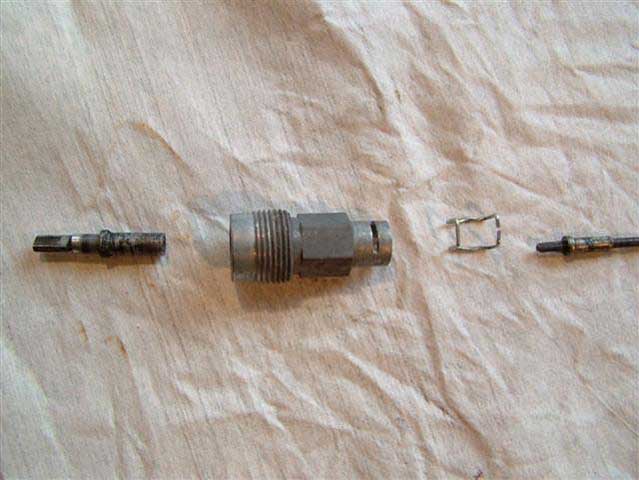

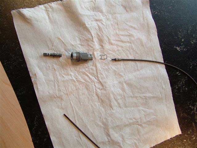

After resetting it does not show any code anymore so seems fine. What i have done in total is:
  1. Locate speedo cable mount on differential house (automatic) and remove the black rubber cover by pushing it upwards.
  2. Undo the bolt with 17mm key, then drive it out by hand, its very loose.
  3. Lift up the bolt and pull out the small pin with square head. Then undo the clip on the outer tube and take of the whole bolt by gently pulling it out.
  4. Now the hose is free and can be pullud out gently as well.
  5. Clean all parts with cloth (this graphite grease stains very badly).
  6. For regreasing the cable you can either take a graphite spray or graphite powder (i could only get powder). For spray i guess spray it on. For powder: Put some powder in the palm of your hand (better to wear latex gloves or something) put the cable on it and close your hand, now rotating and slow pulling the cable will spread the graphite powder nicely. Put at the tip of the cable some thick acid-free fat, like vaseline.
  7. Put the cable back in the outer tube and put some more graphite on it whilst putting it in.
  8. For the pin its important that the round part is clean, put some graphit on it and a drop of oil (just a very very little drop). Put some graphit in its housing and push it in. Mount the thing to the outer hose and apply the clip. (remember how the clip came of, i forgot it, the longer retangular parts go into the groof on the top end of the bolt)
  9. Place the bolt back onto differtial and turn it back in using hands only. At the moment it becomes harder to turn, put the car in Neutral and push it a bit back and forward (to get the square part of the pin back in to the right position).
  10. Now use the key to thight it, thight is thight, dont overturn it.
