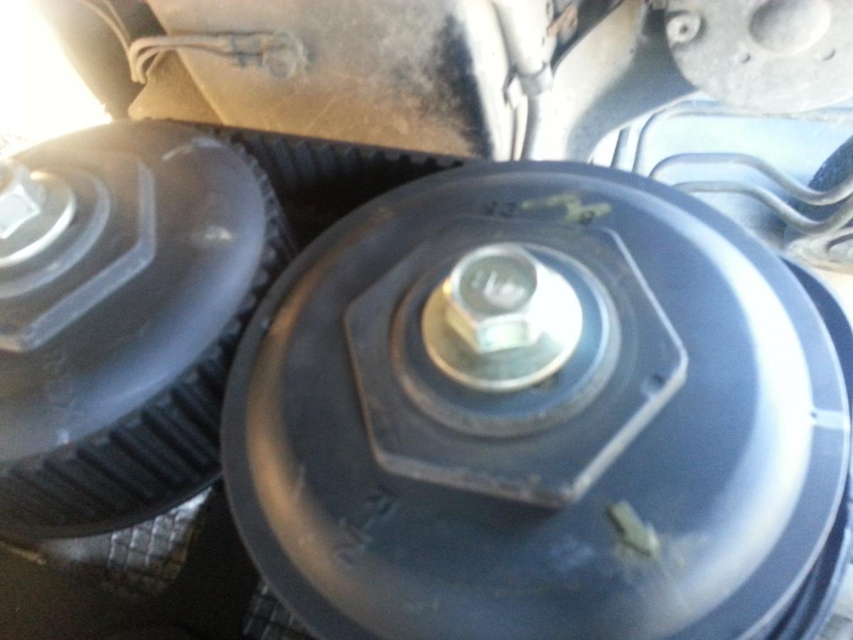

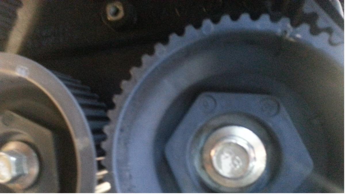

I'm checking the timing double again. the pics i added, the passenger side(rounded front cams) the notches are lined up on the top cam(right side of the pic) the bottom cam is not in line. i'll turn the crank a few times and re align it before I start pulling the timing off. i'm going to reuse the current belt to test the timing after double checking the timing. then i'll fire it up.
the front seal is also getting replaced, its like $11 from autozone so i'll probably pick that up monday. should i look at an Oil pump gasket? there are a couple bolts missing from the central timing belt cover. going to take one up with me and get some replacements. I really don't want to skimp on TB i understand how important it is.
The engine i have lined up is the link to craigslist above a few posts. Its got relatively new timing w/ pump, tires, brakes, and a few others. its a steal for $400.
I'm probably going to make them get Belt, Toothed Idler, and a Tensioner. they're fixing my car since moms will take time to get done(burnt valve, v8 triton, 98 Expidition) how will i know if the valves are bent? i'm assuming some kind of noise.
Two things:
1) Are you absolutely POSITIVE that the Impreza engine is the same? I ask because a '97 Impreza would have had an EJ18 or EJ22 in it, UNLESS the engine was swapped.  http://www.cars101.com/impreza_archive97_98.html#1997%20impreza
Definitely not the same as the EJ25 in your Outback.  It is "swappable", but you'll need a single port exhaust header, not the dual port the EJ25 has.
2)  I wonder why nobody ever mentions this:  ONLY rotate an interference engine clockwise (as seen from the front position).  Rotating the engine backward will cause it to jump time.  FYI.
Emily
you bring up a great point. I tried to search his VIN but it was invalid. I'm wanting to go look at it but i haven't had the spare time. regardless i may not need it. and the timing will fix my car. I did ask about the Impreza earlier in the thread but no one responded about it. thank you for the info =]
I have looked at Timing stuff and i will not disagree, however the guy in the vid does state only counter clockwise the driverside bottom cam IF its within 90 degrees.
pulled the car apart today. got the timing reset. went over the marks multiple times. battery is shot won't hold a charge that will turn the motor. So i had to bust out the Jumper cables and jump it. It fires up, runs for a moment then dies. on start up i can here a "knocking"? I'm hoping thats just the engine trying to lube itself after sitting so long. That's what it sounds like almost anyways. Going to do some more with it tomorrow and maybe pull the timing cover off again and check the timing again. I checked it to make sure the timing was right after i set it. Cyl 1 & 3 Intake Cam was what had jumped. everything else was in time.
