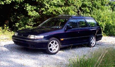

That's right folks -I just aquired a 94 Legacy GT wagon. "Dark side" as it's dark blue metalic.
Don't know bout all this, first venture into the land of the "new and improved" sure wish it was a turbo but tis good for getting my feet wet so to speak.
Has some issues and some crash rash but the price was right and the potential is there so --
I took the plunge.

It turns out to be a GT touring wagon, has the raised section of the roof like the GL TW's.

BTW I updated the picture in my first post
