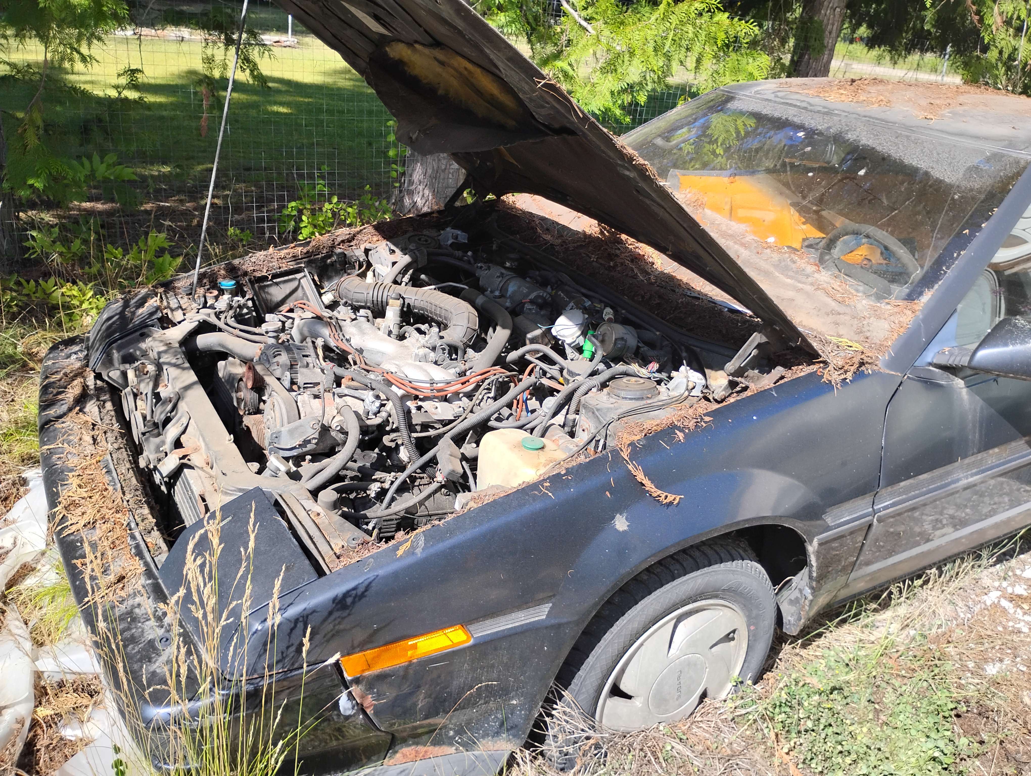

  16. I should mention, I'm thinking about making the XT6 rwd and using the donor axles for a ej22 swap. The XT6 interior is actually in really good shape and no sign of mouse occupancy.
  17. Minimal rust on the lower right hatch corner. I've got a brand new set of 13" winters that I've been storing, and a brand new set of front rotors that I bought for my bush beater 89' GL wagon, which I'm assuming will fit the turbo wagon no problem. That GL wagon has a D/R 5spd and I have another D/R 5spd that I pulled out of my GL sedan 15 years ago. So I have the pedal assembly to make the swap happen, but it isn't priority. Just want to get this turbo wagon running and "reliable" The XT6 seller is firm at 1k (cdn). Car comes with extra set of rims, headlight covers, doors, perfect condition front fenders (grey), extra front and rear bumpers, front and rear seats in good condition stuffed into the car right now, intact dash bezel, cybrid steering fluid. All the glass is good except a fairly minor crack in the front windshield which I assume I won't be able to source another unless I find a parts car down across the border in Washington. Rust holes by both rear wheelwells, I noticed a rust hole in the bottom of the trunk. Will need a radiator and likely headgasket job. He's done a spring replacement for the air suspension but says I should source a proper set of spring suspension so I'm not sure if that's available, or if I can slot a set that's for a different ea82 model. The owner has owned several XT cars and would be keeping this one if he could source a windshield. My end goal for this XT6 would be an EZ30 lowered cannonball style build/drift potential. I have the Knox Mountain Hill Climb near me which is the oldest running paved hill climb in North America. If I were to fully cage an ea82 for the purpose I'd probably use a GL coupe or Chaser(hatch). RX cars are almost impossible to find up here. XT6 too front weight biased to bother with a proper hill climber build. I do have 3 1960's BMW 700 cars. Two sedans one coupe. Blue sedan is my avatar photo. They're rear engine twin boxer. My plan is to do retromods on the two sedans and use all the good panels and OEM bike engine on the coupe cuz that's where the retained value is. Thinking about using one of those as a hill climb full tubular chassis with an ej22t with the proper NA 2.5 heads which I think come's to 2230 CC which with forced induction x 1.7 keeps me just under the GTO 4.0 litre class. Mate an ej22t with a subaru manual with flipped ring and built axles to handle the reverse rotation is probably my best option. Not interested in running a chopped VW pan/transmission which is what that Ludwig guy on youtube did for his 700 coupe. Anyway, someone talk me either out of this or into it haha. I'll probably just get it even though I shouldn't. Hard to pass up an XT6 in Canada.

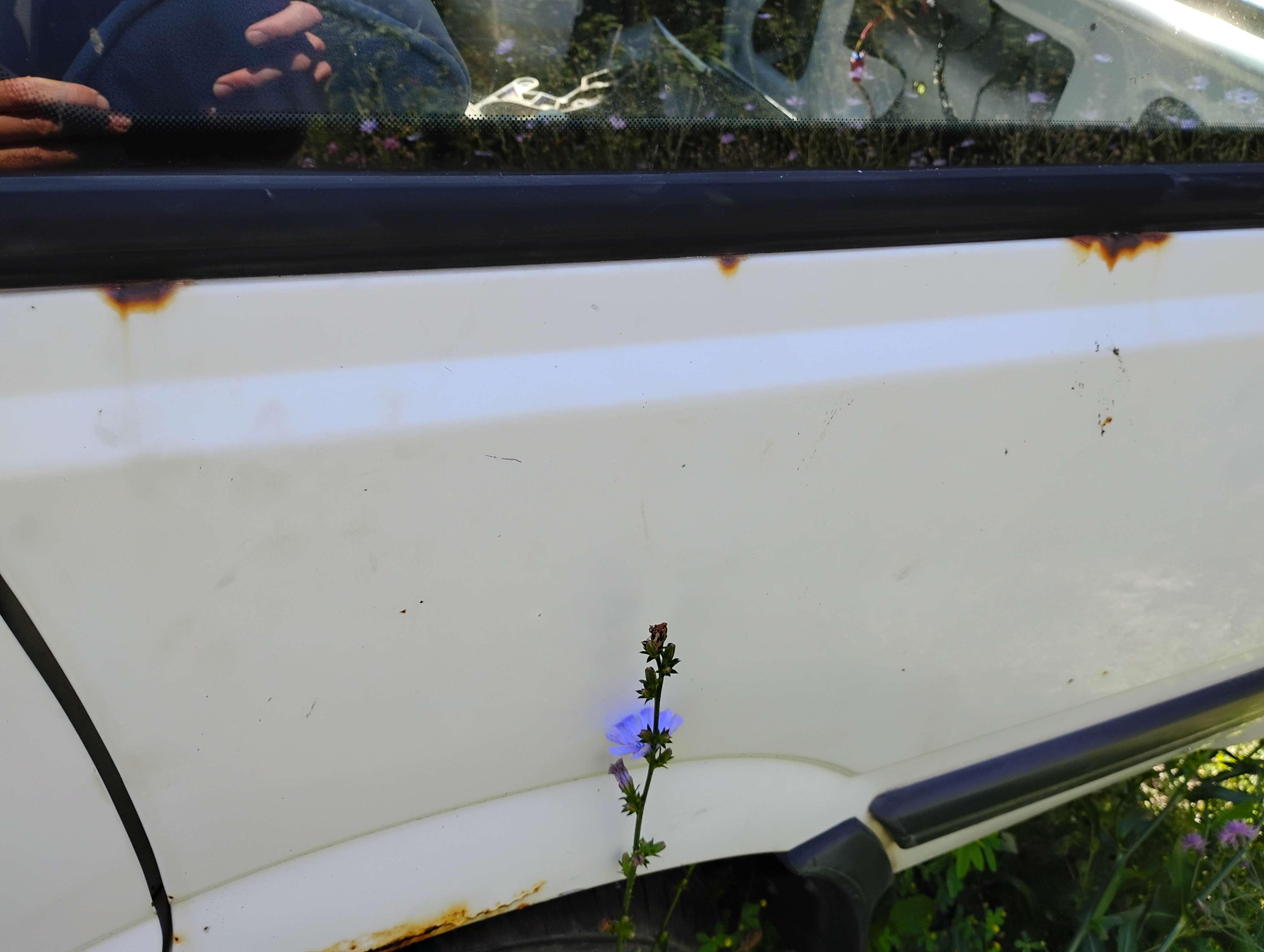

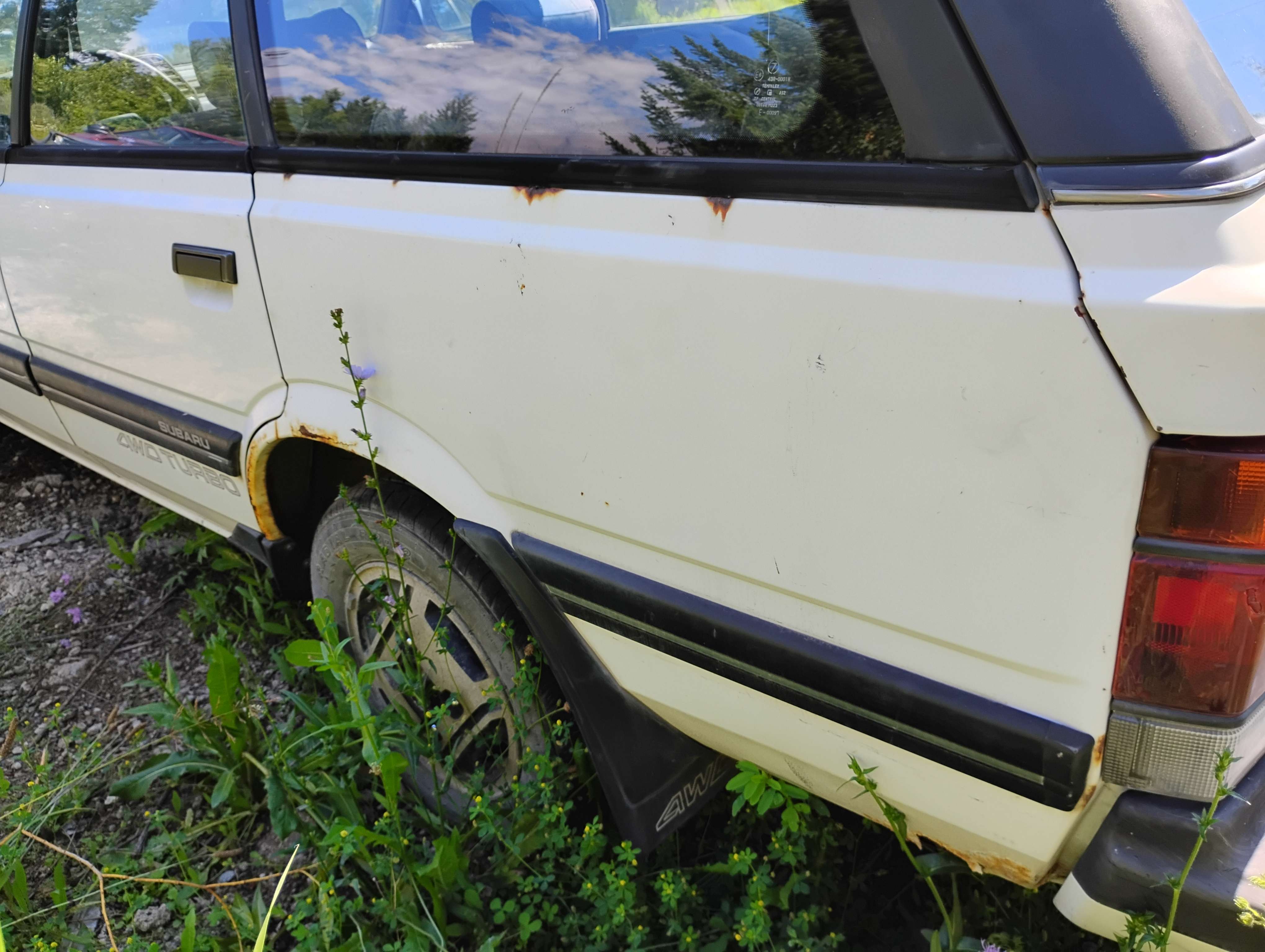

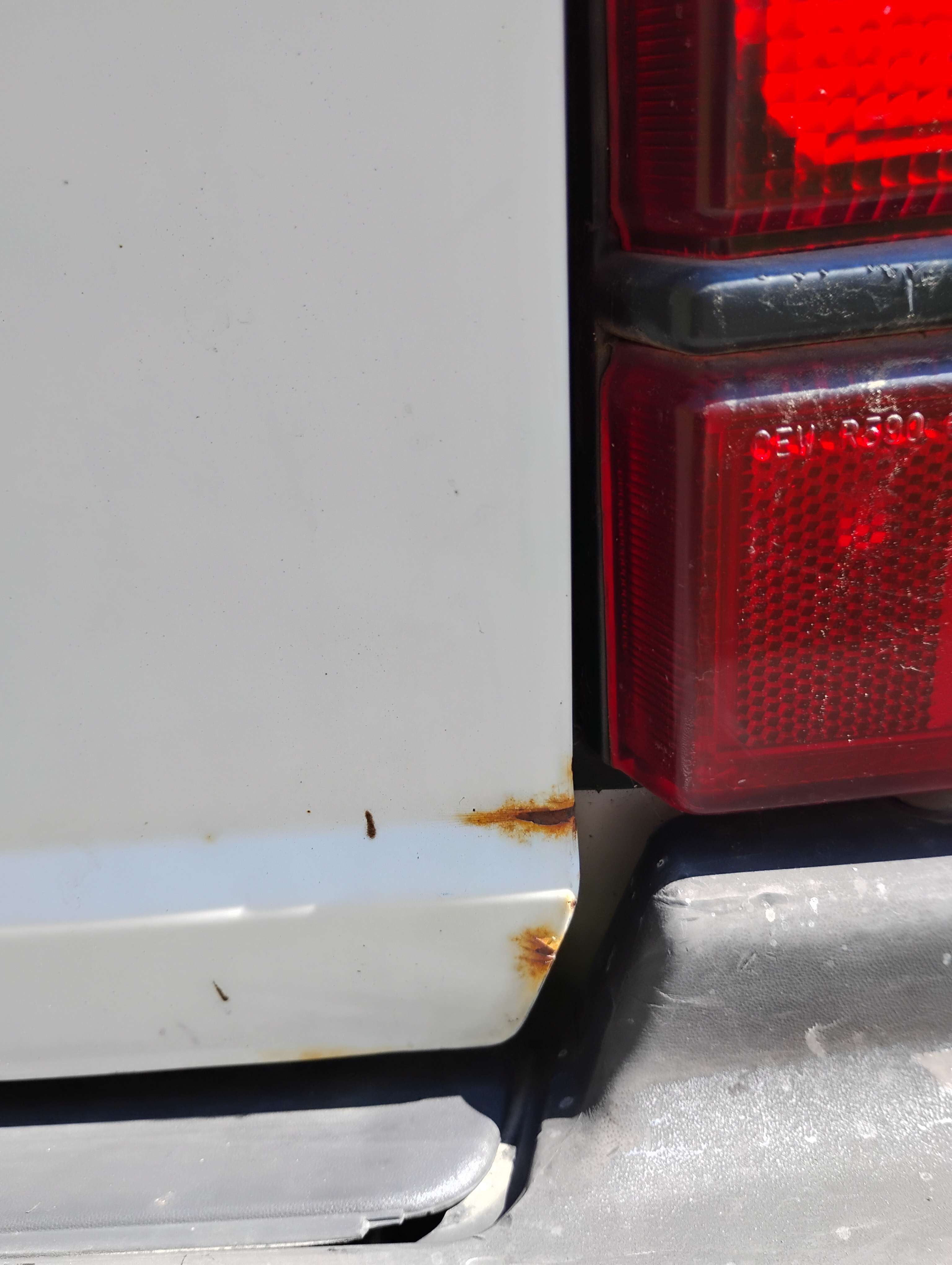

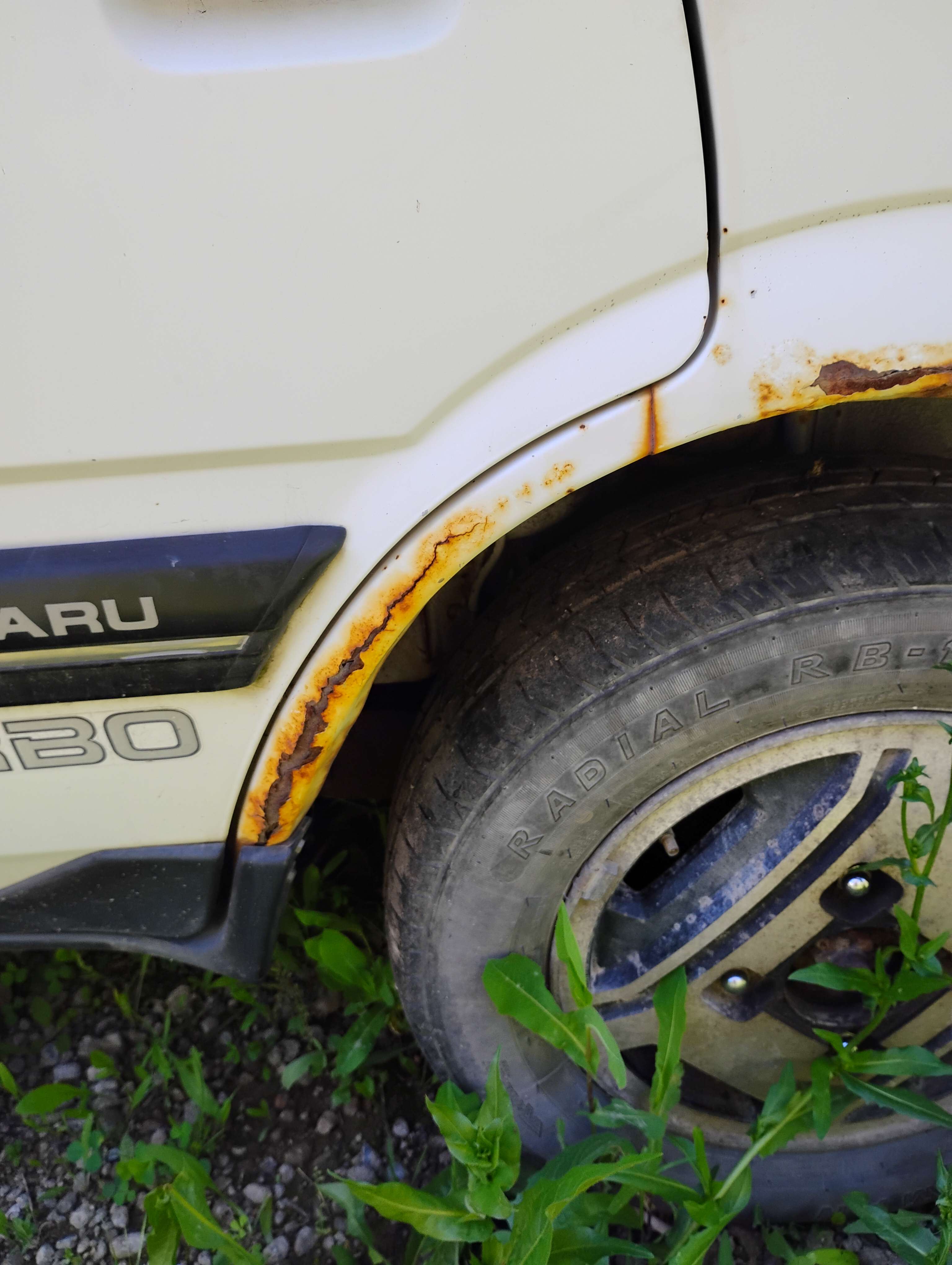

  18. I’m not sure that captive nuts are hex shaped, usually round tube that has a thread tapped in it. You can drill a hole in the side of the chassis rail above the bolt, only a small hole to put a penetrant can’s spray tube through to bomb the area. This will allow gravity to help it work its way down the thread. If you have time to leave this for several days then hit again another two to three times it’ll put you in the best position to get these bolts out fuss free, or with as little fuss as possible. Once they’re out and the job is done, seal the hole with some silicone. Could be worth painting the general area to avoid creating a new rust spot before the silicone closes the hole. All the best with it! Cheers Bennie
