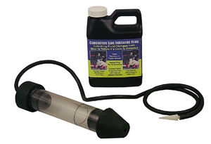

93 loyale...spewing anitfreeze????
Subarian replied to cooper_s's topic in Old Gen.: 80's GL/DL/XT/Loyales...
Here's a picture of what it looks like. The cone end goes into the radiator opening. This particular model (made by Lisle) has a vacuum fitting you put on any vacuum port. It draws gases from the radiator. If the gases in the radiator are combustion gases, the fluid turnes from blue to yellow. And yes, a blown head gasket can put a tremendous amount of pressure into your cooling system, as well as quickly adding heat to it. -
