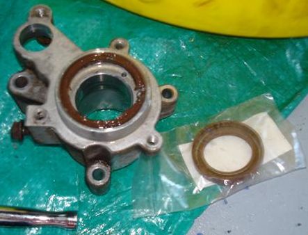

Cam Seal, How to Remove
msmithmmx replied to msmithmmx's topic in 1990 to Present Legacy, Impreza, Outback, Forester, Baja, WRX&WrxSTI, SVXTwo questions ,,,, 1) When installing the new seal do I coat the sides with a grease (the manual says to apply grease), what kind should I use. Also, 2) do I need to use a blue thread locker?
msmithmmx replied to msmithmmx's topic in 1990 to Present Legacy, Impreza, Outback, Forester, Baja, WRX&WrxSTI, SVXI got it out with a thin flat head screw driver. I banged it between the housing and the seal. I have a little pit but not on the rim that counts. The next question...... How do I get the new one back in....
OK, I am in the process of removing the cam seal and it will not come out. I have torn it somewhat and it still will not budge. Any tricks, I soaked it in multiply penatrating oils with no luck. Help Please
