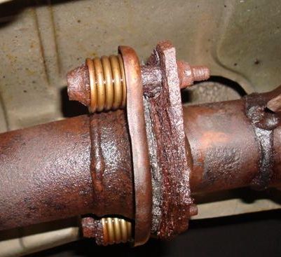

Exhaust Bolt Removal
msmithmmx replied to msmithmmx's topic in 1990 to Present Legacy, Impreza, Outback, Forester, Baja, WRX&WrxSTI, SVXIf I cut it in the middle will I be able to pull it out from the other end? Seems that its to big for the one side to pull through (side with the little nut)
I have a 98 OBW with a cracked exhaust mid pipe. I thought I would save a few bucks and swap myself. The bolts that connect the mid-pipe to the front section are completely rust-welded/deformed. Can I just take my Dewalt sawzaw to the middle and cut right through the bolts or is there some type of spacer there because I do not see any threads.
