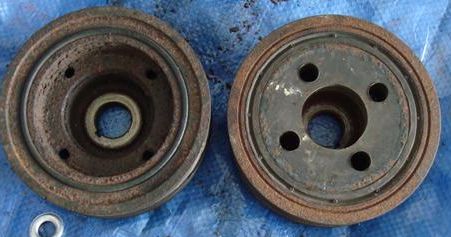

Part Interchange Harmonic Balancer
msmithmmx replied to msmithmmx's topic in 1990 to Present Legacy, Impreza, Outback, Forester, Baja, WRX&WrxSTI, SVXI agree, I looked at it closer and it just a rubber insert that seals it up.
I have a 96 2.5 OBW that I am doing the head gasket on. The harmonic balancer was shot and needed to be replaced. I found one from a 98 2.5 Forester for 15 bucks at the bone yard. They look different but my guess is they can be interchanged. Here is a pic, the original is on the left. Does anyone know?
