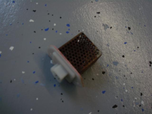

msmithmmx replied to msmithmmx's topic in 1990 to Present Legacy, Impreza, Outback, Forester, Baja, WRX&WrxSTI, SVXGood Lord 1) Regarding my inside fans only working at the highest level. I pulled out the resistor, its all rusted and I see where there is a broken connection inside. How much does it cost. Question, Is there a way this is causing my problem with the fans inside the engine compartment? 2) I unplugged the Coolant temp sensor. And with just the key in the ACC postion and the AC turned on I am getting .002 at the wire. 3) I have a new sensor from NAPA. without plugging the new one into the coolant pipe and just plugging into the harness I am getting the same results. Do I actually need to put it into the pipe. 4) How do I test resistance with it plugged into the coolant pipe. You guys rock.... And a pic of the little nasty bugger included

msmithmmx replied to msmithmmx's topic in 1990 to Present Legacy, Impreza, Outback, Forester, Baja, WRX&WrxSTI, SVX1) Where is this resistor? 2) I did confirm again when I pull just the connector off the Coolant temp sensor the fans inside the engine compartment turn right on. This is with everything else connected.
