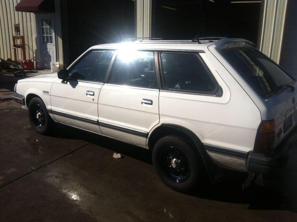

been awhile since i've had an old scooby but i find myself in need of reliable cheap wheels.. and i am falling back on old scoobies since i know them so well.. anyways, i will prolly pick up an 84 gl wagon, spotless inside and out with the exception of the dash.. interior has been redone original, power windows, power mirrors, a/c, power steering, its loaded for an old wagon.. only down side is its an auto.. other good stuff is everything has been repaired and resealed, runs like a new car.. body is straight, no dents, 100% rust free too..
