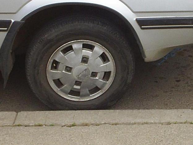

  25. this is my 86 gl wagon its got 205 r15 blazer wheels and tires and about a 3 inch lift right now 2000 pound weinch,CB,and ea82 plans are 6 inch lift bumpers more lights bigger raidiator.
