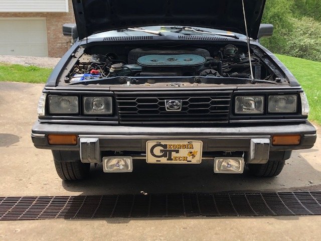

  9. Rather than start a new thread, adding to this one. Other than a crimper for open barrel terminals (to construct my own relay sockets), I have the necessary parts for upgrading the wiring of the Hella headlamps on the Brat. My plan is to use 2X Bosch relays with dual #87 terminals. I plan to run relay triggers (#86) from the dimmer switch inside the cab for the lo/Hi and Hi lamps. Question about the ground trigger (#85) on the relays - do I run dual grounds (2X each for the Hi/Low and Hi) from the lamps to terminal 85, after cutting the ground returns from the lamps back to the switch? This means the grounds will not be feeding back to the headlamp switch???? The remaining connections are fine, i.e. fused power from battery to #30 and power out via dual 87 terminals to the lights. TIA.

  11. A DOT approved, well designed and adjusted LED is fine. I have factory LED lamps (low's, fogs and the brake lamp) on my Nissan Titan Pro-4X and they are very good. I have the Hella's on the Brat and my goal is to add relays as soon as I receive my terminals. My Hella driving lights are on a relay and plenty bright, but the low and high beams at this point are mediocre. I expect an improvement after the relay upgrade. All remaining external lamps including the turn's on my Brat are Sylvania LED's.

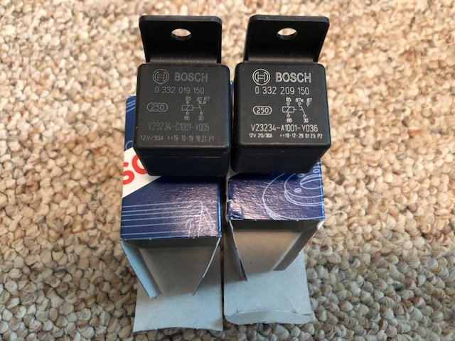

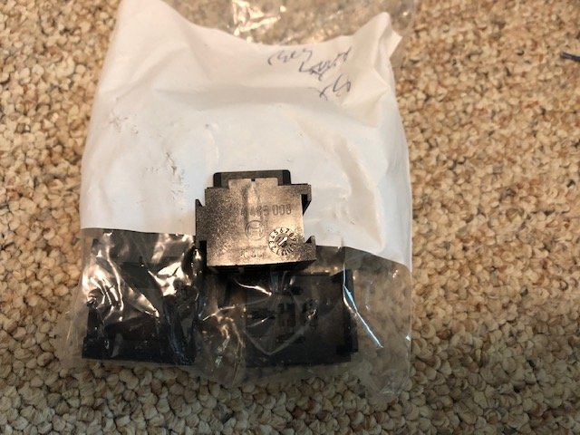

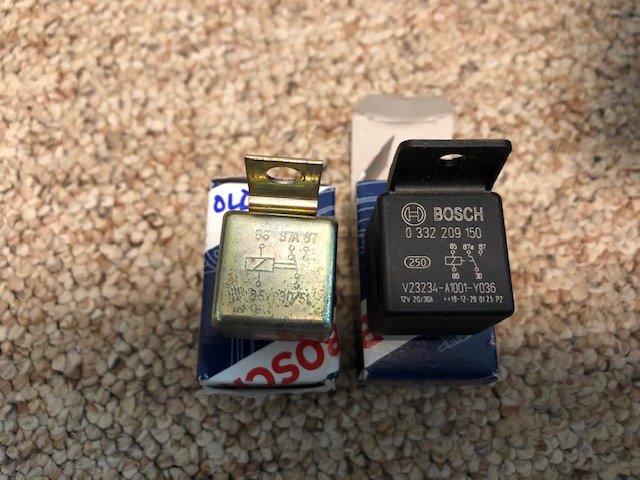

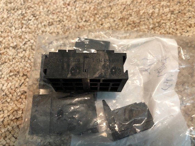

  18. The idle up system has not been functional on my 87 Brat since the day I bought it in 1993 with @63K miles; has 145K miles now. It has the dealer installed AC setup with the idle up vacuum motor mounted with three relays on the right strut mount. If I remember correctly, one of the tubes to the idle up motor was connected to the vacuum line going into the firewall via a Y-connector (there may be a check valve to this line as well). However, I am not sure, it has been several years since I took the Y connector off etc. I need to hook the vacuum motor back up and get the idle speed compensated when the AC runs. Would someone have the plumbing diagram for the vacuum motor connections. My vacuum motor and/or the diaphragm (with an arm that pulls the throttle when the AC is turned on) might also be bad, and I will have to source these components as necessary. However, I want to plumb everything correctly and test it out prior to throwing new parts blindly. TIA. PS. Is there a simple way to check the vacuum motor?
  19. Thread resurrect: OK, so I have lived with the low reading voltage gauge for years, but it is bugging me now and I need to make some extra effort to fix it. I have been doing several other fixes to the Brat, and why not tackle this nagging issue once and for all. I will clean up the mounting contacts and have also read that there may be an unconnected ground under the dash. However, several past half hearted attempts have failed to find this elusive ground wire. Any further obvious leads I need to pursue, other than cleaning up mounting contacts for the gauges and general wire troubleshooting.
  20. I received my relays, blocks and wiring over the past few days and am now waiting for the block terminals to arrive. The relays and blocks are Bosch, wiring is Ancor and terminals are Hella. I will be adding relays to my headlamps and have added some trivial relay sourcing information here: 1. You can get these relays at a decent price from FCP Euro. The two types I obtained are: Bosch Multipurpose Relay Bosch relay with dual 87 terminals 2. The blocks are: Bosch relay block Will be making my own wired blocks. The relay with dual 87 terminals will be used for the headlamps and possibly replacement horns (?). The multipurpose relays will be used for other general upgrades and or replacements. I have already replaced my under dash single and three under hood original gold toned AC relay's with the multipurpose ones. Have also received an 11" Spal fan as replacement for my aux fan that has been making terrible noises occasionally. Will need to figure out how to wire this with a relay. I believe the auxiliary fan may already take power from the battery via the under hood relay(s). Spal 30100411 Will update suitably.

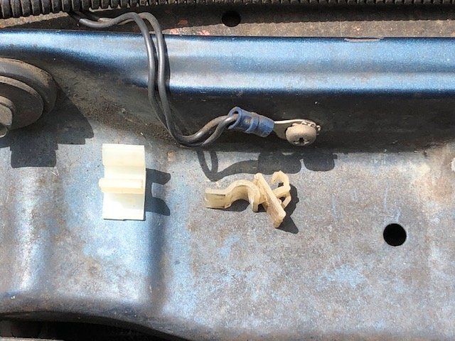

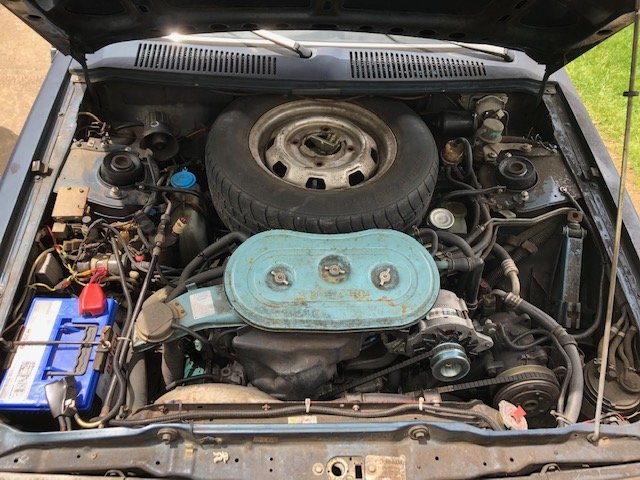

  24. So I was tired of just laying my hood support rod flat as my holder was broken. It has been like this for the past few years. The P/N for the holder is 657214080; it is still available and is under a buck at SPFY. However, it is one of the newest parts on my Brat. Simple things such as these parts can add a few horsepower to the older Subaru's and a bunch of 's. Please disregard the dirty engine compartment. I need to clean it up well.
