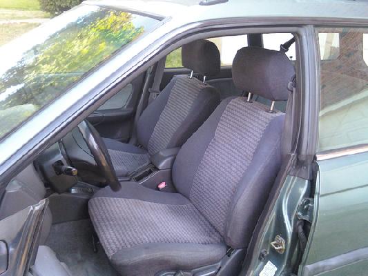

OB struts and OB front seats. 2" body lift and what feels like a 2" driver lift. However, while that new driver's seat is sweet, the passenger's side is vanilla, w/o the extra adjustments. WTB driver's seat from RH drive Outback.
