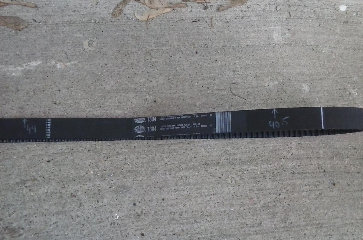

rrgrr replied to rrgrr's topic in 1990 to Present Legacy, Impreza, Outback, Forester, Baja, WRX&WrxSTI, SVXIt is back together and running good! Thanks again, Could not have done that without your excellent help! I was really getting sidetracked with all the tooth count and whatnot. Now I am having a beer! Cheers!!- Any hope for this EJ25?
rrgrr replied to rrgrr's topic in 1990 to Present Legacy, Impreza, Outback, Forester, Baja, WRX&WrxSTI, SVXIt's Alive!!! :D Thank You So much Fairtax4me!! -I have never done it that way. All the tooth count info looks to be incorrect, also, the printed marks on this belt would never work. Now to take it all apart and put the water pump, etc, in.- Any hope for this EJ25?
rrgrr replied to rrgrr's topic in 1990 to Present Legacy, Impreza, Outback, Forester, Baja, WRX&WrxSTI, SVXSo I marked the belt with the AutoZone lines and here's how it "lands" with the cam and crank timing marks aligned: Maybe you can see my marks (arrows drawn to them)- Any hope for this EJ25?
rrgrr replied to rrgrr's topic in 1990 to Present Legacy, Impreza, Outback, Forester, Baja, WRX&WrxSTI, SVXThanks I went looking for tooth count in another thread and marked the belt(-it looks to be way off-) but have not been able to confirm what the numbers are.- Any hope for this EJ25?
rrgrr replied to rrgrr's topic in 1990 to Present Legacy, Impreza, Outback, Forester, Baja, WRX&WrxSTI, SVXThe arrows are in the first pic pointing at the mark. Again, there is No '99 Outback in this thread. It is an '01.- Any hope for this EJ25?
rrgrr replied to rrgrr's topic in 1990 to Present Legacy, Impreza, Outback, Forester, Baja, WRX&WrxSTI, SVX- Any hope for this EJ25?
rrgrr replied to rrgrr's topic in 1990 to Present Legacy, Impreza, Outback, Forester, Baja, WRX&WrxSTI, SVXThis thread has gotten sidetracked, the Outback is '01, and Might take the 307, the Forester is '99 and I only see the 304 kit for it -which is what I have. The lines on the belt will not stretch to make all 3 marks align. If I can get the left and crank lined up, when I put the right on the marks- the cam has ALOT of spring tension wanting it to spin away. This has me thinking the valves are bent in there and springs are loaded where they shouldn't be. (?) Any help greatly aprreciated.- Tooth Count ej25
Struggling with this Timing belt, the printed marks are not working and I'm looking to confirm tooth count between cams and crank. It's a '99 EJ25 Forester. I've done a couple of these and not had this problem, it's a Gates TCK304 223 tooth belt. Going by this recent thread, I marked up the belt in the attached photo http://www.ultimatesubaru.org/forum/topic/152228-got-some-strange-specs-on-timing-belt/?hl=%2Btiming+%2Bbelt It seems like if the P side cam and crank will align, when I try to hook the d side cam, it is off several teeth. The marks I made here are counted from the left mark on the belt.- Tooth Count ej25
Struggling with this Timing belt, the printed marks are not working and I'm looking to confirm tooth count between cams and crank. It's a '99 EJ25 Forester. I've done a couple of these and not had this problem, it's a Gates TCK304 223 tooth belt. Going by this recent thread, I marked up the belt in the attached photo http://www.ultimatesubaru.org/forum/topic/152228-got-some-strange-specs-on-timing-belt/?hl=%2Btiming+%2Bbelt It seems like if the P side cam and crank will align, when I try to hook the d side cam, it is off several teeth. The marks I made here are counted from the left mark on the belt. Anyone want to help me out?- Any hope for this EJ25?
