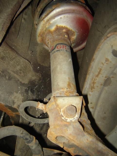

  2. Thanks, guys. It was part of the strut, that was replaced, what I was looking for. I only see one plug under the back seat, that is access to the fuel line. If I could, I'd lower that to level it. Guess I'll live with it. Don't really care to get into spring swapping and such unless necessary. The front wheels sit nice and straight, and seem to be wearing evenly.

  4. My 85 4wd wagon has a bit more rake than I'd like with the 2" lift -when it rains and I brake, it floods the windshield. If I could get it up in front an inch, it would help. Everywhere including the owners manual says there are adjustment nuts, but I don't see them. Forum searches are coming up vague as well. Don't see any plug for the rear torsion adjustment either. Mfg date is 12/84. I think the PO said the d-side strut was newer-the label there is readable,"KYB gas Replacement" -both sides look identical. Could the replacement strut be missing this? Am I not seeing something here?
