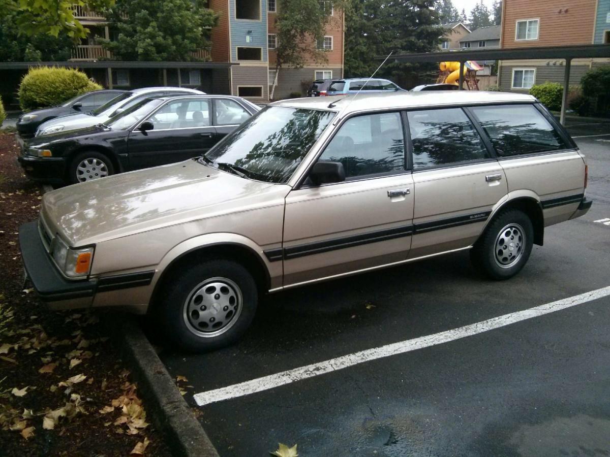

  3. Yesterday I got to put my lift on my 88 gl. I went with a 2 inch lift and a 1.5 inch drop on the engine and. Transmission. My gl is a 3at. So after the lift was put on and I drove it, there's a little rattling/ clicking only when I drive more than 15-20 mph. Also since the transmission was dropped the shifter is off a little bit, when it's in gear it doesn't show up on the dash and it is sometimes hard to shift out of park. i drove it home for 5 hours after the lift was put on with no problem but the click/ rattling. Does anyone know what these could be? Thanks.

  24. Anyone near mount vernon wa that can help me with a project. I Want to install my 2 inch lift w/crossmember drop and also need my steering coupler extended. And changing to 6 lug hubs. I have all the parts and hardware just want some help. Thanks.
