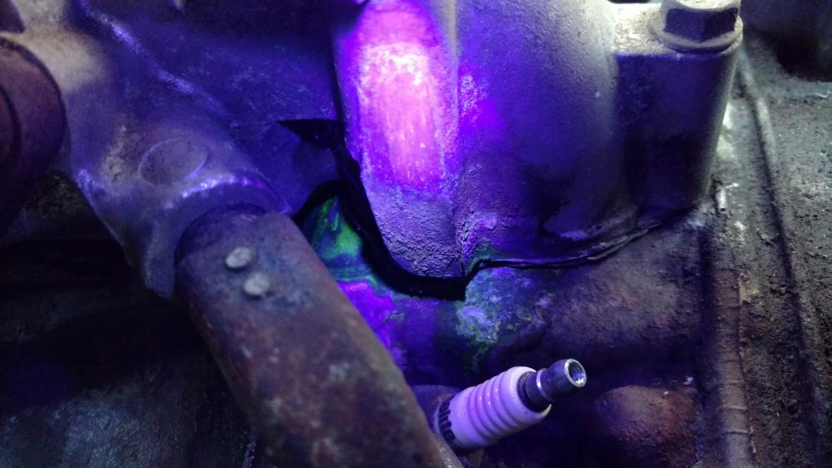

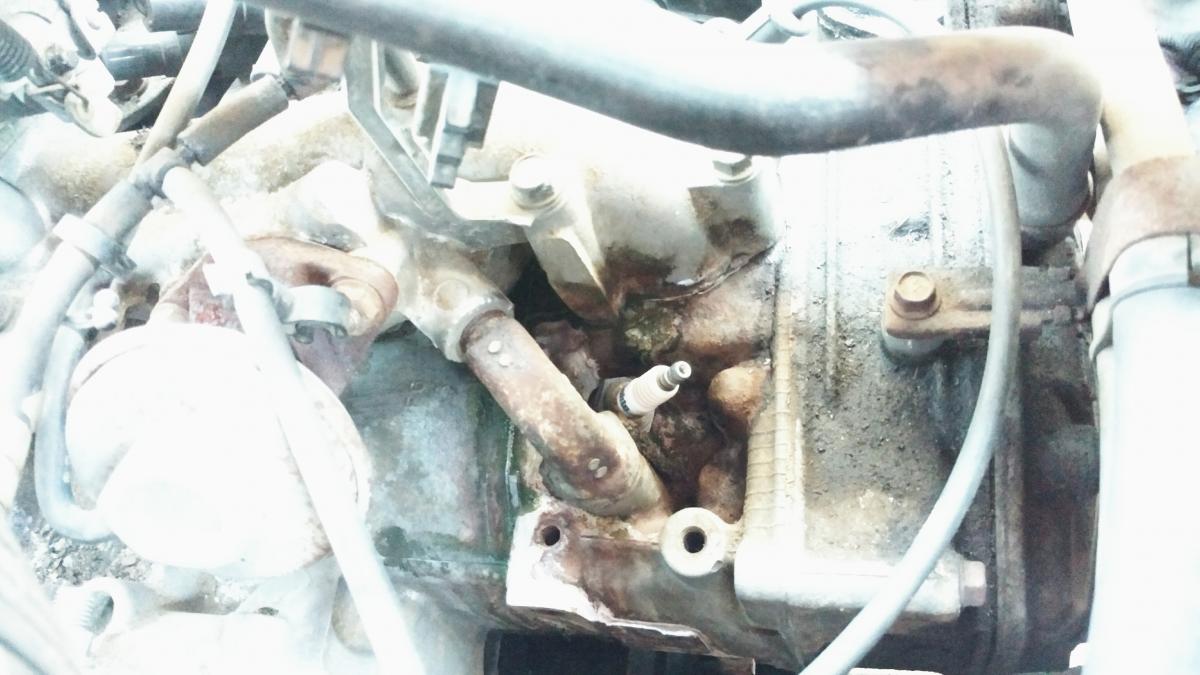

  24. Looks like a new manifold gasket is in order. I noticed coolant on the back right side of the head. I cleaned the area and ran the engine. Using a ultraviolet light I watched the coolant seep from the manifold. Thank God it wasn't head gasket! Any pointers on doing this job? Seems like a PIA.
