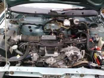

Well, it's almost running now. Redid the timing belts, roughly reset the timing and corrected the spark plug wiring. New plugs, better cap and rotor. Motor turns over, can smell fuel when I pull a plug and the timing light shows flashes but no engine start. Code 12 is the only code flashing: starter switch constantly on or off. Looked at wiring by ignition switch and see 3 clipped wires. Out of time for today; to be continued... -

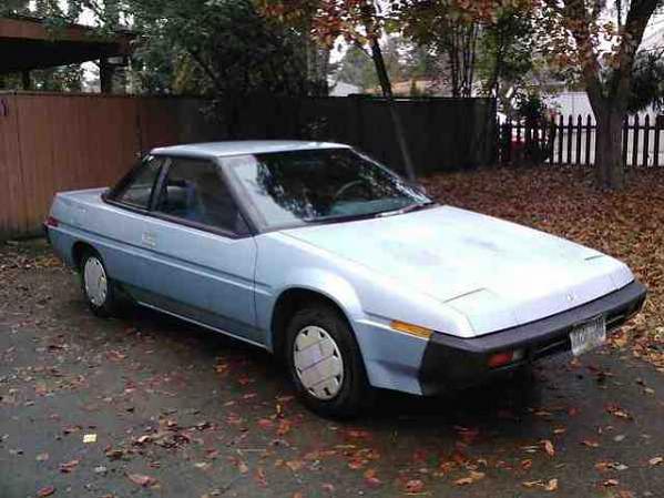

Zukira, I'll save the delete plate for you; my driver's side mirror is black, so I'll want to match it. This dl xt does have a rear seat, but it may have been added by an earlier owner. The lack of power steering and no air conditioning really will make working on the engine easy - lots of access compared to my previous 89 xt gl with an auto trans. The guy who sold the car put a new water pump in, with new radiator hoses and then messed up the driver's side timing belt - looks like the tensioner was loosened, but not retightened before the car was started and the belt jumped some teeth. Guess I'll find out soon if the reason for the new water pump was overheating and head gaskets... -
Have to redo the timing belts as a start; looking for a passenger side mirror, rear center reflector, possibly a better driver's seat. Know more next weekend. It's just fwd with the 5-speed, 140K.
