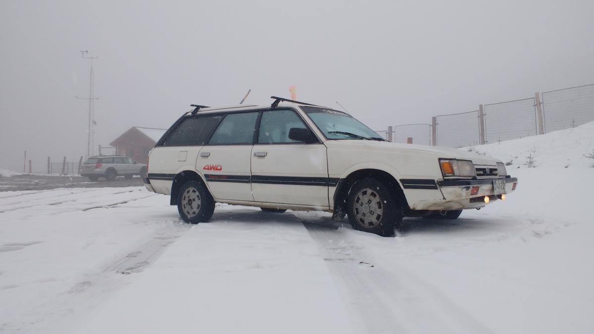

  8. Hello Everyone, greetings from South America new to forum posting, long time voyeur. I recently picked up a 89 loyale 4wd ea82 carbed, 5mt dual range in regular body conditions but with a really smooth running engine, not so smooth tranny! My question is, What is the number of positions the 4wd lever should have (curved lever, not the "T" style lever found on brats), and what does its supossed to do on each? As of now i have figured out: 2H N ( should this be a 4 High?. No light at dash)) 4L ( this posittion turns on light at dash) Normal should be? 2h 4high 4low Little info: On purchase chek, i noticed a squirring sound when putting it on 4wd, (first step of lever y assume). Previous owner said it was only the rear diff being dry and that i would just have to pour some oil in it and it will stop making the sound, he offered me a deal, 200 usd of, if i took it like that, v/s regular price if he refilled it and it stopped the sound. Took the gamble, only to later find out that rear diff spins all the time (yikes!) Refilled it and it seemed to work fine! But still, cant find or seem to find how the heck to get it on 4wd High. Looked under the car when doing the oil change, when movin the 4wd lever it posittively made the rod on the transfer move in and out without issues.
  9. My 89 Wagon. It snowed the day we picked it up. 5MT- 4wd D/R transfer( i think, no push button, lever with to positions).
