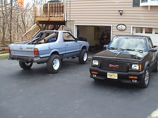

  20. Heres my sleeper next to my brat project. 91 gmc syclone awd 4.3 turbo with lots of goodies. 0-60mph in 3 seconds on a good boost launch. Nothing better than blowing the doors off a yuppie in a vette or porche.

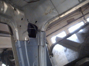

  21. Pic of where it was cut inside of the B-pillar

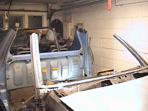

  23. It was scary but I got it done. Its welded on,got a few hours of grinding before it looks presentable to the paint shop,looking like this thing may hit the streets this spring
