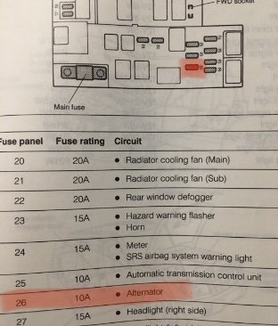

Thanks guys. @1 Lucky Texan: I have no CD player. Therefore no stuck CD! Following internet advice on these common leaks, I diligently turned everything off and removed the key, doors closed etc. and did a few tests. One expects a small current (20-50mA I understand), for the immobilizer, clock etc, testing for current in the mA scale. My reading today was 20mA, and no fuses other than ‘Clock’, when removed, changed that. I made the same test on the other Forester and got the same results. seems to be normal then... Testing for AC in the mV scale across the battery whilst running the engine showed 3.2mV, apparently a sign that the alternator diode is faulty, as this reading should be zero. I tested the other Forester and got the same reading, 3mV. ? I have been starting and running the car today, and the battery voltage seems to be holding steady now at 12.35V. I have left the battery connected tonight, and in 8 hours I will know if this has just been ‘one of those things’ or if the problem persists. I hate vehicle electrics, but at leastI have learned some more about this. Thanks all for the input, and I will report back as to whether this was just due to a badly closed tailgate or some other gremlin.
Hi all After a month or two of trouble-free driving, this morning I went to start the green Forester SF and it sounded like the battery was low. The car started, I ran it for 5 minutes, no warning lights etc, stopped the engine, cranked it over again and it started as it should. I left it parked until this evening, 7-8 hour's later, and it wouldn’t start, obviously with a drained battery. The battery has been reliable and strong, it is a two year old OPTIMA red-top battery. This evening I jumped it with the other Forester, and after one minute of running I could stop and start the engine on its battery as normal. I then pulled all of the fuses one by one with the ignition off and measured voltage. There was voltage drop only across the 10A ALT-S alternator fuse connectors in the engine bay fuse box. All other fuses showed no voltage. No lights left on, key out of the ignition, but voltage across the alternator, is that correct? Reading during a few minutes showed voltage dropping by 0.01V every ten seconds, I imagine until the battery is drained. I tested the voltage across the battery whilst running the engine and read a healthy charging current from the alternator. The only thing I have done to the car in the last days is try a cheapish OBDII reader to find an intermittent CEL , but this only showed error when connected; “can’t connect with vehicle”. Could a faulty code reader possibly set off a battery drain in the charging circuit? Impossible coincidence? Am I barking up the wrong tree, and does the alternator circuit always carry battery voltage? Stumped here, as auto electrics are not my cup of tea! Thanks in advance for any ideas or starting points. From the owner’s manual. The highlighted fuse showed voltage with the key out:
