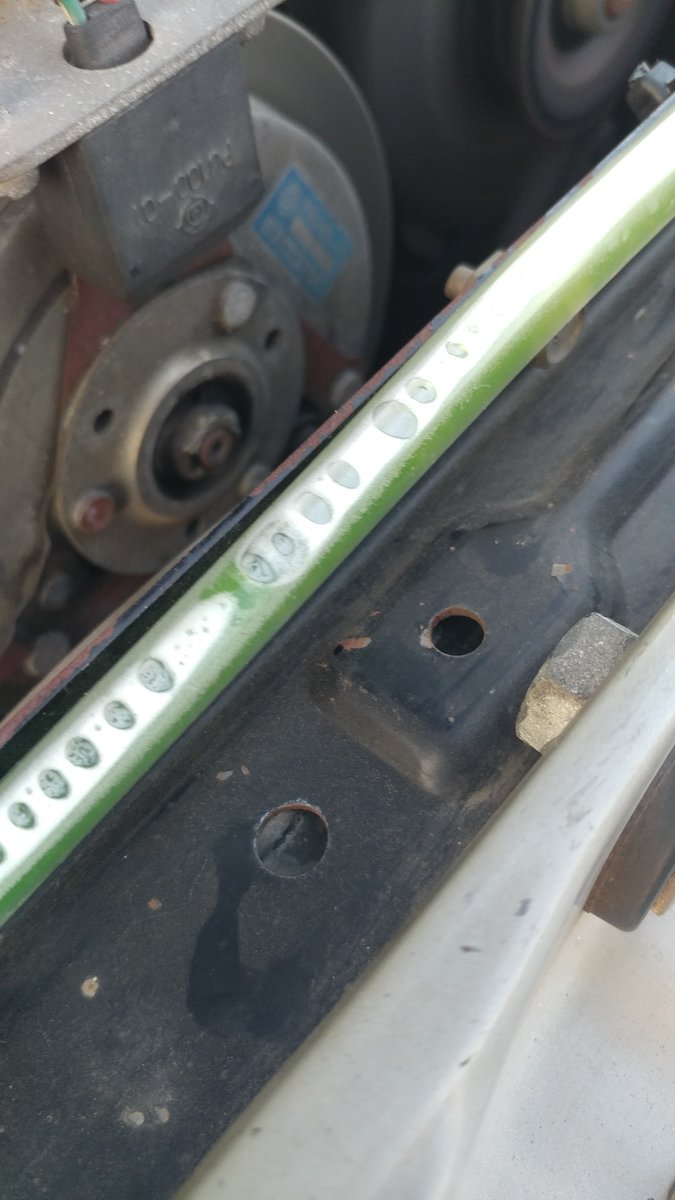

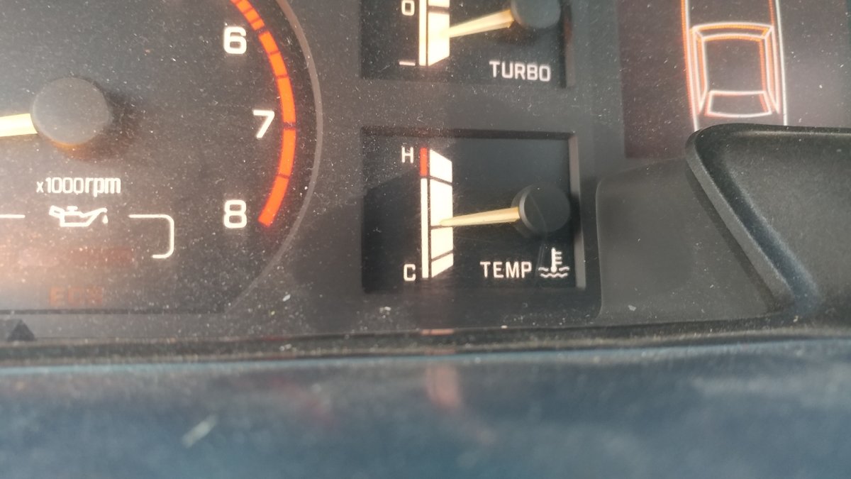

So I made a temporary coolant reservoir and top off the radiator to the cap. Drove the wagon for a bit release the pressure to get the bubbles out of the hose. Still running hot. Even the electric fan is staying on for longer periods. When I open the cap to see whats going inside. I dont see any flow or resemblance of coolant flowing thru the radiator. Scratching my head now. It wasnt getting hot when it was running rich in fuel mixture about couple weeks ago. Hopefully those are hot presure air bubbles and not cusbustion leak bubbles. Needle above normal operating temperature. Usually the needle sits on the line or below it.

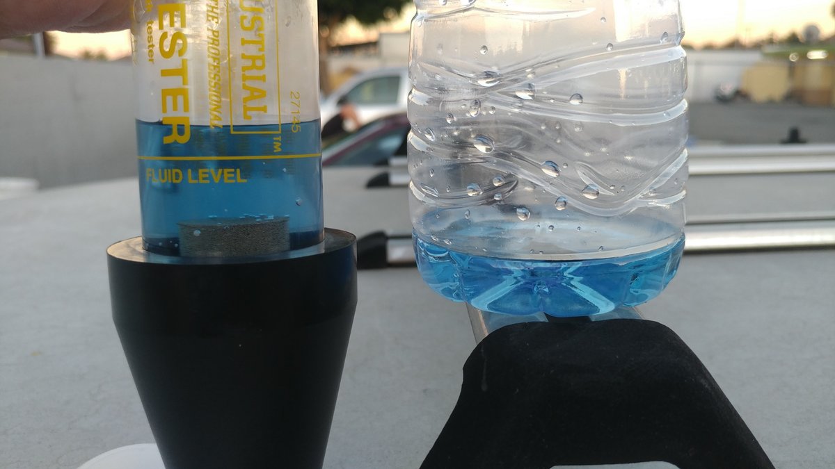

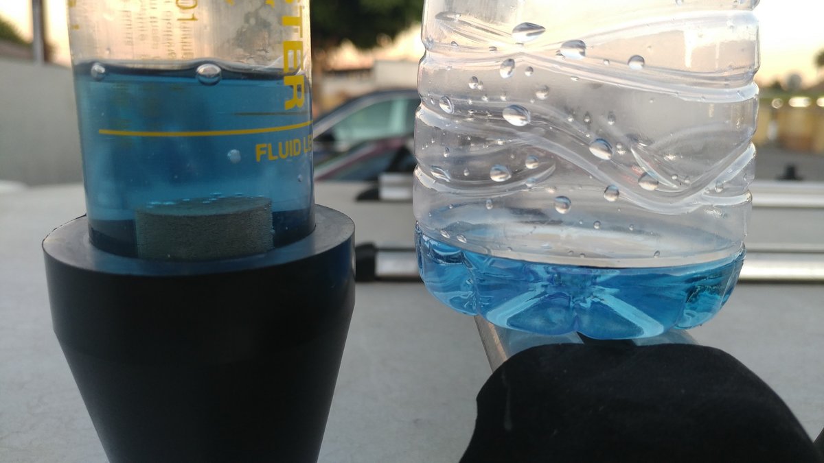

So i drove my wagon to work for the first time. On the way back coming home there is a small incline on the freeway and I noticed the temperature gauge starting to rise and leaking coolant thru the presure vent hose. I never notice any coolant leak but yet I had add coolant a couple times now. So I'm already thinking the worst, head gasket leak. So I get a block tester to see if theres any combustion fumes in the radiator which would determine and leak. Fluid should turn yellow after a couple minutes suctions. I have already change the thermostat. But still getting hot on that incline. I read in the manual that the radiator shoul not be top off but fill to a fin inside the radiator itself. Any suggestions?
