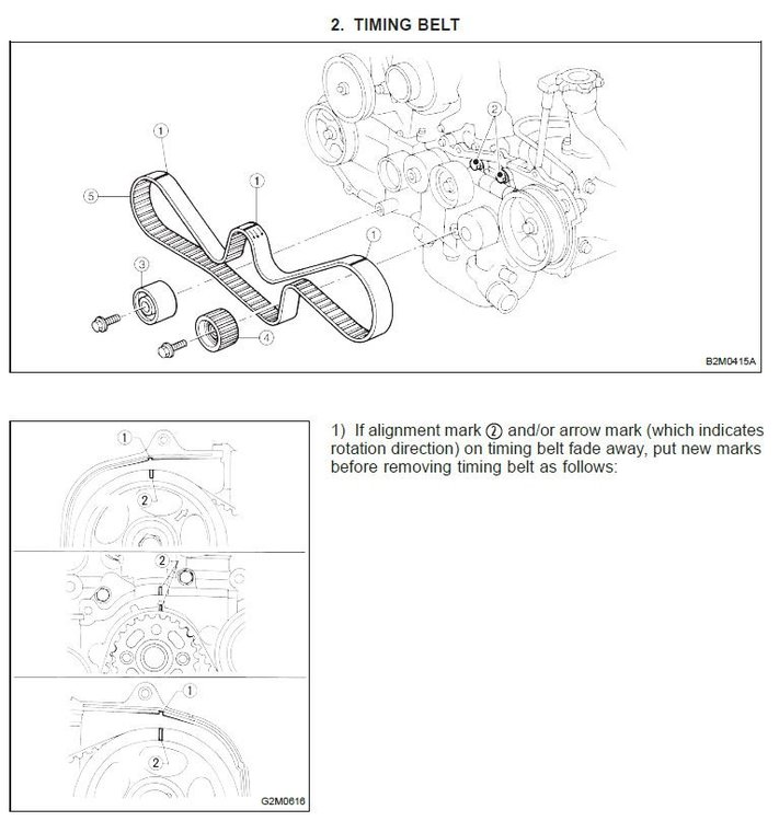

Rampage replied to Cfoust's topic in 1990 to Present Legacy, Impreza, Outback, Forester, Baja, WRX&WrxSTI, SVXRemove the radiator hold down bracket. Remove the fans and overflow tank. The fan on your left I lower it out the bottom. Remove the left and right timing belt covers. 3 10mm bolts each. Turn the crank clockwise and watch for the mark on the front surface of the cam sprocket (on your left) to line up with the notch in the rear cover. Then look at the other cam sprocket and see if it lines up with its notch. Note: it may be a smidgen off, but not a whole tooth. Sometimes I have to go around a couple times before I can see the tiny mark. If the marks do not line up I can post a pdf on how to replace the belt or you can download the factory service manual.

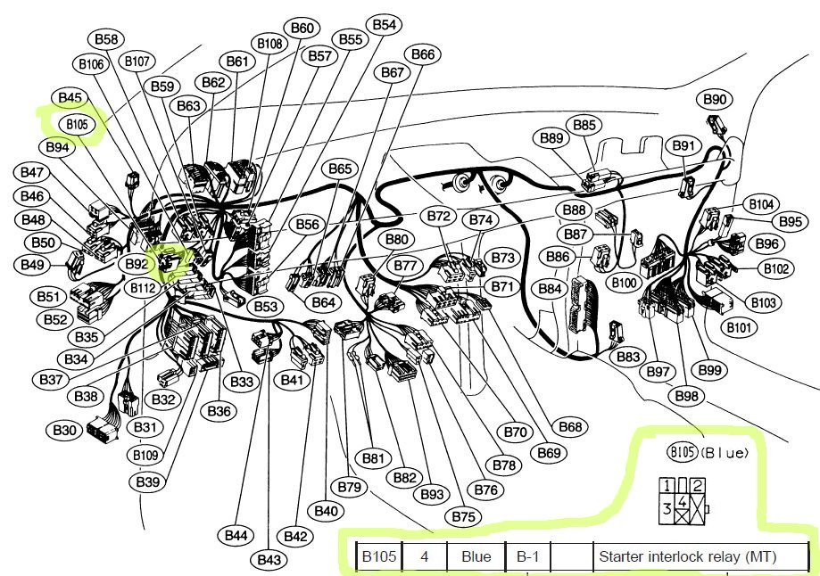

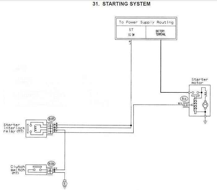

Rampage replied to Cfoust's topic in 1990 to Present Legacy, Impreza, Outback, Forester, Baja, WRX&WrxSTI, SVXI'm guessing this 96 is LHD. If the chatter is coming from the upper left of the dash where the Starter Interlock Relay is located, it is probably a bad Clutch Switch not passing enough current causing the relay to chatter. Or a poor contact on the clutch switch connector, or the relay socket. Or a bad Start contact in the ignition switch. Temporarily, you can unplug the connector from the clutch switch and jumper the two together and see if it starts. Put it in neutral to try this. See photos. The relay socket is B105 and it is Blue. Hope this helps.
