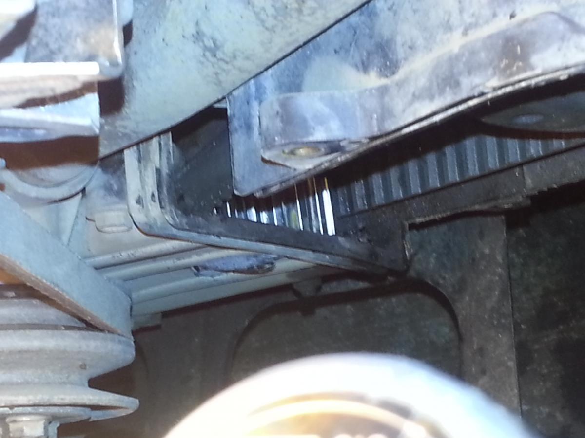

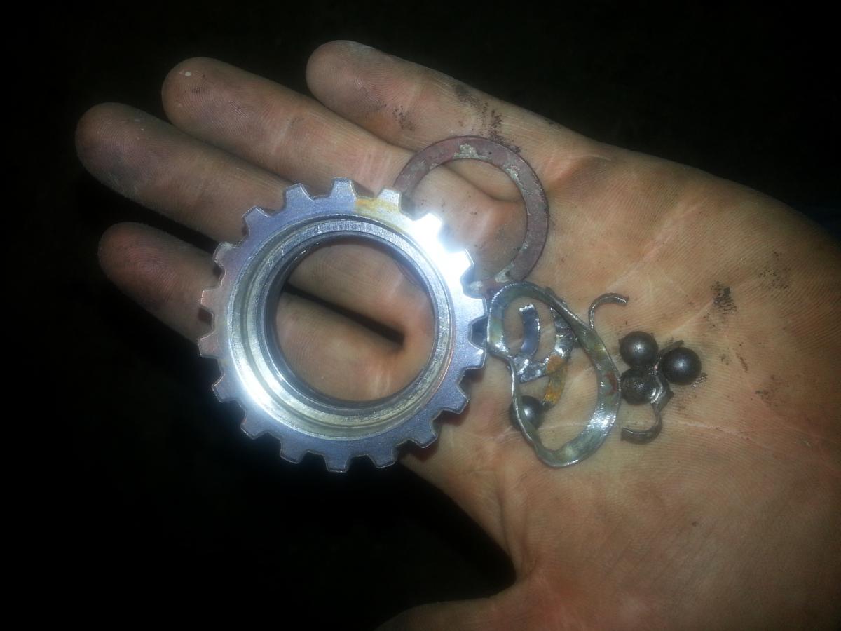

  5. Friday I replaced the timing belts and water pump. As soon as I got the timing cover off, metal pieces just started falling out. That idler pulley was hammered. Now the car runs like a dream. Thanks guys for the help.

  8. Thank you. I did some digging today and tried the wooden dowel trick. Definatly coming from the driver side, so I took the timing cover off and found the culprit. Its an idler gear or something. I didnt even notice till the cover was off, but that idler or whatever it is is wearing a hole in my timing cover.
