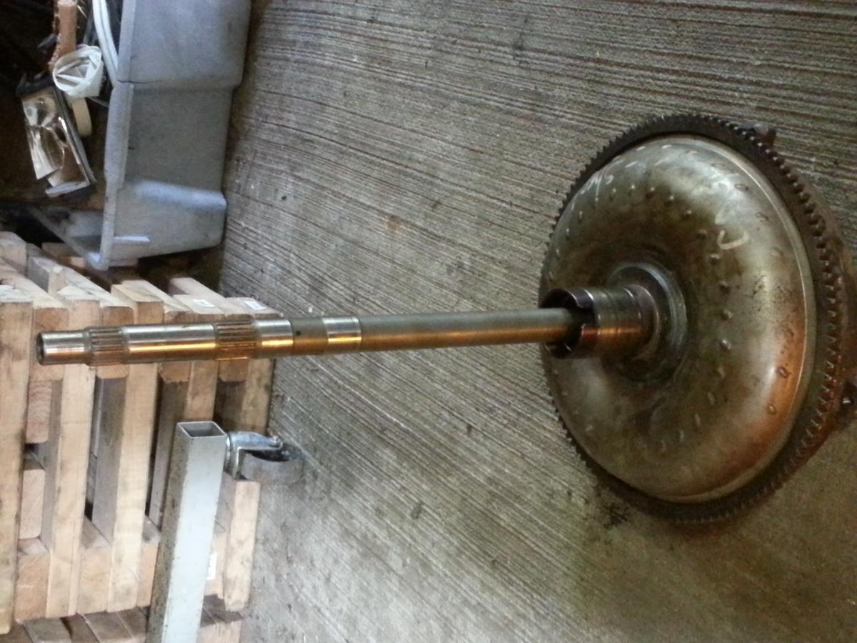

espey_16 replied to espey_16's topic in 1990 to Present Legacy, Impreza, Outback, Forester, Baja, WRX&WrxSTI, SVXI got the input shaft out of the tc, but I cant get it to seat in the tranny. I don't know what I'm doing wrong, I've been reading this thread http://www.ultimatesubaru.org/forum/topic/79130-how-to-seat-your-torque-converter-by-mnwolftrack/page-2?hl=%20torque%20%20converter over and over again for the last 2 hours and can't get the tc past the first stop. What's goin on here?

espey_16 replied to espey_16's topic in 1990 to Present Legacy, Impreza, Outback, Forester, Baja, WRX&WrxSTI, SVXHow am I supposed to get that shaft out of the torque converter? I'm about ready to have my dad go get a new one.

espey_16 replied to espey_16's topic in 1990 to Present Legacy, Impreza, Outback, Forester, Baja, WRX&WrxSTI, SVXWhen pulling the tranny, are you supposed to remove the torque converter at the same time? I've never pulled an auto before. I got the tranny out last night, but the input shaft is still sticking out of the tc. The tranny I pulled from the junk yard came out easy.
