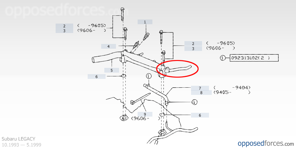

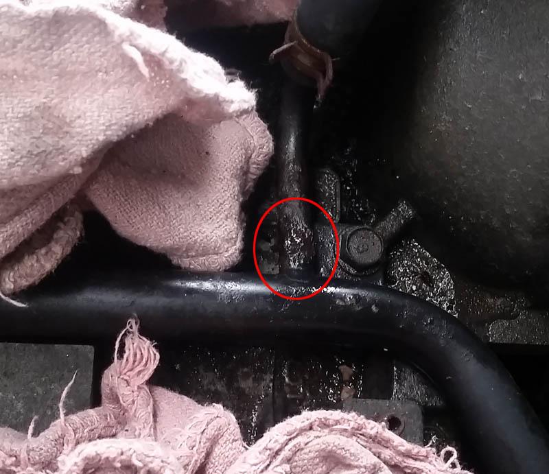

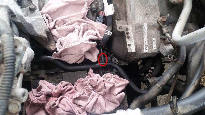

so discovered today that my trusty 2002 Forester with nearly 240K on the clock has developed a coolant leak in the heater hose stub pipe that connects to the crossover... or at least I am about 98% sure that is where it is leaking... (see diagram for clarity - the circled bit) She has not been overheated (yet) and I would really like to prevent that from happening It does not appear that this piece can be purchased separately from the crossover pipe, and I don't need the whole damn thing.. (nor do I wish to remove the entire intake to replace the whole thing) - but it does appear to be bolted on to the crossover. there are two bolts - top & bottom - on a flange that appears to be a part of that pipe So - desperately seeking a replacement. Please - someone has to have one of these things around in decent condition? I am willing to pay for the part & shipping, just need one very soon!
