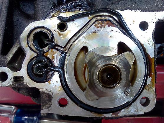

August 17, 201114 yr Im pretty pumped that I have eliminated the lifter tick in my 91 Loyale. I know this is a common issue thats been covered a bunch, but I figured I'd let you guys know how it went for me. I started out trying fresh oil and MMO. It worked almost imediatly until the oil warmed up, tho it was slightly less noticable. So I went one step further and replaced the "mickey mouse" gasket, which by the way was in terrible shape. I finished that job up, primmed the oil pump and expected to hear lifters for the first few second untill oil pressure built up. I was kind of let down when the lifters stayed ticking for 10 minutes. So I shut it down and was comfortable just dealing with the sound since the thing ran fine othrewise. The thing that gets me is after driving around today, about 40 miles, I got out of the car while it was idling and the motor was so quiet. Anybody have any theorys why it took so long for the lifters to quiet down?

August 18, 201114 yr Author Yeah it has some scars, but it mic'd out within spec and made good oil press. Plus they wanted twice that for a pump.

August 18, 201114 yr You need to order the one for a DL - with the pressure switch instead of the GL one with the sending unit. Then you swap over your sending unit. GD
August 18, 201114 yr Your oil pump is trashed. Get a new one - about $65 from the dealer. GD How I wish I could get a new $65 oil pump from the dealer! Got a quote the other day and the oil pump is $565.00 (Australian dollars) ex-Japan ! Luckily there is eBay...
