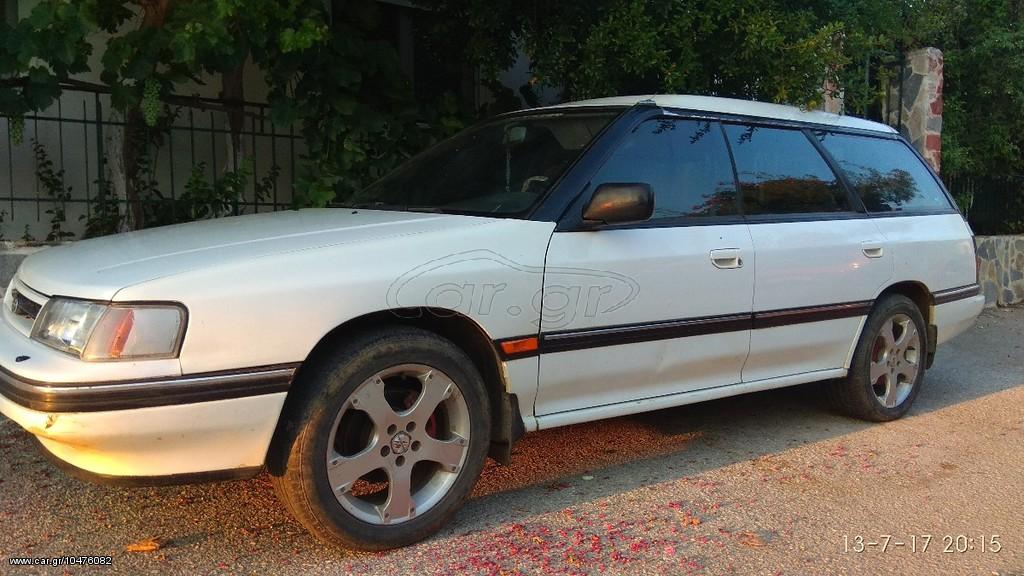

I have a legacy wagon 1992 mod. with ej18 engine . I want to lift about 2-3 inches.Wich model of Outback. or Forester components (sruts springs) will fit ?
Hello from Greece !
I have till today 387.000 kms with no major issues .
The car works fine with - lpg .post-67670-0-08651100-1504176119_thumb.jpgpost-67670-0-08651100-1504176119_thumb.jpg
Edited by gbtechelec
Buy all 4 struts for a 1998 Legacy Outback, re-use your springs and top hats. In the rear you will probably need to put a couple lockwashers under the nut that holds the top hat onto the strut because the threaded portion of the Outback strut rod doesn't go far enough down so the nut jams before it actually clamps the top hat. Other than that it's pretty easy. Instead of un-doing the brake lines and bleeding them after, just cut into the bracket and bend it back so you can slip the hose out. do the same to the new strut, slide the hose in, bend it back flat and put the spring clip back on.
