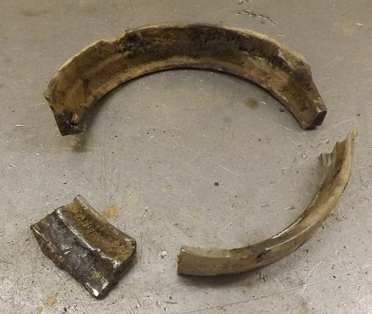

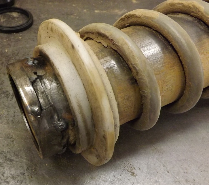

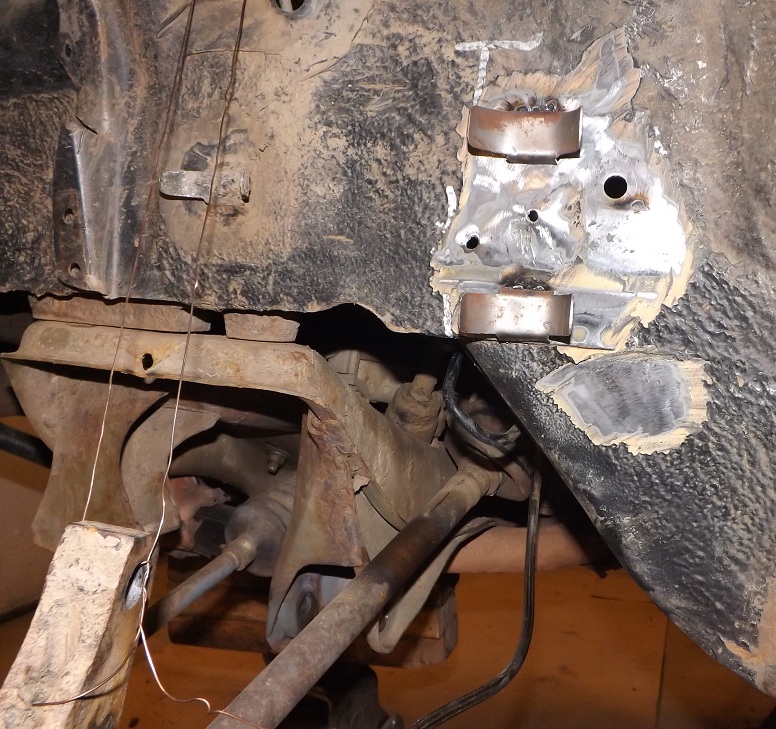

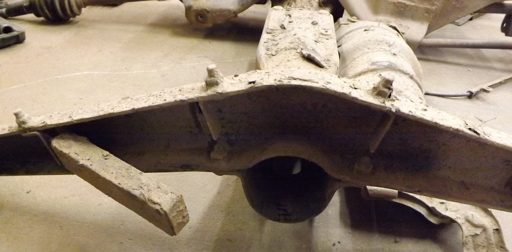

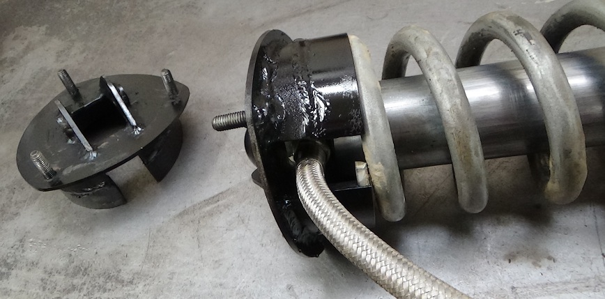

The rear has always been noisy and I think we figured out why.  The top spring perches are just bolted to the body which is not square with the strut.  I briefly thought about that when we were building it but didn't realize it would be such a big deal.  There is about a ten degree difference between the angle of the top perch and the strut, which causes the top spring to bend outward when compressed.  This has worn some flats in the coils and has been wearing out our wiper seal retainers.
It even broke one apart.
Ten degrees didn't sound like much but it works out to about 3/4" over the width of the perch.
Bolted back up to the car without the spring and compressed it most of the way and it's within 1/8" of square now.  Hopefully this will solve the wear and noise issues in the rear.
The spring perch mod definitely fixed the noisy rear suspension.  We've been tuning the shocks a bit, mainly adding a lot of damping in front, but it still needs more.  I even let the guy who's helping us tune the shocks drop the front end of the car with at least a foot of air under the front tires I've become so confident in the suspension.

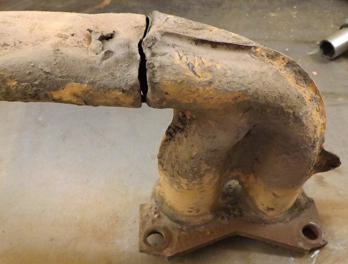

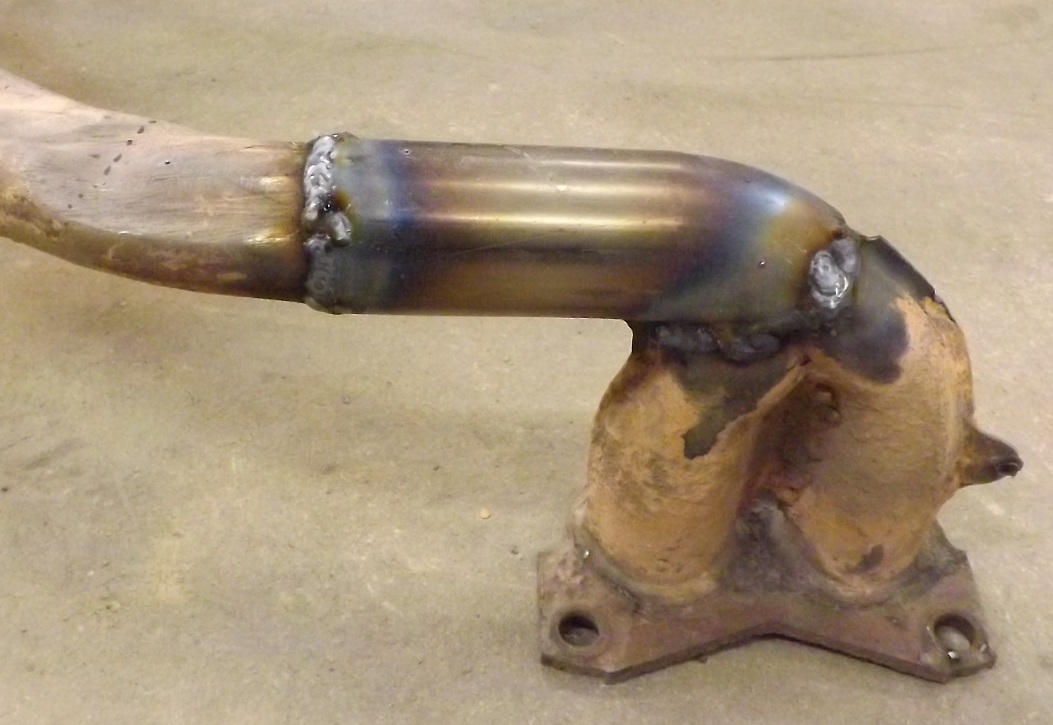

I recently fixed the exhaust I smashed in Kentucky.  This picture doesn't show it well but it was probably flattened to about half its original diameter.

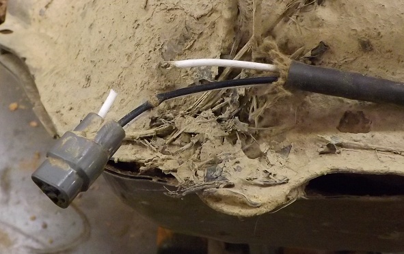

One of the wires for the front O2 sensor was broken and another one broke while I was splicing that one, so hopefully those are conducting electricity now:
Had a 1.75" u bend lying around so I spliced part of that in:

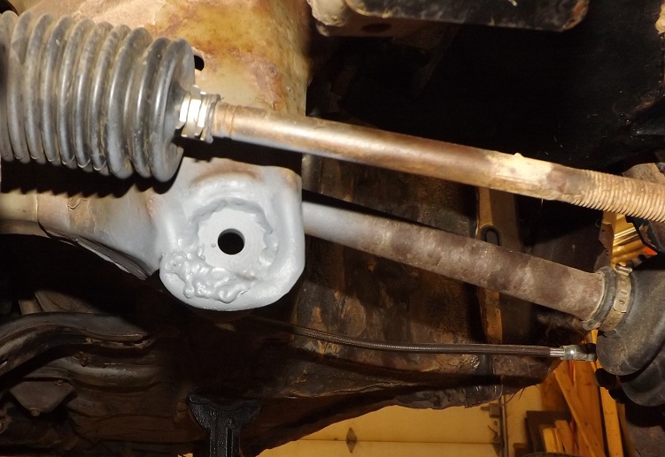

So I got that back into shape, welded the crack, and turned up a slug and welded it on to reinforce the hole:

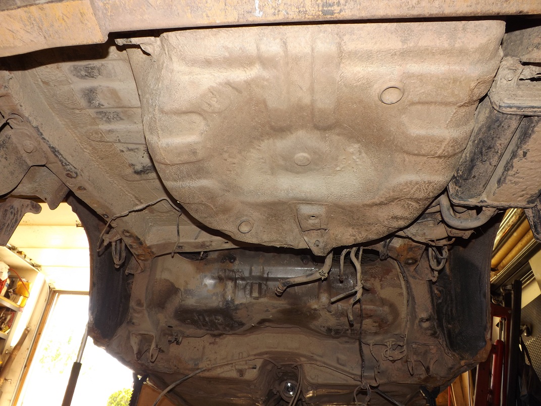

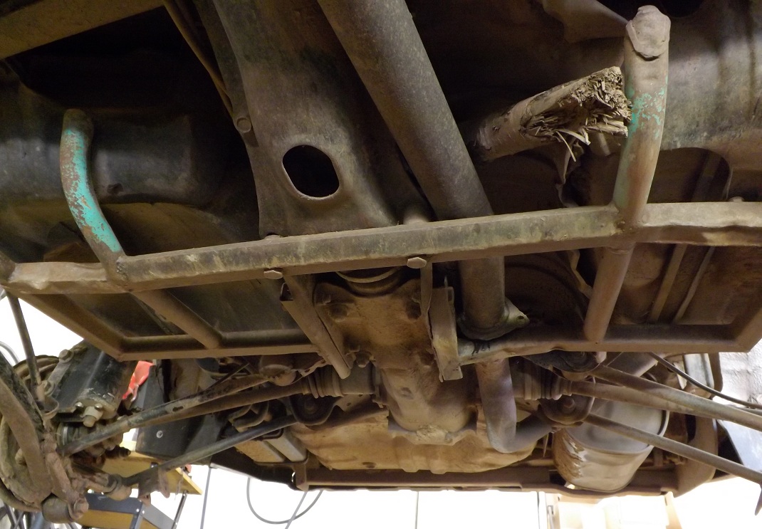

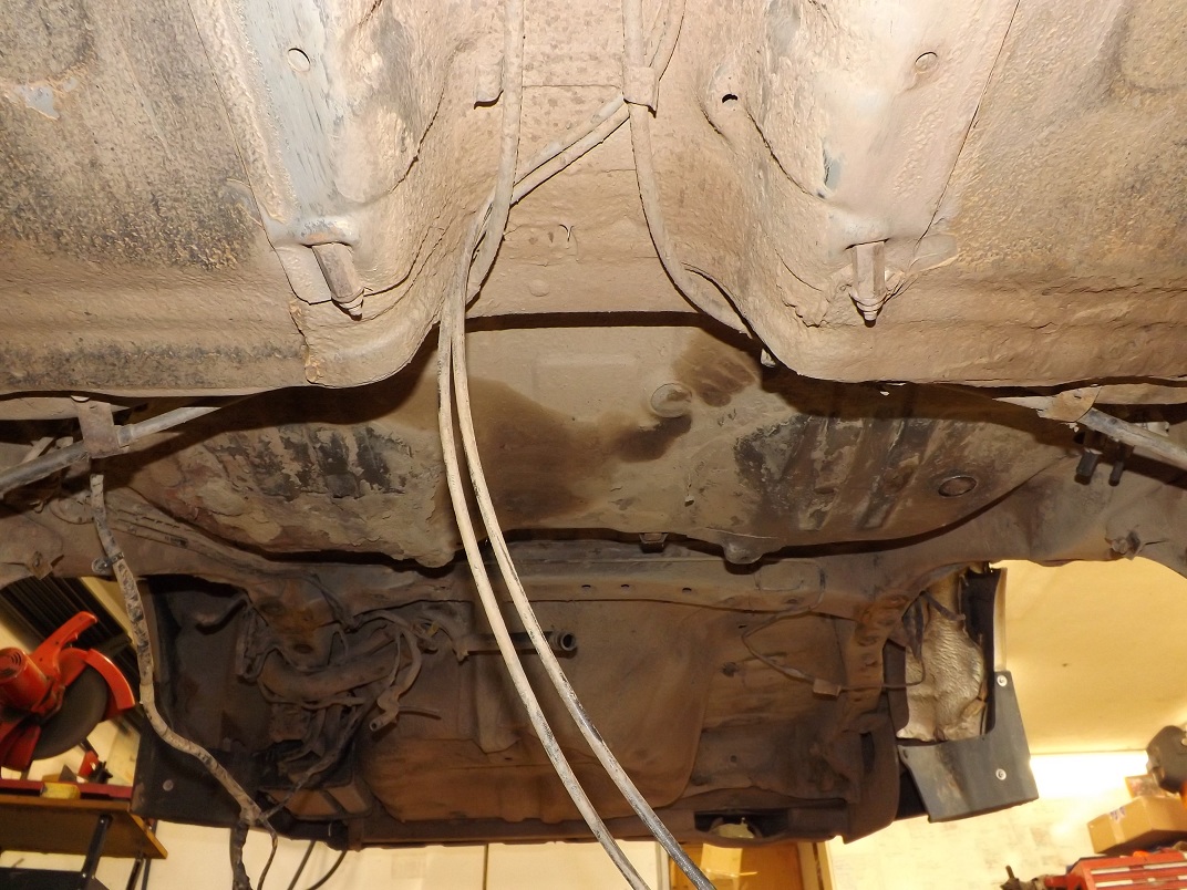

This is what the underside of a Subaru Outback looks like mostly stock for reference:

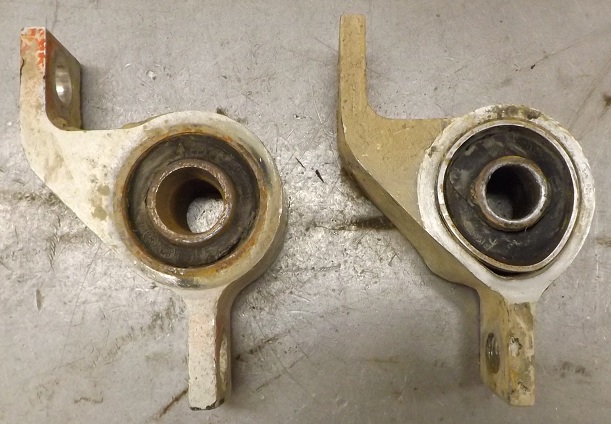

We did find a couple of things upon disassembly.  One was that one of the weights on the front of the subframe was gone and the other one was about to fall off:
Those are some kind of tuned mass dampers, right?

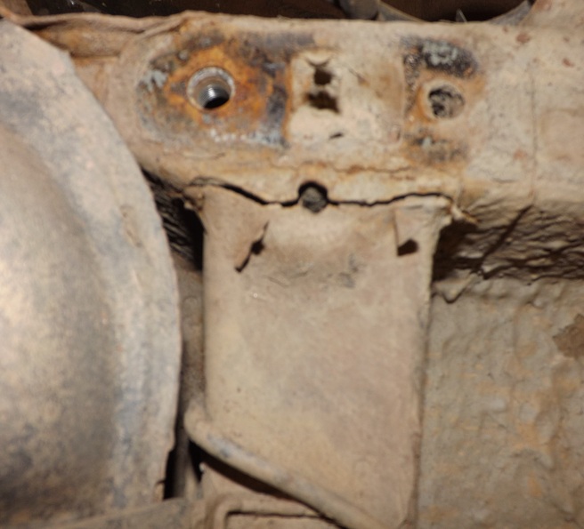

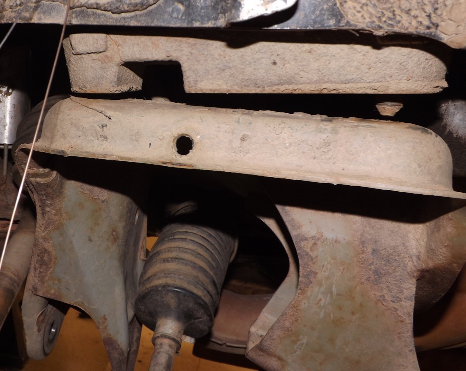

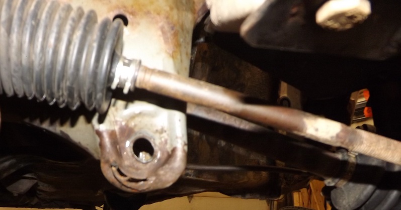

There were also cracks at the bottom of the stamped crossmember on the body above where the subframe bolts onto the stamped frame rails.  These appeared to be mainly due to corrosion.  Picture is blurry but you get the idea.

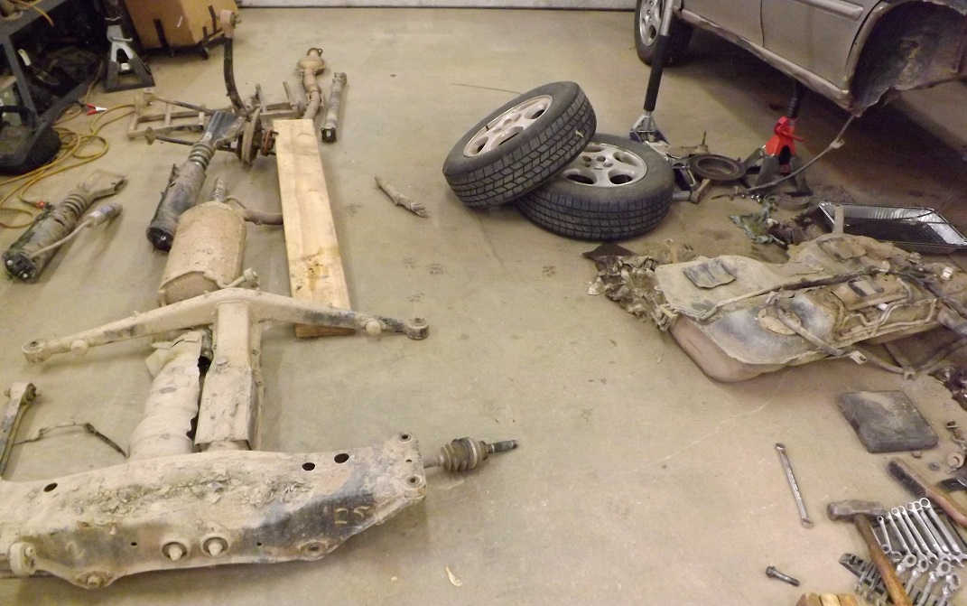

Disassembly was a lot easier than I expected.  Really only ran into a few badly rusted bolts.  Pile of parts removed:

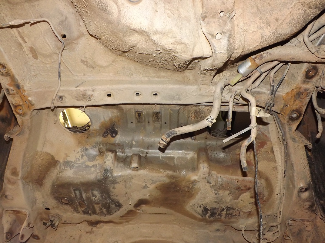

Here is our blank canvas:

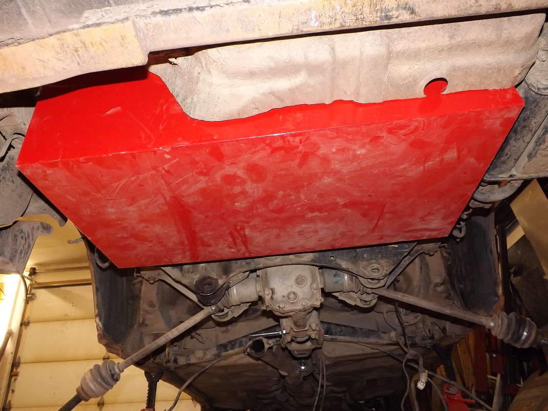

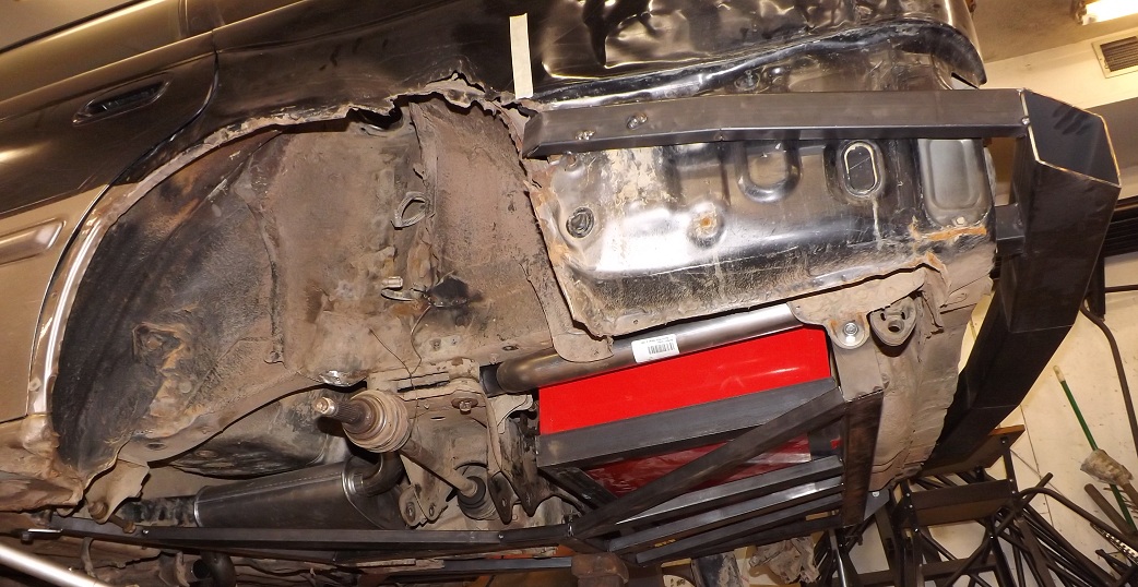

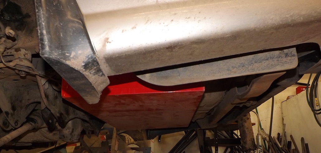

Cut a big hole where the spare tire and muffler used to be that just fits the 22 gallon fuel cell.  I have an idea for a low profile fill neck.
It hangs a little lower than the trailer hitch but it's closer to the axle.  Plan on having a frame underneath it, possibly tying into or replacing what used to be the gas tank guard, probably with a tube right behind the rear diff to protect that too.  Leaning toward removing the stock bumper and hitch and making a fabricated bumper for the rear and welding the receiver to it.
I might paint the can black so it doesn't stick out.
Unfortunately the small fuel cell I have will not fit so I have to find a different surge tank.  Any suggestions on surge tank and external pump?  Can the stock pump be used externally or will it overheat?  I thought about mounting a stock pump/pickup in the surge tank but I'm a bit concerned about the wiring.  I have seen two wire bulkhead connectors so I guess I could use one of those.
Also, can anyone find a diagram of what exactly all these vent hoses do?  There were at least three from the top of the tank to that black box and one to the front.  The manual I have doesn't explain all of them.

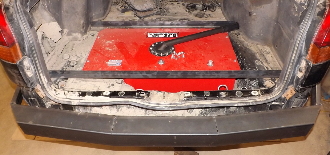

Made some progress on the back end of the car in the past few weeks.

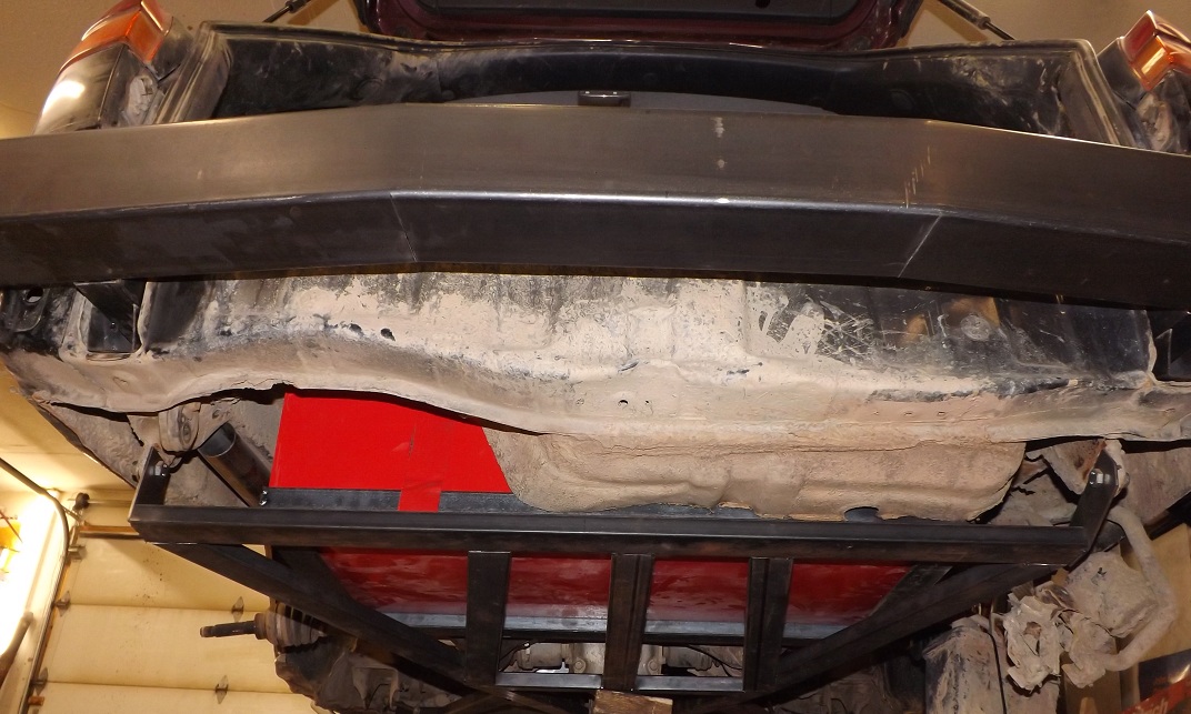

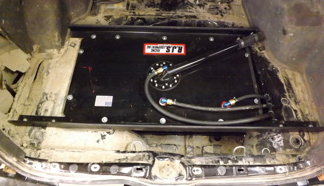

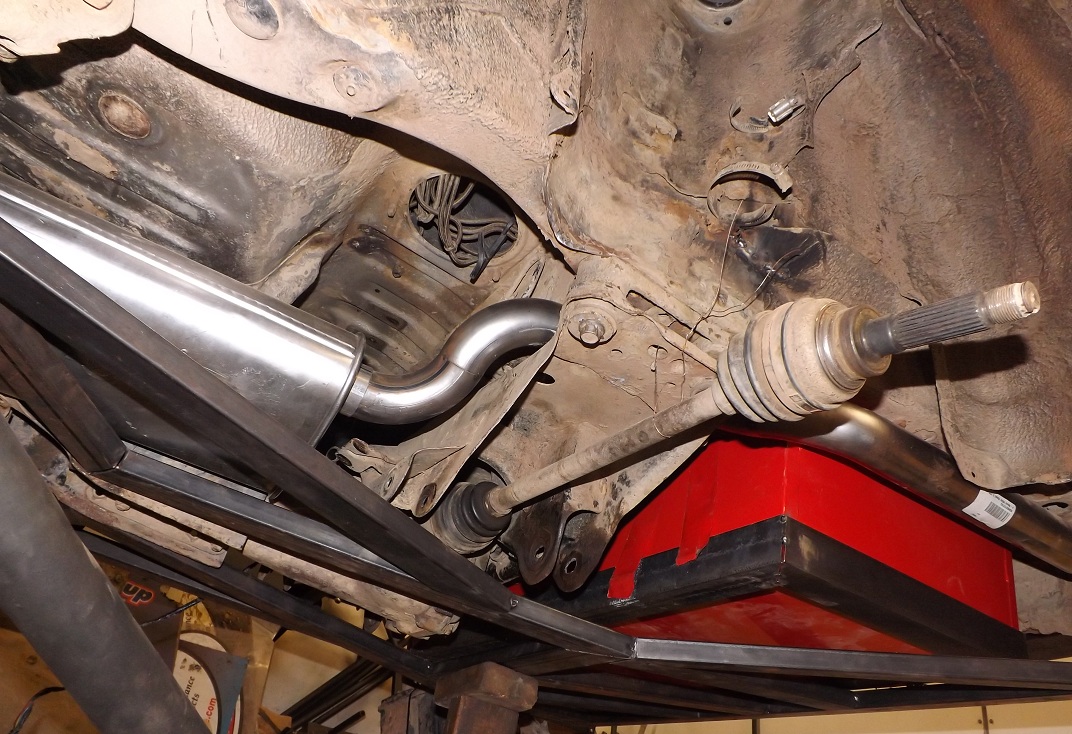

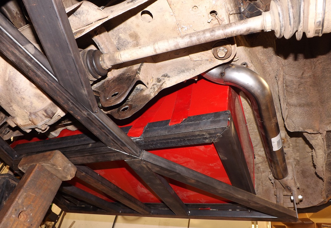

2" angle iron to support and locate the fuel cell.  Plan on at least bolting these to the floor.  Thought about welding them to the floor originally but probably won't.  Also originally planned on adding two pieces front to rear, one bolted to either side of the fuel cell, but probably won't.
Filler tube is about the same level as the angle irons.  Plan is to cut some big pieces of foam once we have the other lines in place to put the floor on.  I'll just put the stock cardboard and carpet in for now, eventually would have to make something out of sheet metal if we go desert racing.  Still have to add a return fitting, probably on the fill plate.

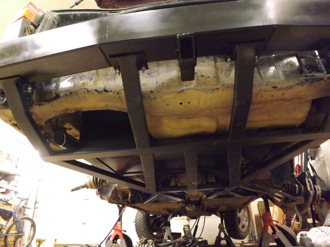

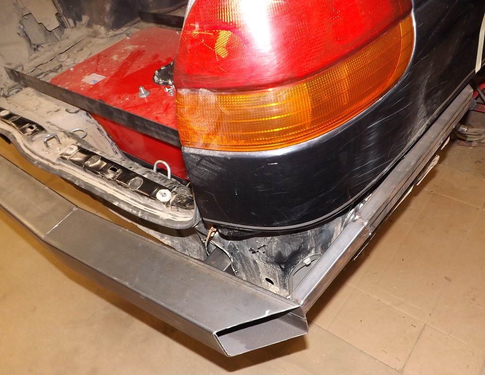

Rear bumper was easier to make than I thought it would be.  Sticks out farther than the stock steel bumper.  Easier to back up to a tree, etc without worrying about blowing out the rear glass.  Easier to throw a recovery strap around it too.
These side rails stick out a little past the rear fenders and taillights.  It's too late to keep the fenders from being dented, but at least should protect the taillights when I slide into a tree.  Stock plastic bumper cover fits over it like the front one.  Just have to add a few caps, weld, and paint that.  I'll probably gusset where the 2" square tubes (that go into the frame rails) come out and connect with the 4" tube.
Unfortunately the 3 gallon cell I had wouldn't fit so I got a 1 gallon fuel cell as a surge tank.  Mounted a Walbro 255lph pump I had from another project to it.

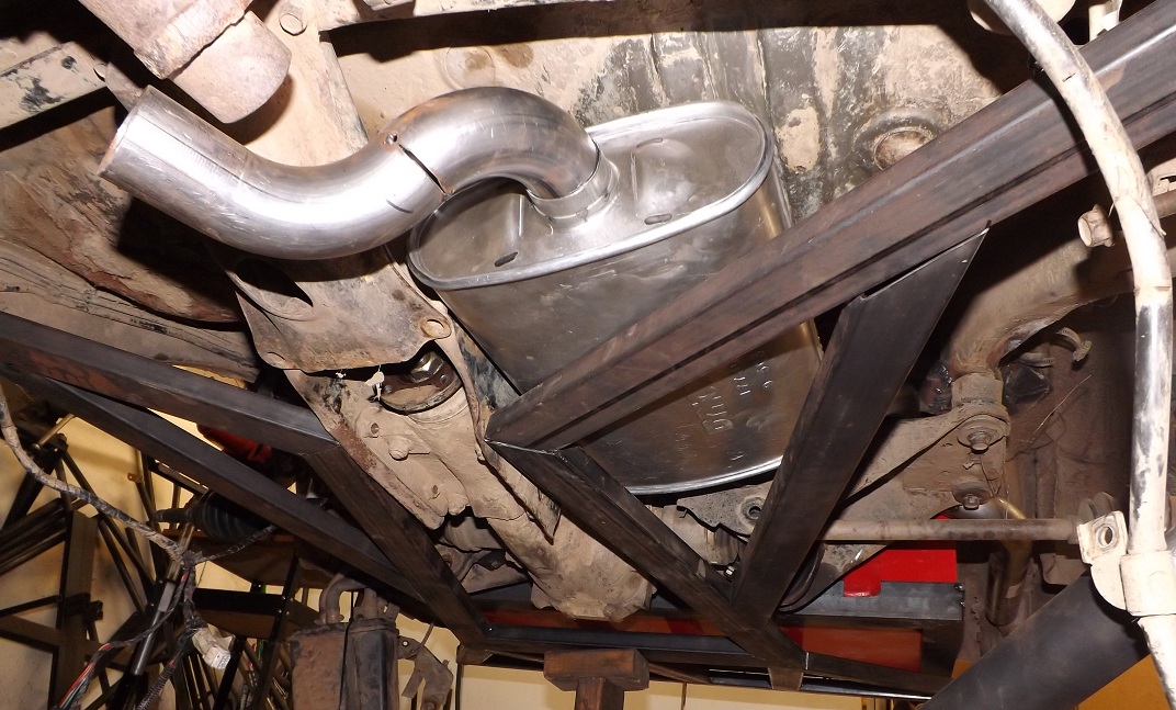

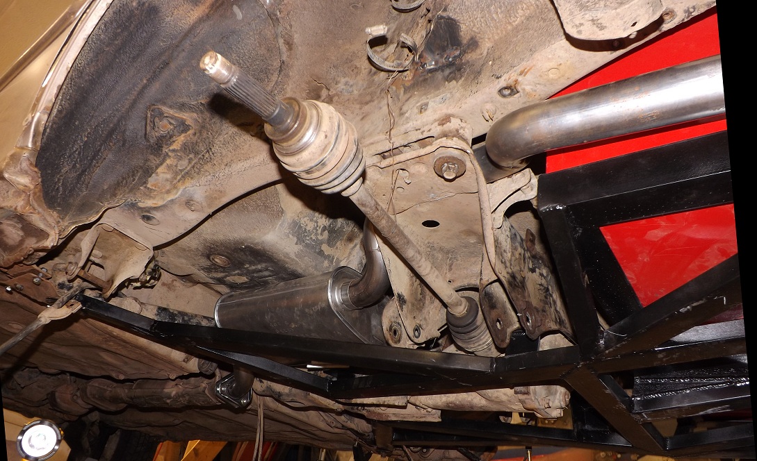

Routed the exhaust over the rear crossmember.  Plenty of room for the muffler where the gas tank used to be and not much room where the fuel cell is now.
Right now the front of the skid frame attaches to the rear subframe mounts and the rear attaches to the tow hooks.  Working on making brackets to connect the middle to the tapped holes by the lateral link mounts on the rear crossmember.  Originally had it mounted to the holes near the front of the rear diff in the picture below but got rid of those for a couple reasons.  One, we could move it up an inch or so.  Two, that normally flexes relative to the rest of the subframe so I'll probably cut the points off those mitered joints for clearance.  Probably add some tabs where those mounts are to keep this from bending up too high.
Also plan on adding some type of connection(s) from that tube behind the rear diff up to the angle iron under the fuel cell and some support in the middle of the bottom of the fuel cell.
Plan on adding a few tubes welded to that tube between the tow hooks and bolted to the rear bumper.
How should I finish the exhaust?  I thought about a downturn or side dump.  Leaning towards angling it down some but have it come short of the angled tubes I plan to add.  I've packed the stock exhaust with dirt a bunch of times when going backwards, but it sticks way behind and below the stock steel bumper.
Plan on welding a receiver to the bottom of the bumper tube.
Departure angle should be slightly better without the hitch, diff should be more protected from backing into things, and lateral link mounts are much better protected.
Anybody have a diagram of how all the fuel tank vent hoses connect to the carbon canister, etc?
I dont have a diagram for the eval hoses but I will say that on my 98 I just ditched that charcoal canister but left all the sensors and solenoids pluged in and have never goten any codes. I got rid of it because I figured I would just smash it hanging back there

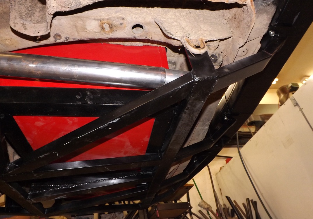

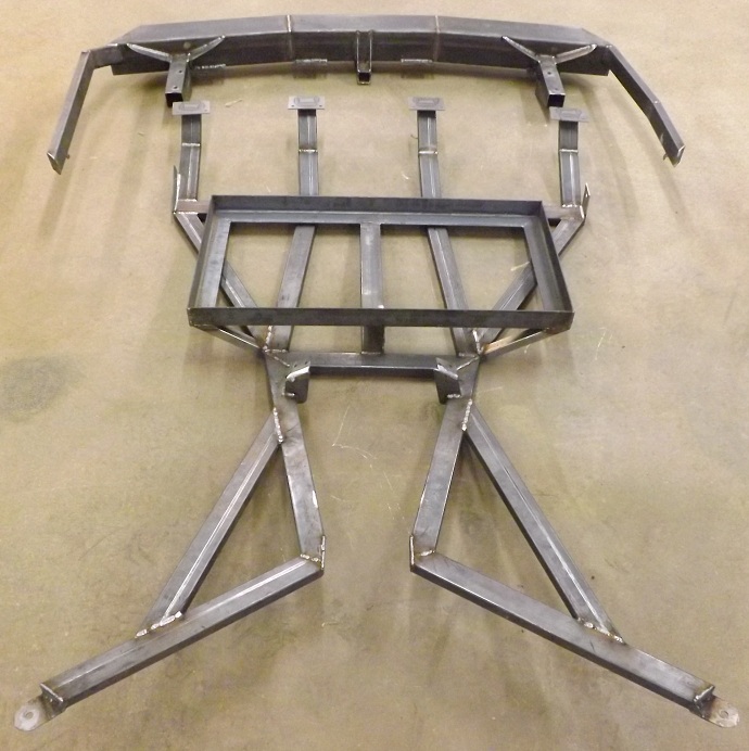

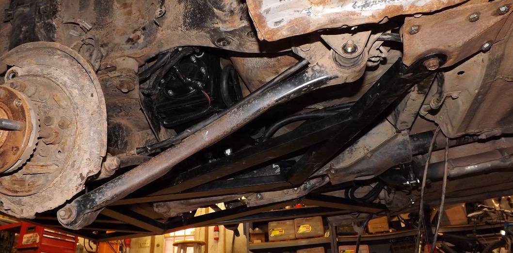

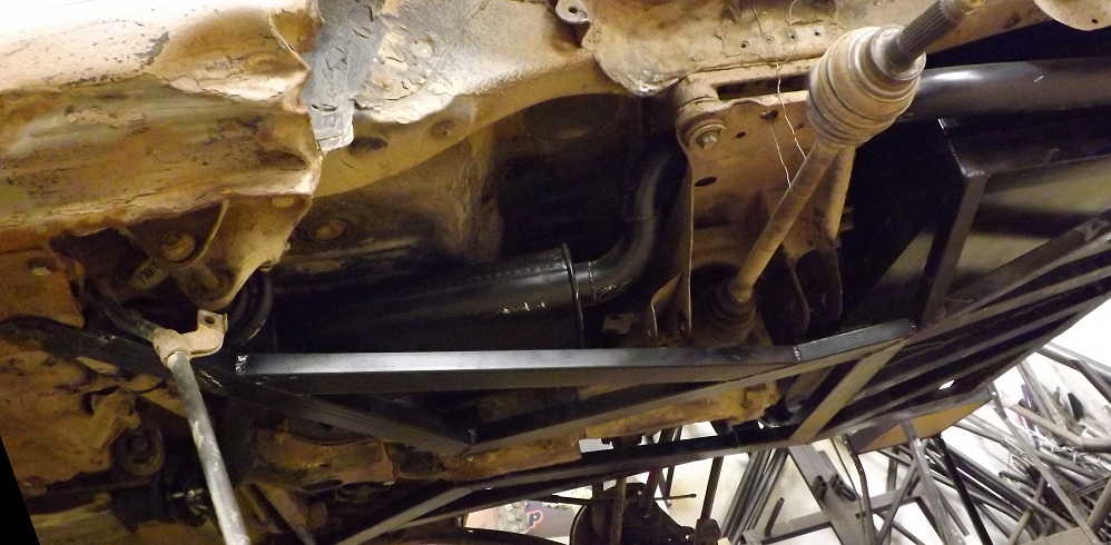

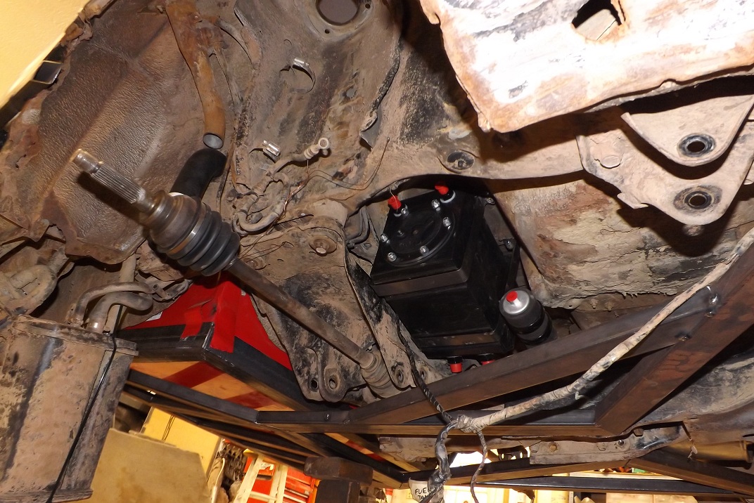

Finally have the fuel cell support / diff protection and rear bumper welded, just needs paint.
Most other aspects of the fuel system and exhaust are figured out now and mostly done.  Should have shocks next week so I can make the front struts and get this thing back on the road (and off).
  • 2 weeks later...

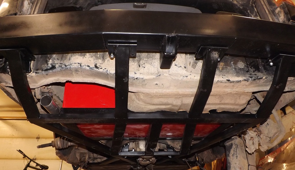

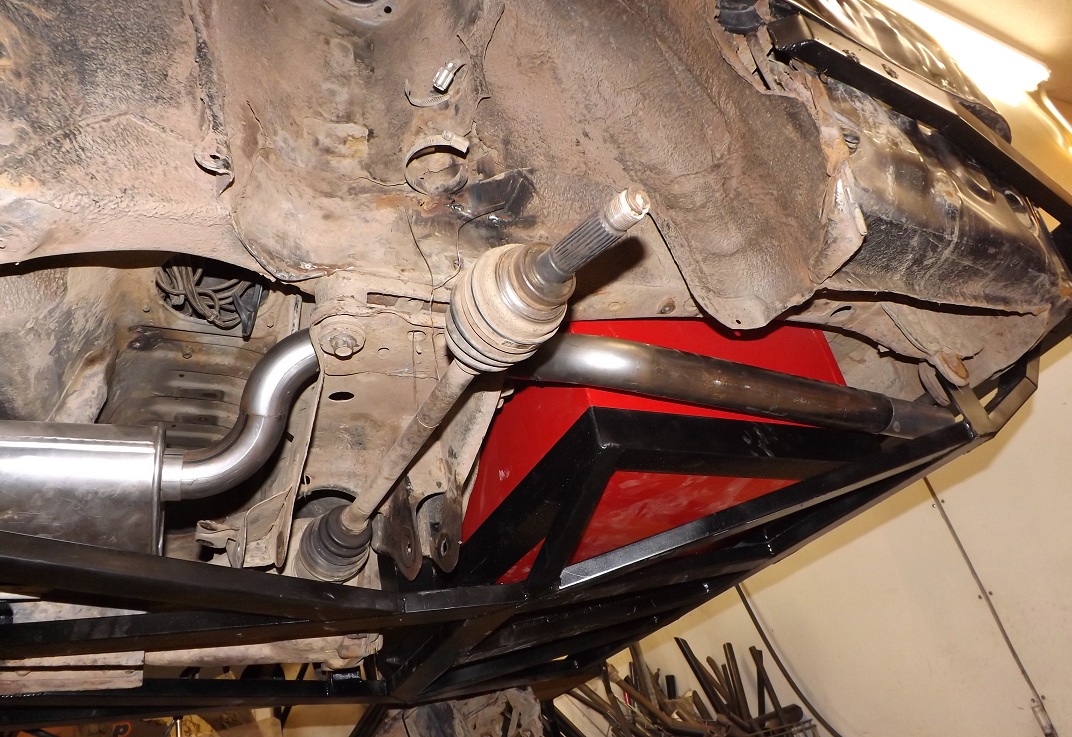

The bottom frame is painted and loosely bolted in.  I should have welded it as much as I could while it was in the car.  I had it tack welded pretty well and did all the welding off the car and it distorted a bit.  The exhaust is all tack welded now, just have to finish weld that and I plan on painting it since some of it is not aluminized.  I plan on angle cutting the outlet/tip so it's less likely to get packed full of dirt when backing up.
In the picture below you can sort of see the little brackets that mount the middle of this frame to the bottom of the stock subframe.
Below you can see where it will bolt into the stock tie down points.  You can also kind of see the support running across the middle of the fuel cell.
In the last picture you can see how this frame ties into the rear bumper.  Also welded a receiver on the bumper.  There are some gussets on the backside of the bumper not visible in this picture.
Mainly more painting and reassembly left now.

Painted the exhaust and fuel cell and got that all together and hooked up.  Fired it up a few days ago.

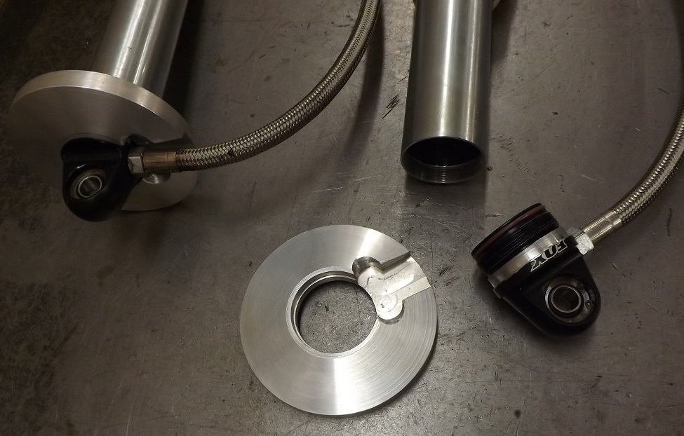

They are Fox 2.0 smooth bodied reservoir shocks.  I had to modify the shafts to attach to the bottom of the strut housings, which I made from scratch.  You might want to wait until we've put some more miles on them, but I would definitely be willing to build you a set.

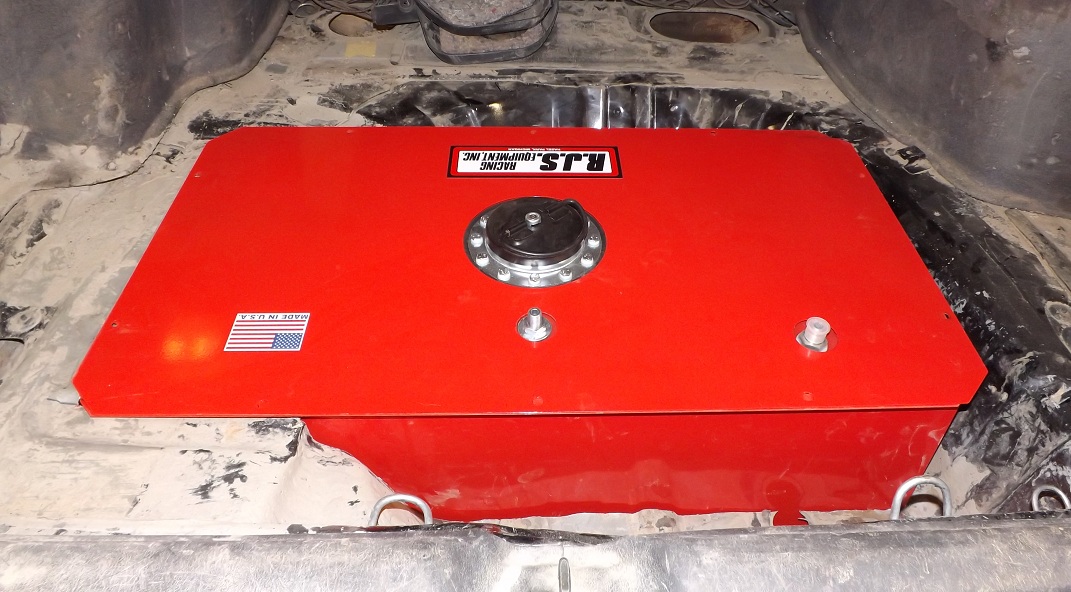

So I forgot to post this picture, this is what the fuel cell looks like from inside the car.

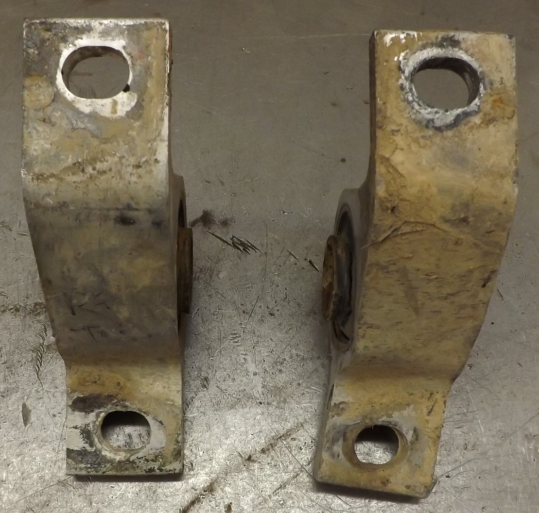

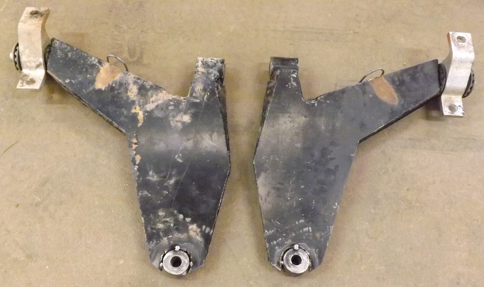

One of the things I had to do was change the angle of the lower balljoint on the lower arm and shorten it a little since the struts have less camber change than the a-arms.  It was binding near full compression before I did this.
Another reason to ditch the a-arms.  I think the subframe bolts were starting to bend a little, and this spacer is definitely cracked (upper left).  Not going anywhere, but probably not a good sign.

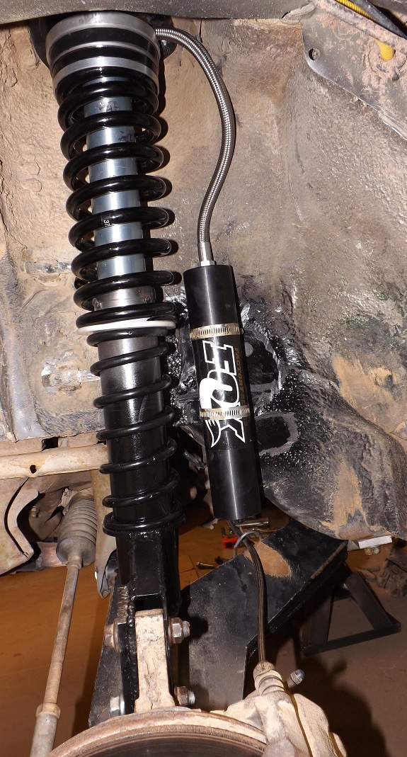

Welded in new reservoir mounts.  The strut swings around quite a bit when you steer since it's so far away from the spindle for tire clearance.  In this location the reservoir clears the strut, tire, and lower arm.

Here are the parts for the front welded, painted, and ready to install.
LF strut installed.
