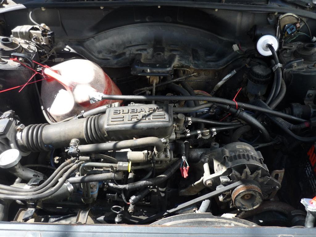

April 29, 201411 yr Author Someone mentioned that little ell hose was an issue and hard to get to, I'll check it out. I doubt that has been my problem but I might as well check every possible point of failure. I like this engine, even though it has been having trouble it still runs like a champ. Especially after I found and removed a severely kinked section of exhaust pipe after backing into some train tracks... I had it parked but then had to use it due to other vehicle issues so I took a friend's advice and put a 3 gallon gas can under the hood and ran the radiator overflow into it. I removed the thermostat again because the air pocket was not allowing it to get up to temp at the right time. Now as I drive the coolant gets pushed into the gas can but the engine doesn't overheat, and when I shut it down the excess sucks back into the engine... Not very elegant but seems to be effective! At least for now.

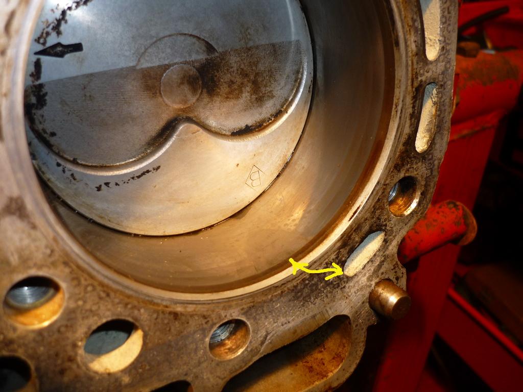

January 3, 201511 yr Author I'm hoping to bring this topic back up and maybe get some advice.. The car sat for quite a while after rigging it to run just enough to get done with school last may and after that my driving needs diminished. I pulled the engine and removed the heads to find that the culprit was indeed a blown head gasket pushing combustion gas from one cylinder into the cooling system. There is some very minor corrosion from coolant entering the cylinder but I'm not sure if it is really bad enough to matter. See attached photo. There is some white buildup in all the coolant journals but doesn't seem too bad either. I cleaned and inspected the warpage on one head, and I could fit a .008 feeler gage under the straight edge between the combustion chambers. The manual says the tolerance is .005. I'll measure some more with a better straight edge to confirm. I see no evidence of leaking between cylinders though I do remember somewhat lower compression on one side of the engine so maybe they were. The heads are cracked between the valve seats but I've noticed that is common. so I have a few questions: is the head warpage enough to warrant having them shaved or using different heads? I have three other engines of somewhat known condition that I could try to use heads from. what is a good way to remove the gasket material? It's hard not to gouge the surface trying to remove the stuck gasket chunks and there is a black residue that sort of comes off with sandpaper but I don't like using it on machined aluminum surfaces. I have the head gasket kit but don't want to just slap it back together and have problems I could maybe have avoided. The engine ran surprisingly well despite all the issues, was run hot a few times but never really overheated. so if the only major problem was the head gasket in one spot, is it a terrible idea to just clean and reinstall? Or is the head warpage really an issue. Thanks
January 3, 201511 yr Like naru said....it's .05mm limit .008 is closer to .10mm But the head can be ground .3mm so you should be able to surface those and use them. Standard height is 90.6mm so you can take them to 90.3mm. They'd have to be cut several times to get to the limit.
January 3, 201511 yr Author Thanks, I certainly misread the manual. I'll measure the height to see if they've been shaved before and I guess start pulling heads off the other engines to see their condition, or maybe drop a whole motor in for the time being and save the gasket kit for a later time... I suppose I should be checking the block for cracks and warpage as well. Once you start machining surfaces are there any issues that will arise from the removed material? I know on engines with a timing chain this can be an issue, or the combustion chambers shrinking or other stuff.
January 3, 201511 yr Not issues if you stay within the machining limit,but,you will get a slight compression ratio increase and slightly retard the valve timing.
