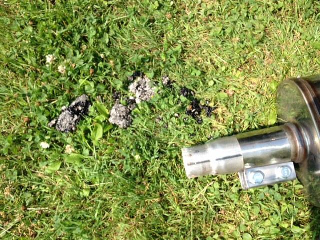

Well I tried the clamps. Got them as tight as I could. After driving around all day, it seemed to fare well. Sounded amazing. As I turned up the road I live on, I could tell it came disconnected and I was suddenly running straight pipes. (Luckily) As I turned into my driveway, the muffler fell off and pole vauled the a$$ end of my car clean off the ground.
So... Its at my neighbors, waiting to be welded.

Thats exactly what happened. I cut as close to the muffler as my sawzall would let me.
It wasnt funny when it happened, but now I cant help but laugh every time I see the giant divot in the road...
Glad I didnt go for a cheap fart can, that would have crumpled like paper. The Magnaflow has a small dent in the tip, thats it. Left some dents and scrapes under my car, nothing serious. Glad I can reuse the muffler. Conversation piece haha
ha ha ha ha ha...really, it pushed the rear of the car up?!? wow.

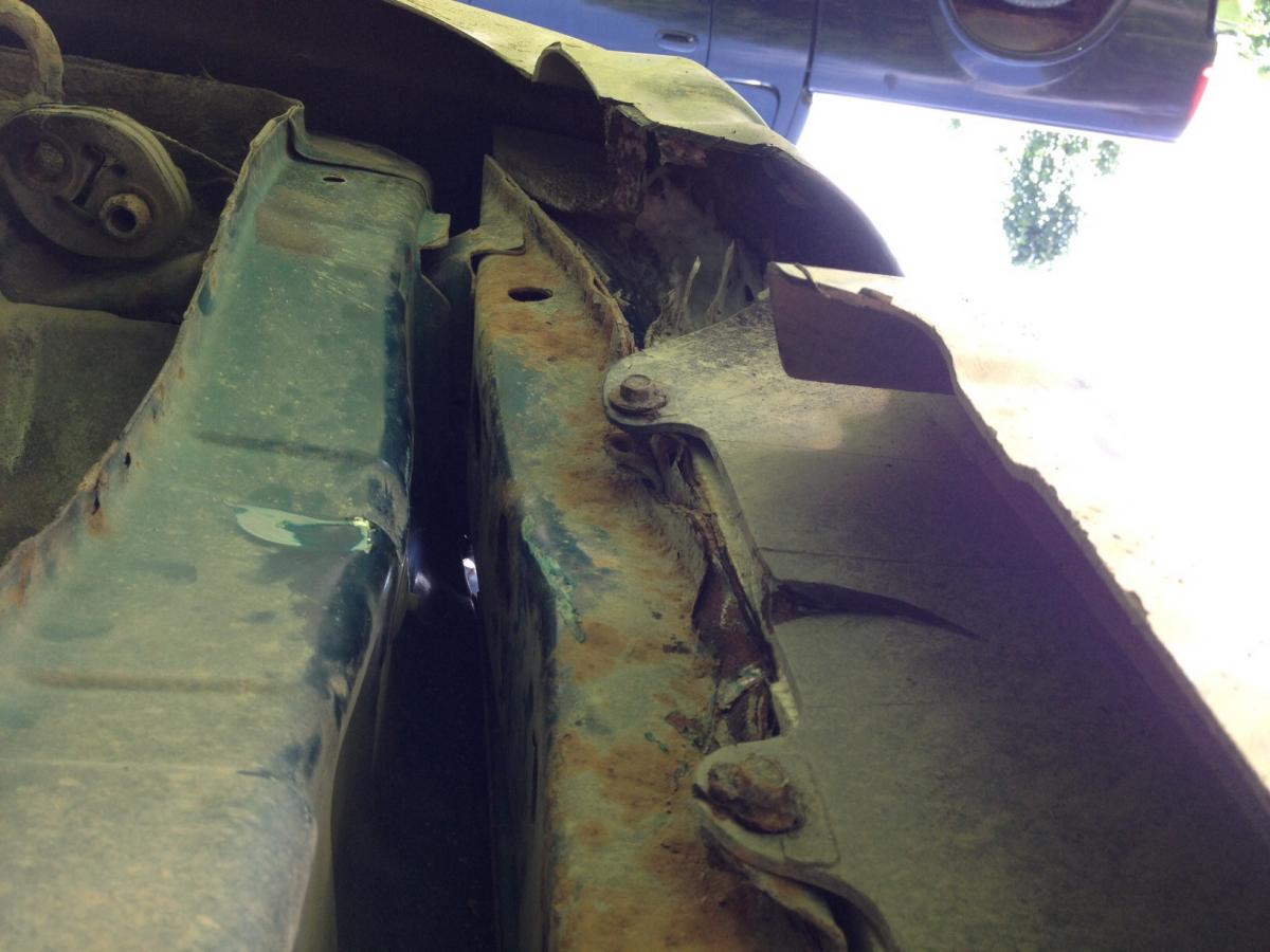

Yeah. Dug the muffler about 3 inches into the road. The tip hit the rear crash bar and lifted me right up. Surprisingly not damaged too bad. I had to use a screwdriver to get the road out of my muffler...

So to answer my own question,
NO, you cannot do your own aftermarket muffler without welding. At least on this car. And at least if you want it to stay on for more than a day.

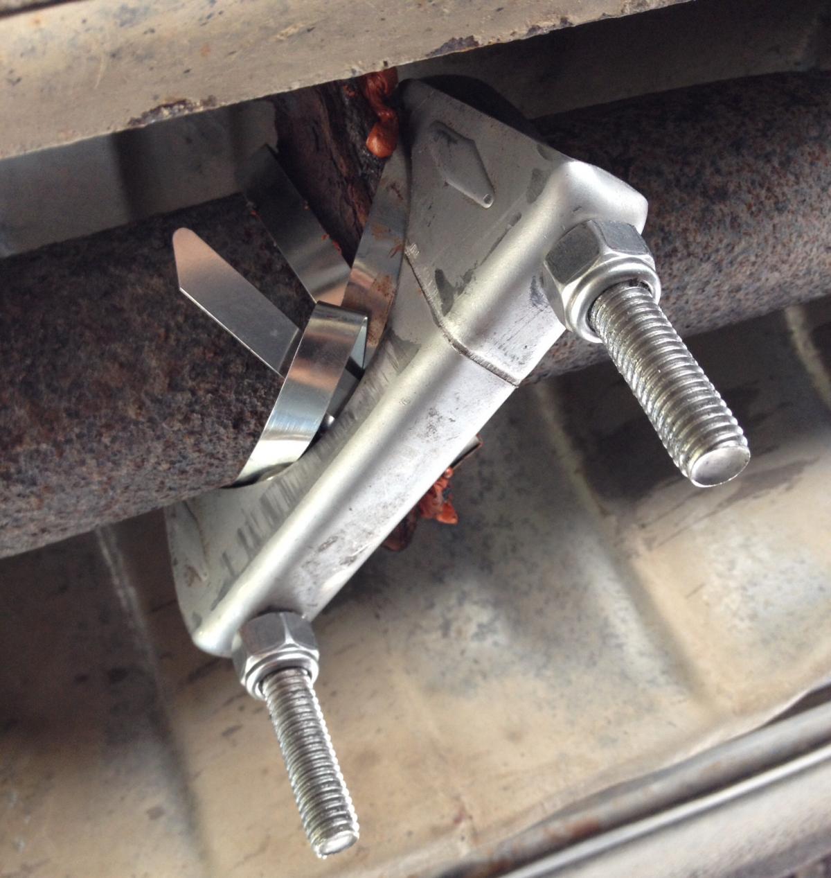

Over the years, I have done my share of red neck custom exhaust work and repairs. IMO, I think it is possible to attach the muffler to the pipe with muffler clamps without welding. I looked at your photo to gather some thoughts. I would recommend installing a pipe hanger at the junction of the pipe and muffler, as help is needed to support the pipe & muffler weight, and also to keep the pipe and muffler from flexing at the connection, where by it could work itself loose. I suggest using 2 muffler clamps,  if there is enough room, where the pipes join to gain more clamping strength. Attach the hanging strap to one of  the muffler clamp You may need to drill a hole in the under side of the body to attach the end of the hanging strap. Be sure to use a rubber insulator on the hanger, or else the exhaust vibration from the exhaust system will get transmitted to the car body, and be felt everywhere inside the car.

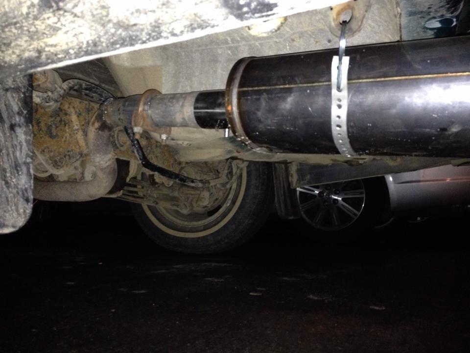

Its hard to tell from the picture, but there are actually 2 clamps where you seggested already. I thought about installing a hanger in the front of the muffler but the clamps are freaking tight. I made sharpie marks at every connection and check for movement. One of my jobs is (on a good day) 30 minutes away (I live in the middle of nowhere) and after driving to and from there hasnt been any movement. When my two jobs give me a chace Ill improvise another hanger there. Still paranoid about it falling lol...

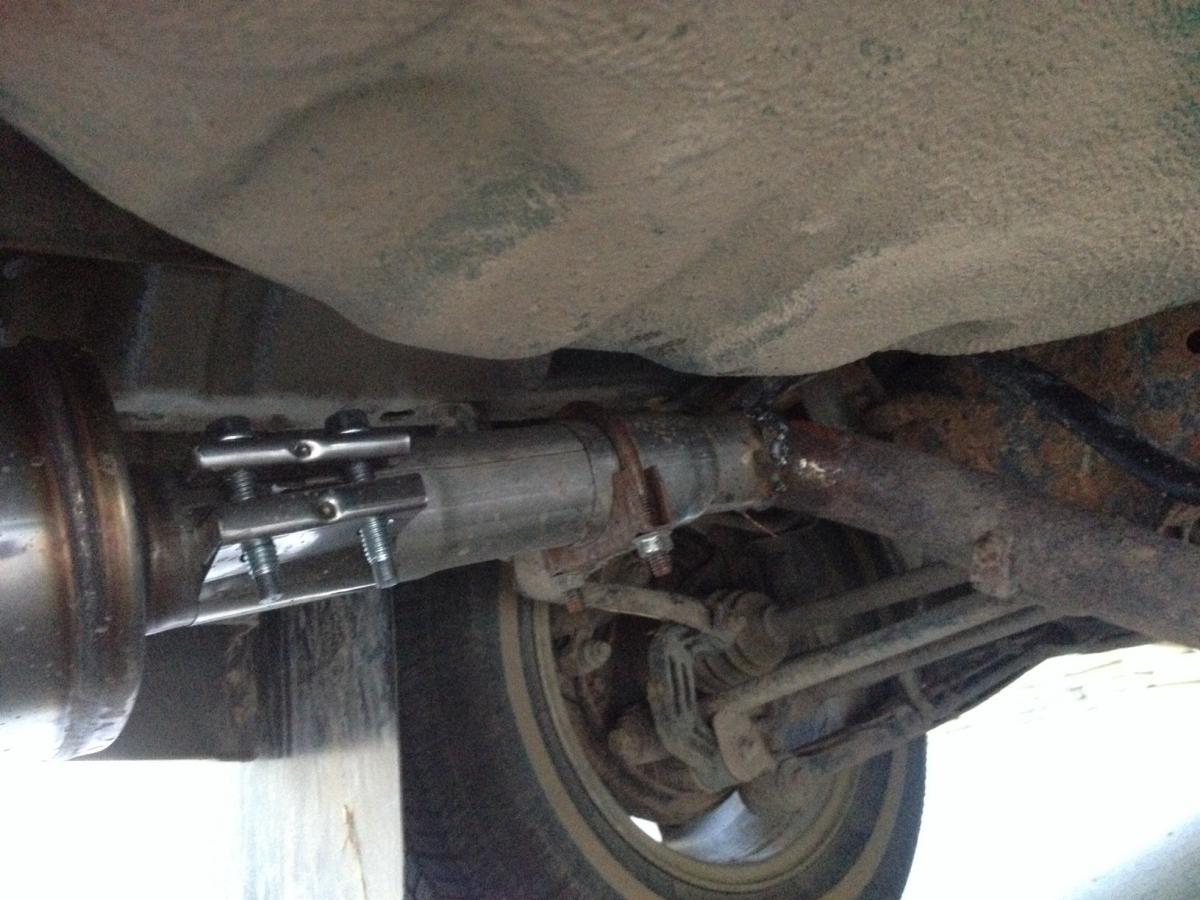

Heres a better pic of the connections

Yea, now I see what you have done with a second clamp. IMO, if you added a hanger before the muffler, you would not have to worry about the muffler falling down, even if the pipes disconnected, the hanger would hold up the muffler to prevent it from dragging on the pavement. It looks like you are using a pipe size adapter to mate a different size pipe to the inlet of the muffler. IMO, I would consider adding another muffler clamp, as insurance to tighten up the pipe joint. Clamps are cheap, so what the heck. Since you live in NY state, expect salt rust to attack the pipe, especially the pipe adapter. Sounds crazy, but some rust will help tighten up the pipe connections as well.

Another thought, in the past with this type of work, I have used anti-seize compound on surfaces, where I slid one pipe inside another. The anti-seize acts as a lubricant to slide the pipes together for a smooth fit, and also years later, it helps in pulling the pipes apart for any future work.

Turns out that after adjusting my custom super high-dollar fully adjustable hanger, the redneck repair on the axleback-midpipe connection (surprisingly) failed. Looks like either the RTV silicone split or what's left of the gasket split again, so that video might be a few hours. Lol it's like a Rube Goldberg of fail under here...
Believe it or not, this worked well. However there was a lot of stress put on it during fabrication to be less of an angle on the axleback for mounting the muffler.
