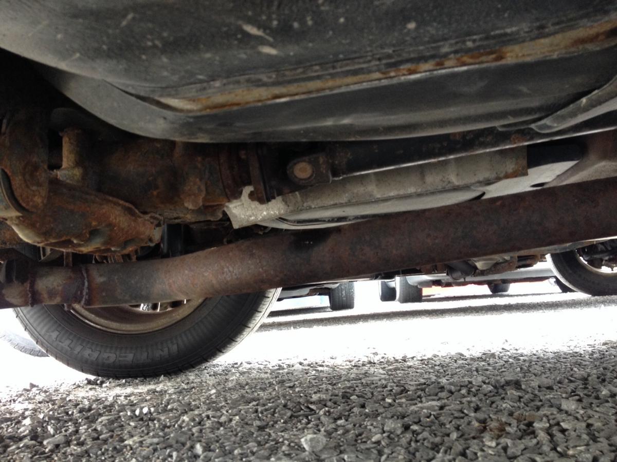

The 'Rust-Free'-
turned out to be very well concealed bondo and proper application of the correct shade of burgundy metallic paint. The cancer has started to spread, you can tell by running your fingers under the fender.

As a frequent sufferer of rust belt cars, that is not a "no rust" car. I'd give that rear crossmember another 2 years in that environment. Total surface rust is one thing, nasty scale at the edges and seams is another.
Good call on walking. This guy bought it at auction, maybe pad slapped it and just threw it on the lot. ANYTHING out of a third tier (or any dealer for that matter) dealer's mouth is either bullshit or omitting knowledge.

So... That rear crossmember, eh? *looks under 97* welp...
