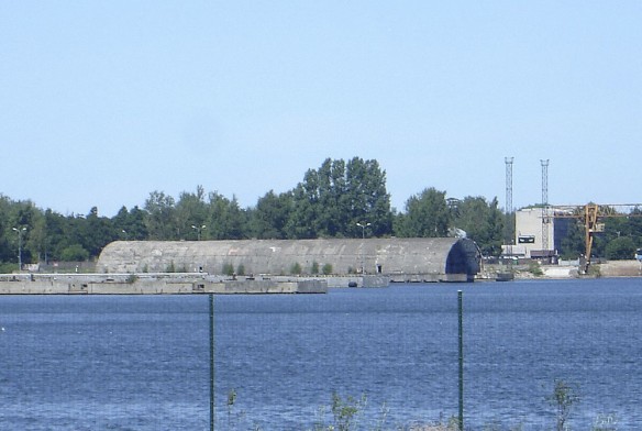

it has some left submarine garage , cant visit there
letland2juli2008116www.jpg&w=584
