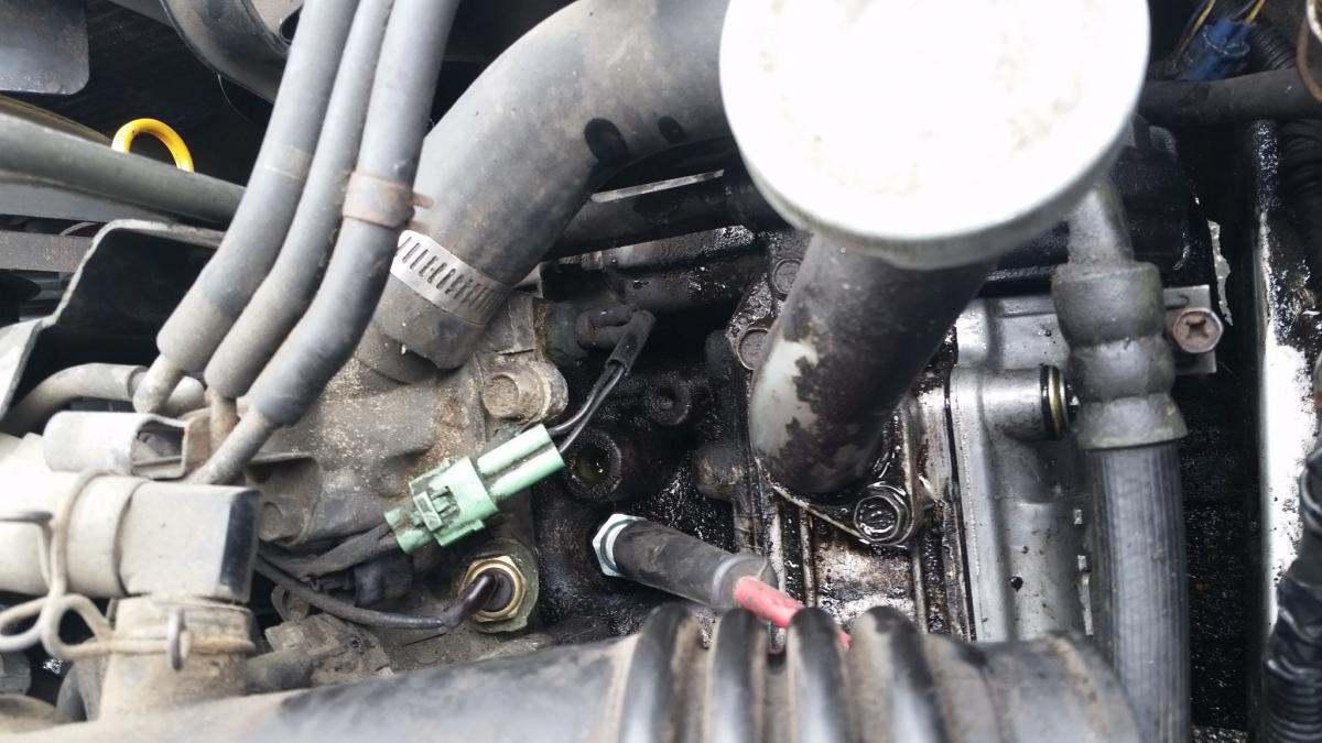

May 31, 20169 yr Hi everyone, I recently picked up a 94 loyale with a few problems. Today I was replacing the valve cover gasket and decided to check my spark plugs for oil. I unexpectedly found some coolant on my spark plug (upper passenger side). I also realized that I was empty on coolant. I don't know where the leak is coming from, but I do have some clues. Hopefully you guys can help me out. I took some pictures but didn't realize that they are oversized for this forum so I'm going to retake them in about 30 minutes when I get home. Best description I can give for now is that there is puddle of coolant 12 and 3 o'clock from the upper passenger side spark plug, as well as what looks like a bolt hole beside it (is there supposed to be something in there?). Pics will be up soon. Thanks in advance!
May 31, 20169 yr You could be missing a head bolt. If there's coolant on the plugs it could indicate a blown head gasket. How does it run? can't be good for the ol' air fuel mixture if coolant is getting into the cylinder like that Edited May 31, 20169 yr by thesmith
May 31, 20169 yr Should becoming from the intake manifold at the where it meet the cylinder head and or that little boochy bobber copper colored elbow ... mine blew the intake manifold gasket there and rolled back into the number 4 cylinder... I think that hole is for when we lift the motor out? My spark plug looked like it came from an aquarium, so I know exactally what your talking about lol ! and yeah for some reason I too am running into the oversized image problem

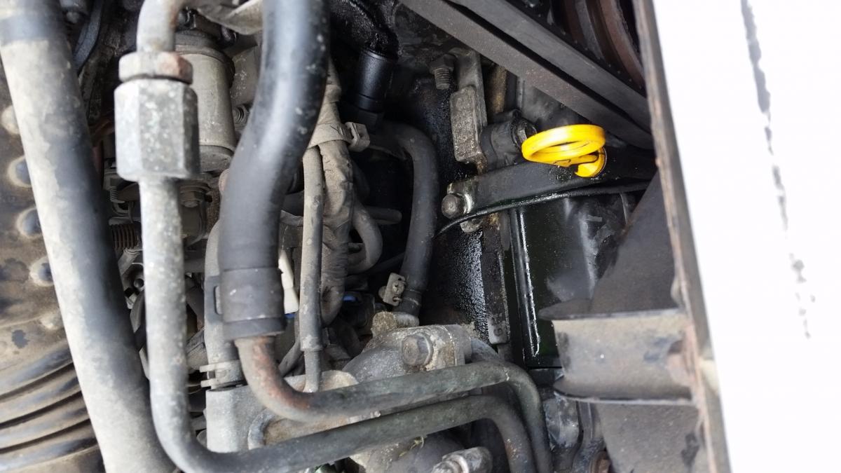

June 1, 20169 yr Author Thanks for the quick replies! Ok so the hole with the coolant actually has no threads so it's not for a bolt. You can see it in the second picture. Though there is another empty hole with threads to the right of it. And there is coolant near the lower passenger side spark plug (pic 2), but none managed to get in. There was only coolant (not too much) in the upper plug (pic 1). In pic 2 you can see that there is some dried coolant around the bolts on both sides of the green.. thing. I'm mechanically handicapped, so can you guys tell me how to diagnose a blown head gasket? And could you explain what/where the copper elbow is? I'm not sure what the intake manifold or cylinder head is, but I have a repair manual that can help me figure it out. Do you guys have any suggestions on how to find out where the leak is coming for sure? I think the car runs fine. It seems a little slow, but I thought that's normal for this model. It doesn't accelerate fast and generally tops at 80mph (please tell me thats normal). I've noticed the temperature get high (but not in the red) only twice now, but it quickly cooled off and it was caused by low oil levels. The car sounds pretty loud, but that's normal too from what I've read. I'm not sure what to be looking/hearing for when I drive. I think I went in a bit over my head buying this car and am now regretting it.

June 1, 20169 yr Well, welcome to the forum. First things first. On the front of your intake manifold is 2 small hoses, their about 1/4" ID. theres one that runs from your thermostat over to the block, when it cracks or leaks it can spray it coolant all over that side of the engine. Next rinse the engine off. If your using the green antifreeze it will glow yellowish green under a black light, (hint, hint). Ed
June 2, 20169 yr Author Thanks Uncle Ed! One of the small hoses is leaking coolant. Thank God it wasn't something worse. I went to a few places but they didn't have that hose in stock so I was wondering if you guys could tell me what the name is for that part so I can order it online. I attached a picture for reference (small bent hose with Phillips clamp).

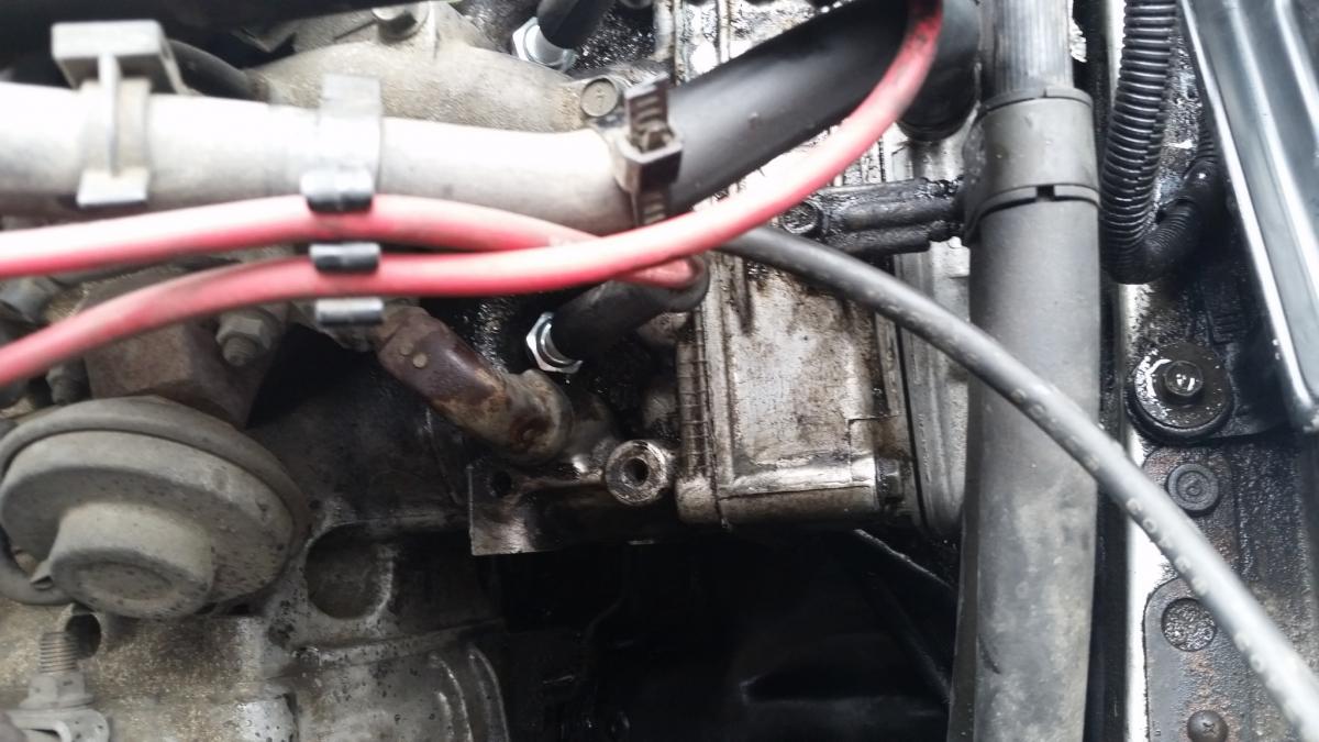

September 17, 20178 yr Hey guys! Bringing up an old thread here. Same problem, though I don't see where the coolant is coming from, and it's only intermittent leaking. Both passenger side spark plugs are covered in a little green lake of goodness, and it's pretty thick like it's been there a while. Seeing the oil deposits everywhere, I think it's probably a head gasket leaking externally. I don't see milky oil, there is a little whitish exhaust sometimes, especially when cold out. On longer drives, I can smell the burned antifreeze when I exit the car, and there is sometimes antifreeze steam -- again, on colder days and longer drives it's more evident. I can't find the source of this antifreeze. See pics below. What do you guys think? Edited September 17, 20178 yr by Tony Cortado
September 17, 20178 yr There are a total of 7 hoses involved with the cooling system. A few of them can leak on top of the block. Unless you know they are new, replace all of them. Be sure to clean the nipples , they typically have rust and won't seal. I have found that plumber's silicon grease makes later disassembly much easier. Once the new hoses are on, and you have followed the procedure to remove most of the air, watch the coolant level closely. You may have an intake gasket leak - those can go either into the intake or out onto the block. Head gaskets can develop seeps to the outside. I have usually seen this after an overheat while low on coolant. This also can lead to blown head gaskets. Smelling hot coolant usually means a small leak where it hits something hot. Intake leak has to get very bad before smoke gets obvious. Coolant in the oil doesn't usually happen until the head gaskets are VERY well blown.
September 17, 20178 yr Hey guys! Bringing up an old thread here. Same problem, though I don't see where the coolant is coming from, and it's only intermittent leaking. Both passenger side spark plugs are covered in a little green lake of goodness, and it's pretty thick like it's been there a while. Seeing the oil deposits everywhere, I think it's probably a head gasket leaking externally. I don't see milky oil, there is a little whitish exhaust sometimes, especially when cold out. On longer drives, I can smell the burned antifreeze when I exit the car, and there is sometimes antifreeze steam -- again, on colder days and longer drives it's more evident. I can't find the source of this antifreeze. See pics below. What do you guys think? this looks like leaking intake gaskets
