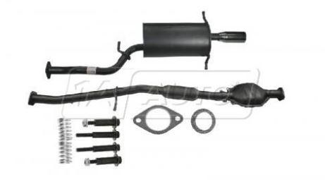

And one other issue I would like to address, since I am here.  Earlier today, I replaced the resonator pipe and the muffler.  bought the package from ebay.  they totally shipped wrong parts to me.  what a disappointment.  The whole package is suppose to be black, but instead, they sent the silver muffler.  And when I put them together, the two wouldn't not align.  They are twisted at least 1 and 1/2 inches from each other.  And they said it fits many 1996-1997 subarus: outback, impreza, legacy.  ... And then I noticed, there are condensation dripping out of the connection between the resonator pipe and the Catalytic pipe.  Is it just because it wasn't tight enough?  But I have screwed completely as far as I can screw (up to the smooth part of the bolt, where the spring would be).
As of right now, my outback is in the garage with no muffler. .... :'(

Maybe the exhaust seal that goes between those flanges isn't thick enough?  Aftermarket exhausts can be iffy alignment wise, and all.  Is it a known good reputation system, or el cheapo ebay special?

I doubt the exhaust you bought is universal to fit all those models. Pretty much '95-'99 Legacy Wagon and sedan are probably compatible, but not w/an Impreza.
Attached is a from a '97 Legacy Outback - fits both the 2.2 and 2.5. There should be  'donut' gasket that seals where the spring connection is used. If it's not fitting correctly it'll leak.

wtdash, yeah, I bought my exhaust kit from 1A too. It's similar to the one you posted, but mine had only one resonator bulb on the pipe. And the hanger bar just pointed straight out, unlike my old one. It was a weird pipe they sent me. I should have gotten the one you posted. But the problem was they sent me a silver muffler, and the muffler was just a cylinder instead of the bigger oval shaped one, like the one they had on their image. And the two would not connect at all if everything is set properly. Now, I had to compile proofs of part numbers, and images, and information to sent them. It just takes a lot of time going back and forth when I really need the car as soon as possible. ...

Right now, I have put back the old exhaust, and had to improvise with metal fittings to fit them back together. .... most of the old one eventually became one long continuous pipe with flexible fittings to connect them. -_-   Also, when my resonator pipe broke at the connection where it joins with the catalytic pipe, I just put a metal fitting over the pipe, and the other end into the resonator.   Could exhaust back pressure cause the CEL too, if there is such a thing?  Can exhaust ever go back into the engine if there is any place that gets narrowed by the catalytic pipe?  Just curious.
