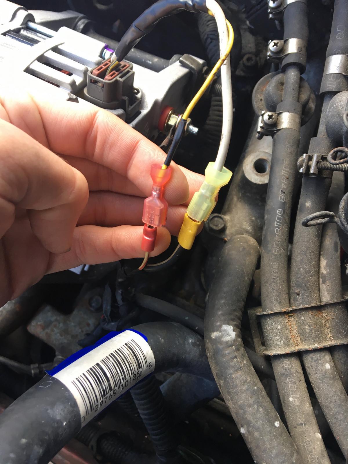

sorry the picture isn't very detailed. this is how I've wired up the new alt plug for the Nissan alt in the 88 GL.  as you can see in the background the thick white wire is connected to the BAT spot on the back of the alt which runs to to POSITIVE side of the battery where it was hooked up to the old alt and old side of the battery.  This alt has a radio silencer on it, but other than that that's it for wiring. the BAT connection and the Plug. that's all there was on the old alt.....am I missing something here?
There are 2 thin wires in a plug on a stock alternator. There is a convertion on for the swap also. They need to be there.

The two wires from the original plug are the white w/ red stripe and the black w/ white stripe what I connected to the new plug for the Nissan alt..... one is around 16 the other might be a 12 or something close to that. just attached them with the spades you see in the photo to the new plug from the nissan alt.....think this is wrong?
