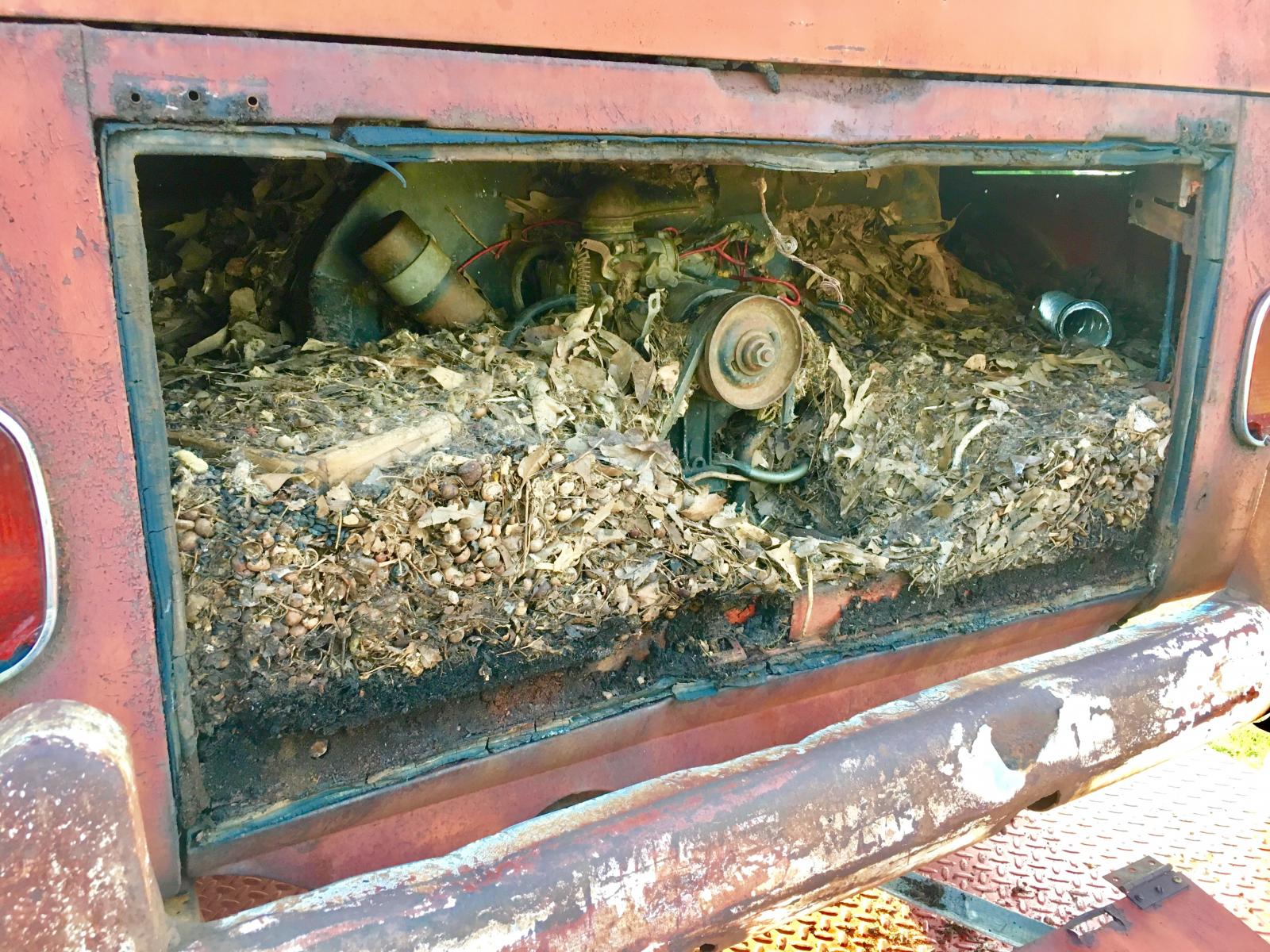

September 4, 20178 yr those arent squrals there hampsters lol thats the wheel they run on to power th3 bus the problem with this set up is if you leave the door open the hampsters can get out then your screwed lol there no fun to chase down
