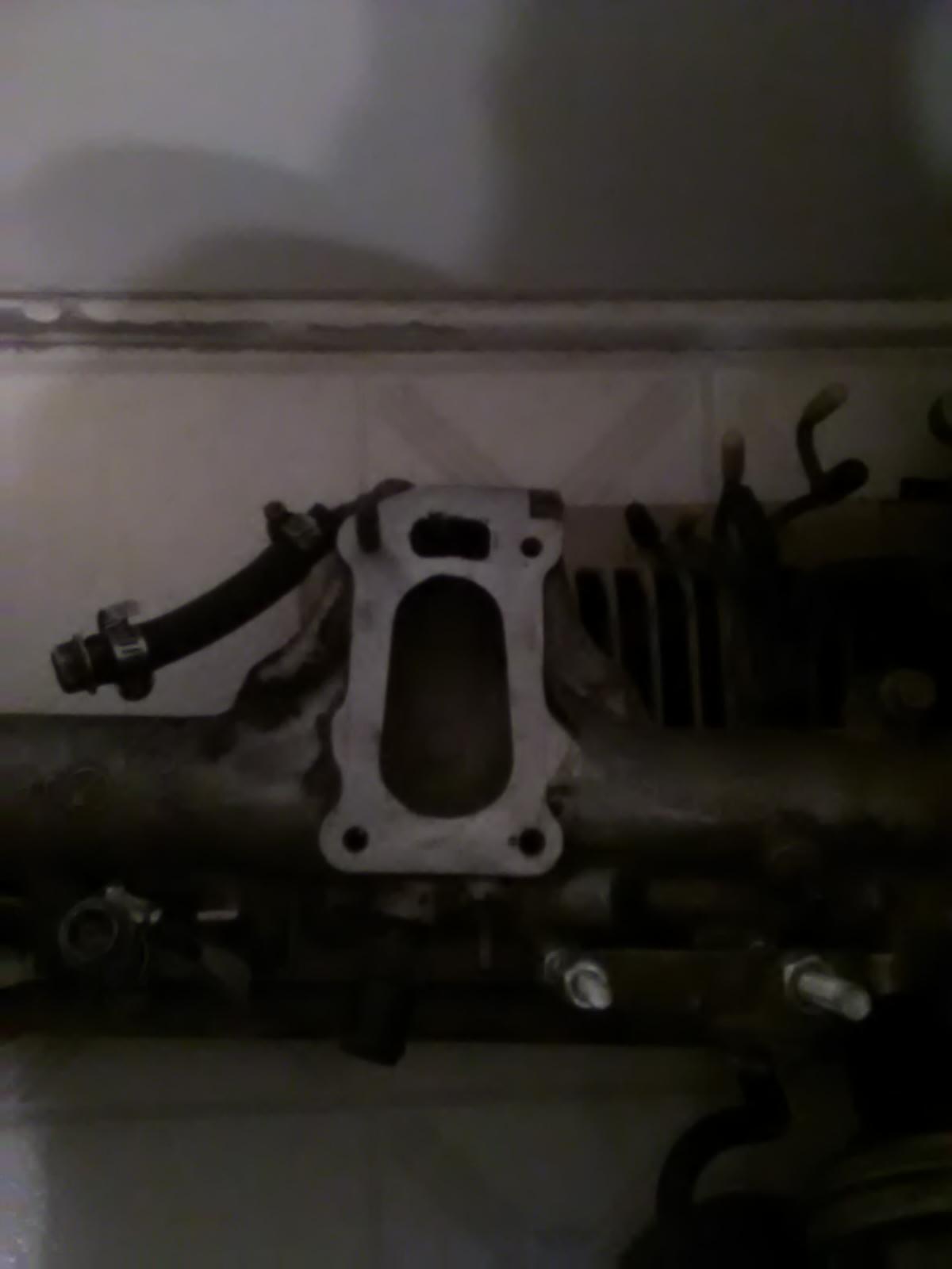

It's hard to offer advice on this type of problem without some clear photos.
The small hole at the top of the intake manifold is larger than ones I've seen at the salvage yard. The prior owner dremeled down the water pipe so there is nothing for jb weld to catch on. I'm wondering how to fill that small hole. I have been told to buy an aluminum bar stock and press it in then jb weld, but if that comes loose then it can f up the cooling system and/or ruin a head. Any suggestions that work I will try
Ok, without seeing it firsthand, it's hard to envision what damage was done. Here's another idea since you say there's nothing for the JB to grab on to. JB makes another product called SteelStick. It's a two part epoxy putty that comes in a hard plastic tube and it doesn't ooze like the Weld product does. I've used it on a number of fabrication projects and some weird repairs. Cut off a piece bigger than you need and squish it together per the instructions then pack it into the hole filling the whole thing. You need to move fairly quickly as it has a short work time. Use a screwdriver, metal rod or equivalent to push it down in the hole and seal any areas you see as trouble, filling the hole completely making sure you pack it good and leave a little over the top so you can file it smooth after it cures. It will cure in one piece so you don't have to worry about something coming loose and getting into the cooling system. Short of welding or replacing the manifold, it's the only option I can think of.
I have a picture posted above. The top hole is the problem. Monday I'm taking it to a Fab shop and getting a quote to make it permanent and having the adapter welded both inside and out
I saw the picture, but other than the hole being a bit bigger than normal, it doesn't really show where the problem is. If the fab shop is willing to weld plate aluminum to cast aluminum they're going to hit you for at least $100 because it has to be TIG welded.
That hole is just a hole, nothing even big enough for anything to catch to seal it lol. It leaks like a sob! Yeah skishop69, I saw my fabricator and it's $115 for welding the inside and out side perimeters of the adapter plate. I also get a 1 year warranty lol. He just finished a customer intake manifold for a BBC that is pushing 40psi boost and ys holding so I trust him lol. $115 ain't bad considering I spent that in 4 days driving my 1982 Chevy utility bed work truck just this week.

I'm going to see him tomorrow about welding it. He recommended I put a threaded plug or rod down first before spending money on welding. Would it hurt to press a small rod down to the bottom of the hole? Coolant can still flow around it, but it would give enough closure for jb weld to bite to?
Why don't you obtain another intake manifold, with the smaller hole, thread it, and plug it with an inox screw with loctite?
The problem is that the intake manifold also is a coolant passage between both heads; I don't know how safe it could be to close such a wider hole, without interrupting the normal coolant flow between heads...
Kind Regards.
I just got a plug threaded in and sealed with jb weld steel stick and then regular high heat jb weld. No leaks and no white smoke! Now she fired up and just trying to understand the idle. Of course I am getting lifter tick now lol.
